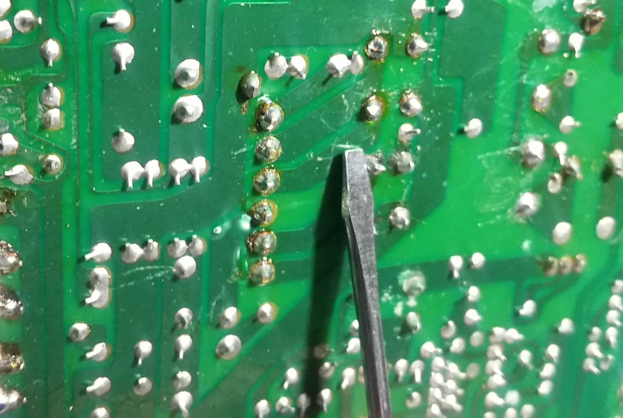

I tried testing speaker selector connection. Looks like relay works. When receiver is off there are no connections between pins. No beep sound from multimeter.
So relay looks like this. I did connection test using multimeter connection test "beep" option.
Last 2 vertical dots is DC feed To actuate.
First 2 vertical dots are speakers B I guess. These two are connected when b or a+b are selected.
The middle vertical pair is speaker A I think. It's always on. As soon as u hit power relay connects speakers A. And when u turn off the amp connection is still there for 2-3 seconds or till capacitors discharge.
Speakers b pins actually wait till relay in power supply section clicks.. and then u get a connection between speaker B pins.
Just quick picks of speaker relay with screw driver showing the pins.

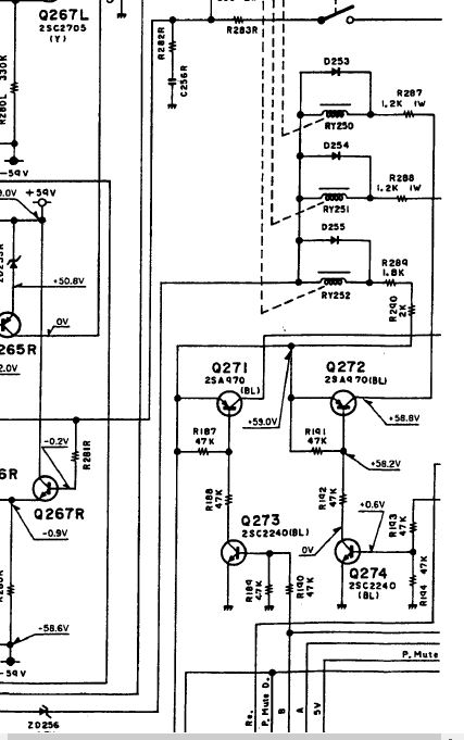

Ok found q274
When speaker a+b collector /base voltage is .52v. Emitter/base is .072v
Speaker B.
Collector base voltage is 9v
Emitter base is 55v
Speaker A
Collector base is .52v
Emitter base is .072v
Speakers off
Collector base is 9v
Emitter base 55v
Speakers remote
Collector base 12v
Emitter base is 55v

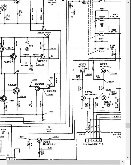

I was thinking That maybe it's good to follow signal patg.. right after power button press. Maybe something in power supply board.

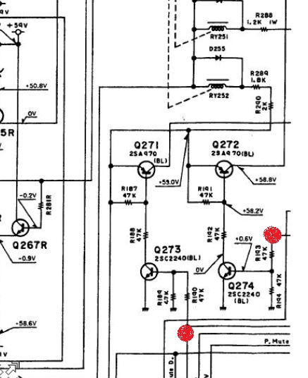

The emitter of Q274 should be ground.
Where does the 55 volts come from ? You cannot get more than around 0.8 volts ACROSS a forward biased base/emitter junction.
Its easy 🙂 look at Q272 and Q274 as an example. Do you see the two 47k resistors at the right of Q274. When the relay is supposed to be OFF then there will be zero volts on that upper 47k (R193 I think it is). The collector of Q274 will be high at nearly 60 volts. Q272 will be OFF and the relay not activated.
When the voltage on the top end of R193 goes high (probably 5 volts) then the base of Q274 will show around 0.6 volts. Q274 will now be ON and the collector voltage will be near zero. That will turn ON Q272 and the relay will operate. Under those conditions there should be around 0.6 volts ACROSS R191 (the 47k across B and E of Q272)
The other relay driver works exactly the same.
Bottom line is that when the two points marked in red are high (5V) the appropriate relay should be ON. When they are low (0V) the relay should be off.

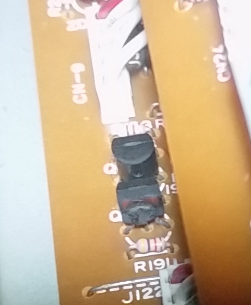

They don't look cracked.

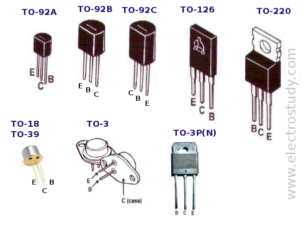

And one more thing.. I used emitter collector base scheme as shown on transistor 2nd from the left ..maybe q272, q274 are different. Basically collector is the terminal closest to the edge of the board. Base is the middle and emitter is farther from the edge

****.. just looked at q272..it blew. Half of it blew off.
It's the one I shorted by accident so all those measurements. Are sort of useless. Need to replace Q272 and Q274 I guess
