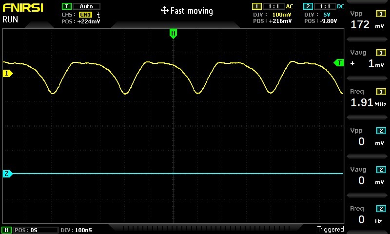

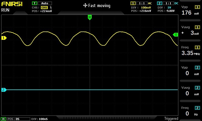

Hi, I bought an oscilloscope :) And I saw an oscillation at 3.3 mhz on output. It looks like come from power supply (not all sure). Did you see that kind oscillation (some kind of dumped sin wave)?
3.3 MHz is way above power diode switching and audio frequencies so unless there are also lower frequency, sub-harmonics of 3.3Mhz present, it's likely from another source - perhaps it's source is RF that is radiated by the oscilloscope's PSU. Check all possible sources in the vicinity of your test equipment by turning each of them completely off at their power source or perhaps just use a different PSU for each, if they are powered externally. Of course, you would also need another, different type of oscilloscope to isolate and test yours.

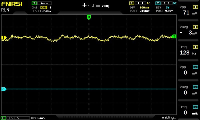

Do you have a screen shot of the oscillation? And can you please explain how you checked for the oscillation with the scope? I can verify with my version and inform you if I have the same result!
here an exemple of the problem, i connect my laboratory , oscilloscope and GBF on the same Wall PSU socket and i test simply test with GBF it appear easily in 1000 Hz sinusoïdal 100mv signal.
I quite agree with Ian Finch, I have to do tests like this because depending on when the problem is present or not when I tested my old amp the first time the problem was totally absent. I'll see if I find the configuration that causes the problem to appear then I'll test another amp in the same way to see if by chance it doesn't appear too, but you'll have to take an amp with a ground because the last time the one I I took did not have any and it can very circulate parasites in the ground of the electrical installation.
I would not have time to do tests before Tuesday, we receive the family. So I'll let you know, i have to be careful about cell phone too maybe, cell phones can radiating and disturb.
Here, 1 and 3 HF oscillation for 1 channal of my amplifier. 2, other channal from the same power supply. I put two 100nf caps on the amp. board, all goes bad :)

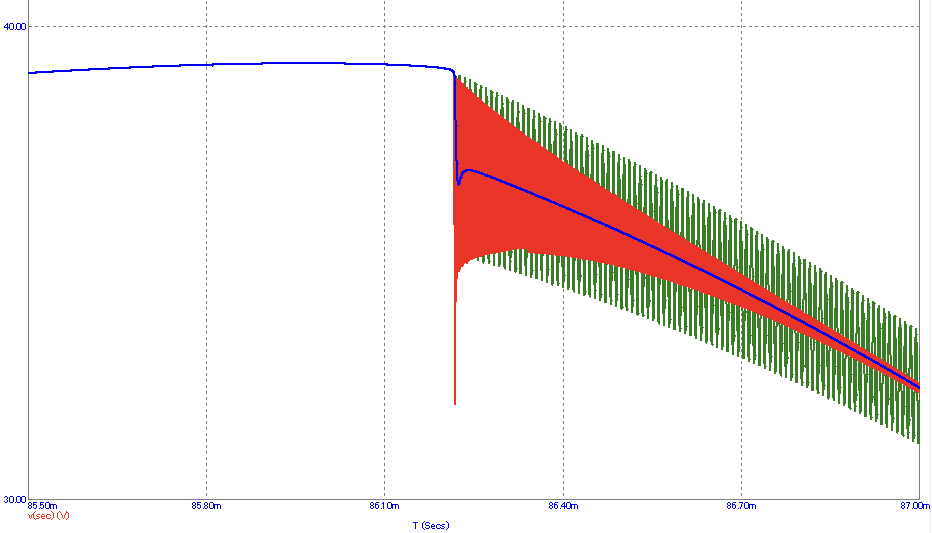

There is a post https://electronics.stackexchange.com/questions/323507/bridge-rectifier-4-diodes-vs-single-chip. here it's written some 1mhz oscillation and solution
"Red trace is without caps and without snubber. It rings at 1MHz. Adding 10nF cap across the diode lowers ringing frequency to 100kHz (green) which is no longer a problem, it also smoothes the edges, so the EMI problem is gone. Blue is with snubber added (R3/C3)." from that post.
