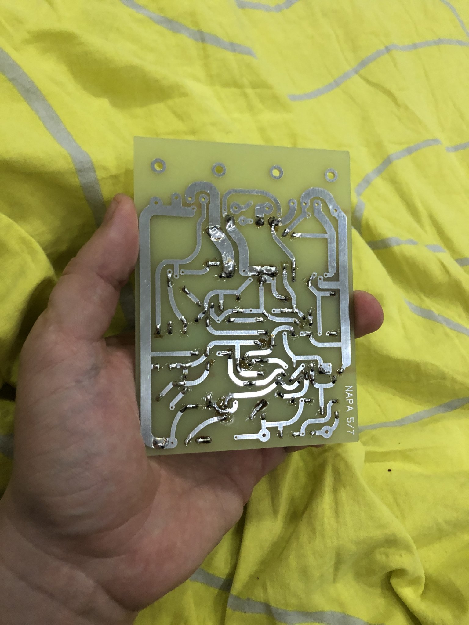

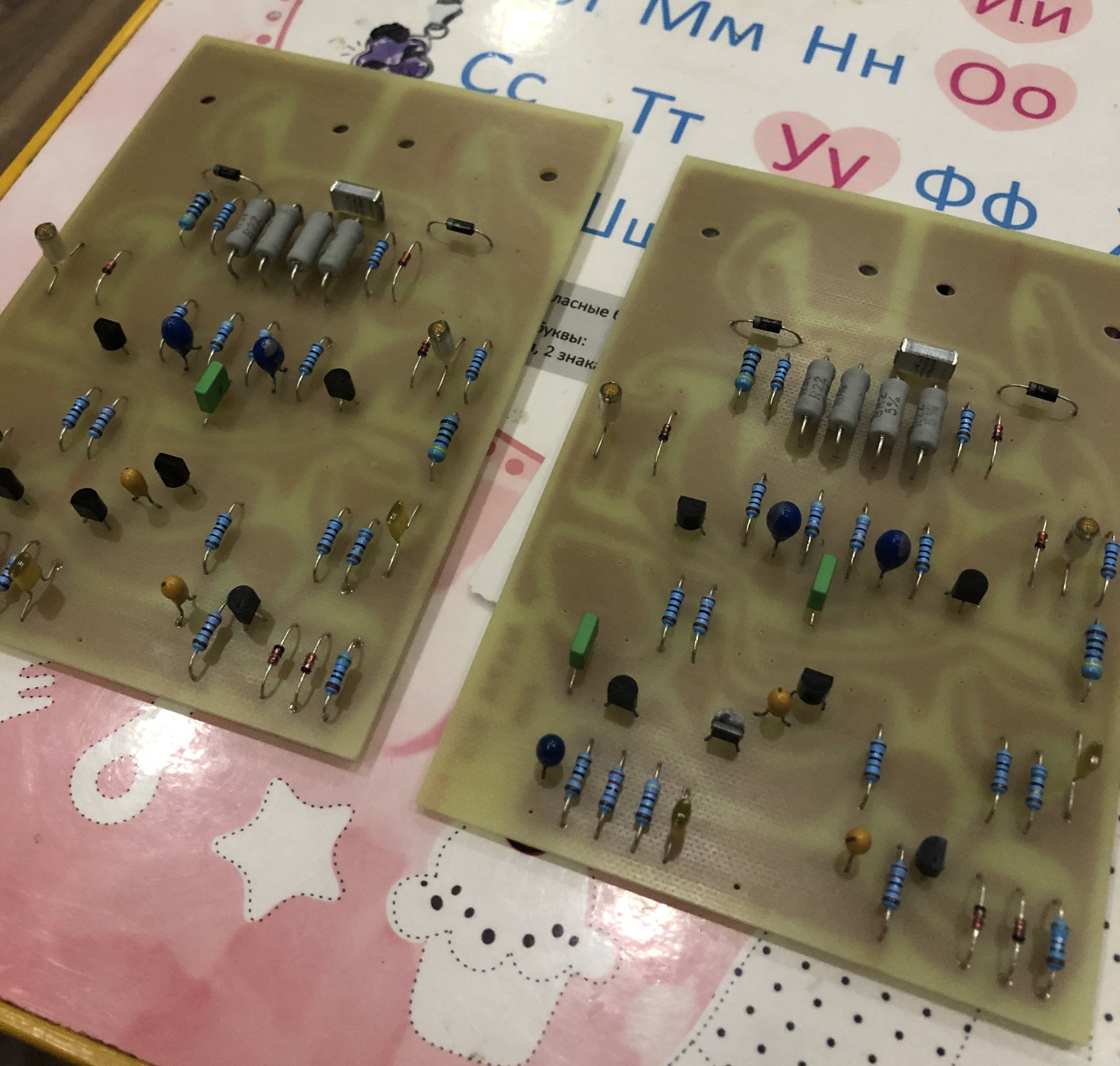

Old boards of NAP110/250 CB diy
this video need watching with switch on CC English translator. Sorry
Step by step
Selected of the every part nominals and soldering to board.
Hand made DIY old NAPs
Second stage searching and buy the BDY56 or NA002 transistors
P.s if your Naim NAP board is burn
You Have more chances to recover it with new board
- NAIM Audio NAP 110 restoration
