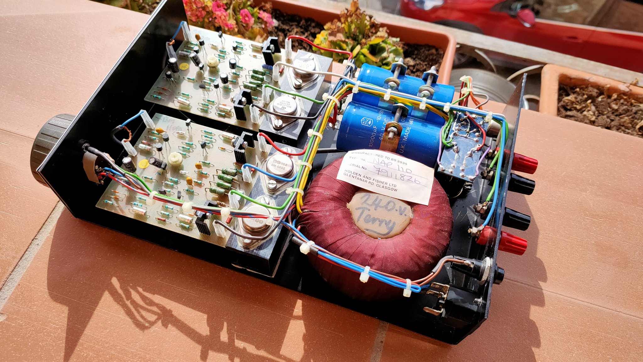

A few months ago I took possession of a Naim nap 110 which has undergone maintenance over the years.
The photo shows its interior with tabs.
One channel has original transistors, while the other has 2N-3055s which are similar to the MJ15003s (RECOMMENDED) but not the same. I would like to replace them with two MJ15003s to start with.
The capacitors that were originally all tantalum are now electrolytic in many parts. I would like to put them back in their place.
How about?
Do you know the exact values of tantalum capacitors?
Other advice will be appreciated.
I would like to clarify that currently the final also plays discreetly and on for hours.
Only the idea of bringing it back to a more original standard
makes me calmer.
Greetings

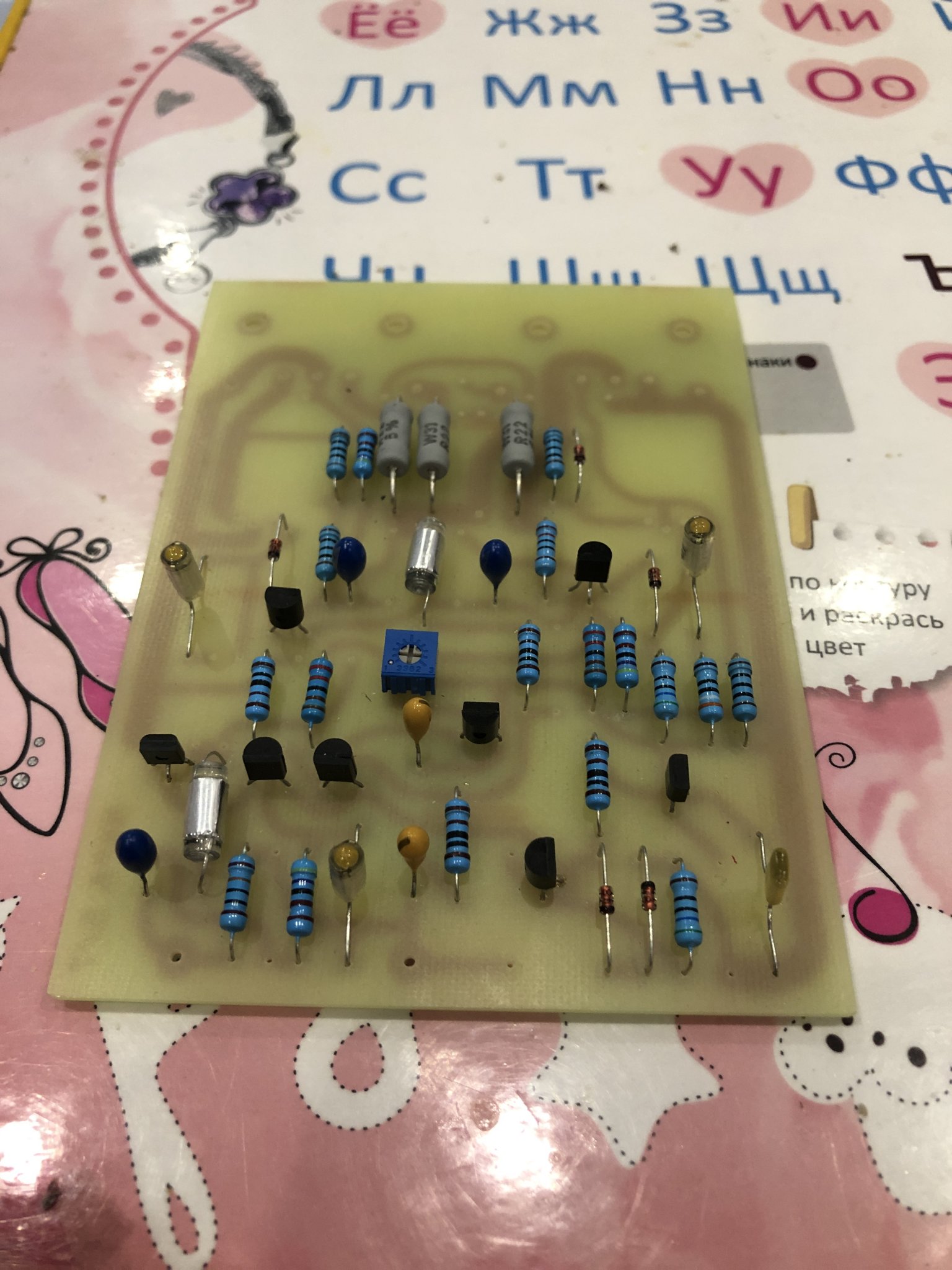

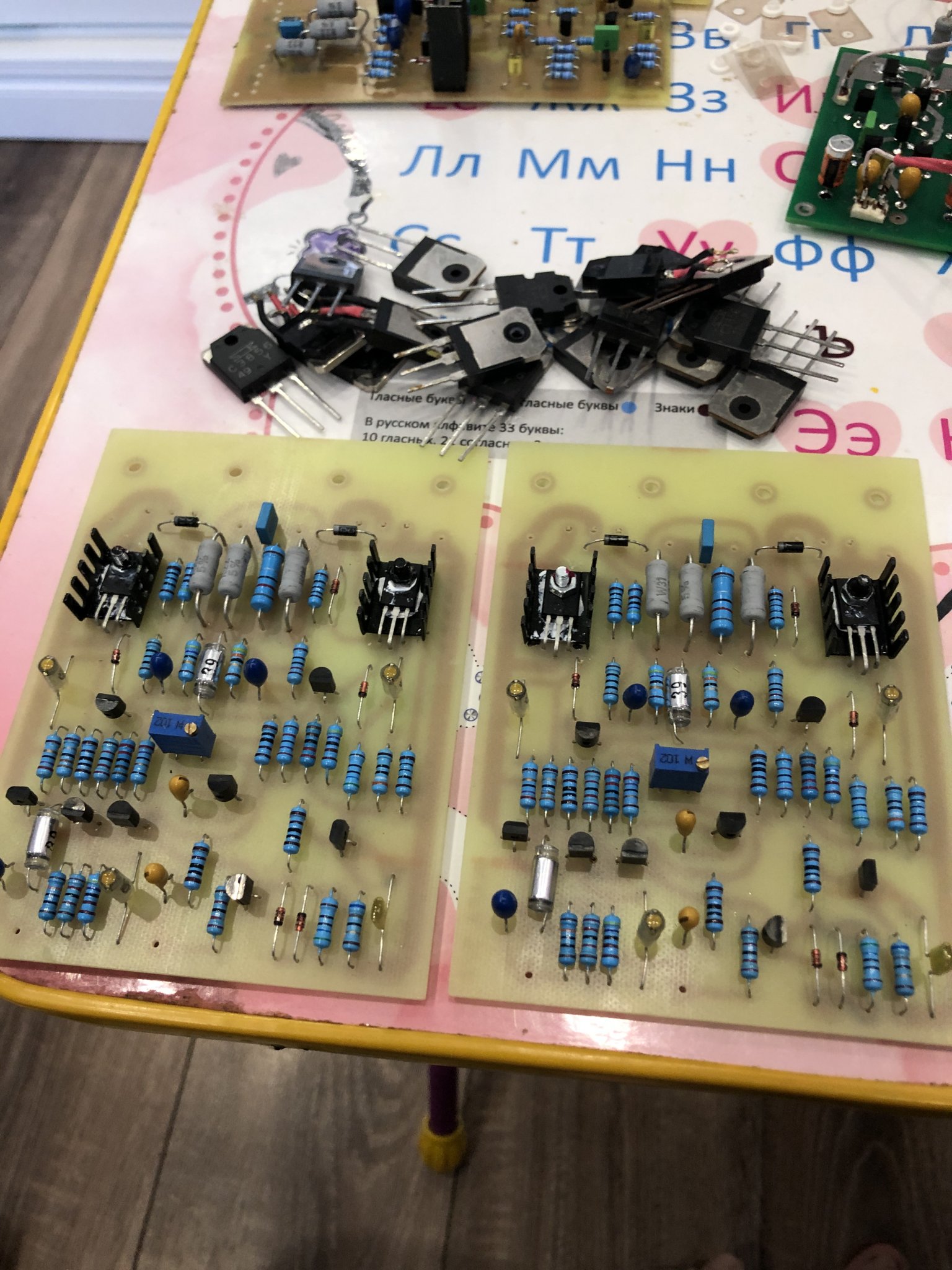

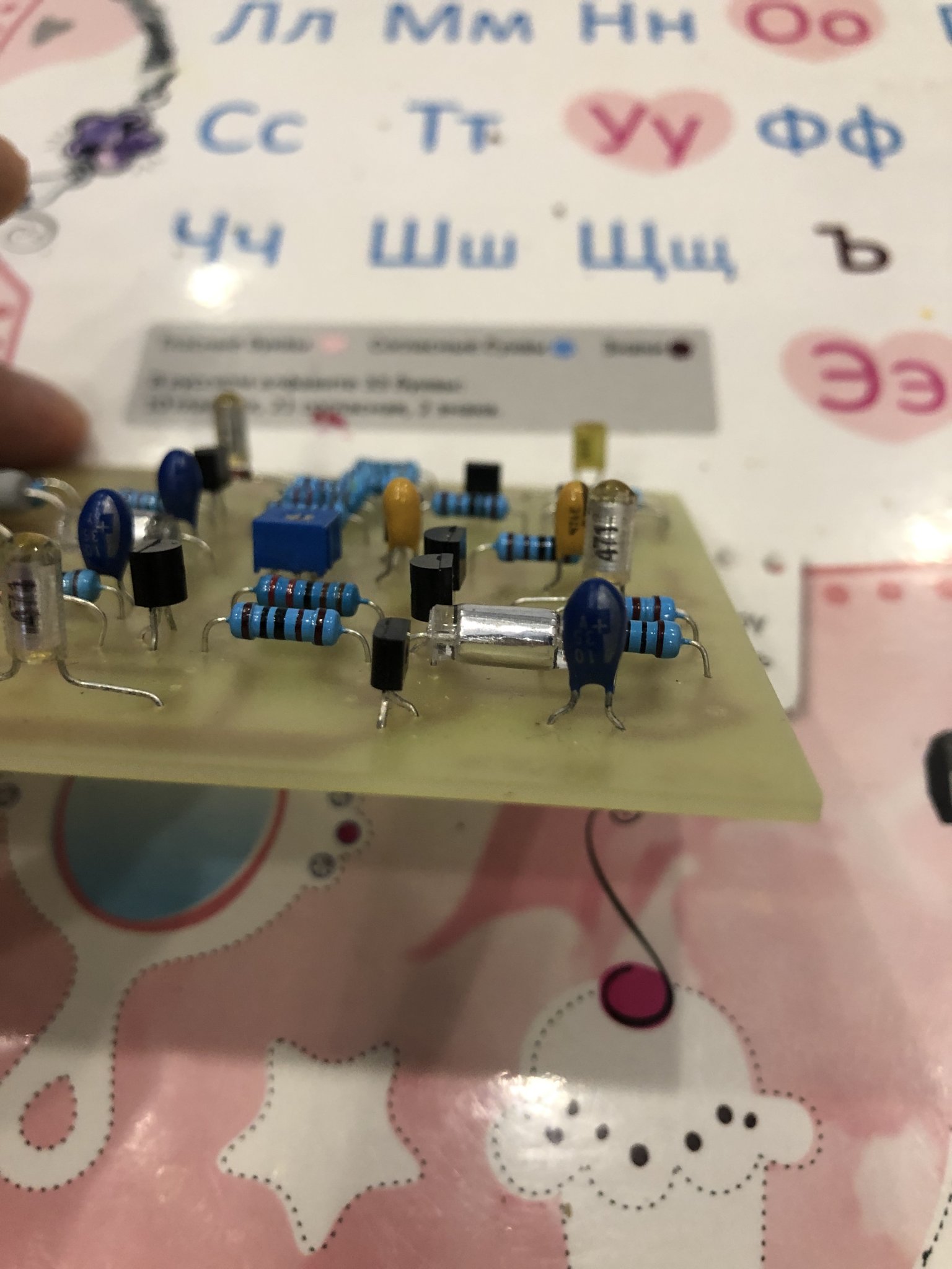

Please make photo of each boards and attach
also you can not find original old tantalum caps because they is not production.
in attachment photos original old blue and yellow caps
Now time In services centres for repair or recapping use is Kemet tantalum caps. input stage 10uf 35v. Feedback stage 47uf 16v. Voltage amp stage 47uf 16v. Current limiter stage 10uf 35v

Originally the tantalums were made by Roederstein. In my day they were often replaced with Philips solid aluminium (type 156?).

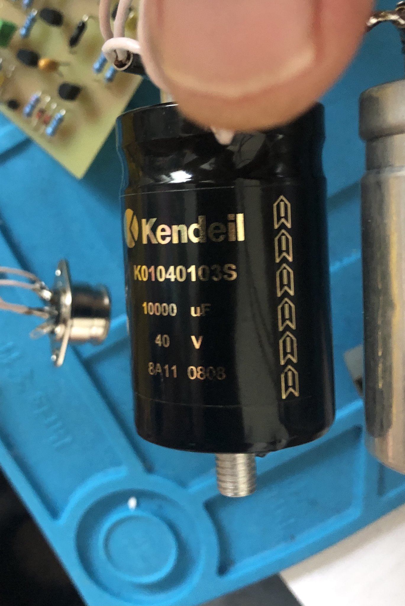

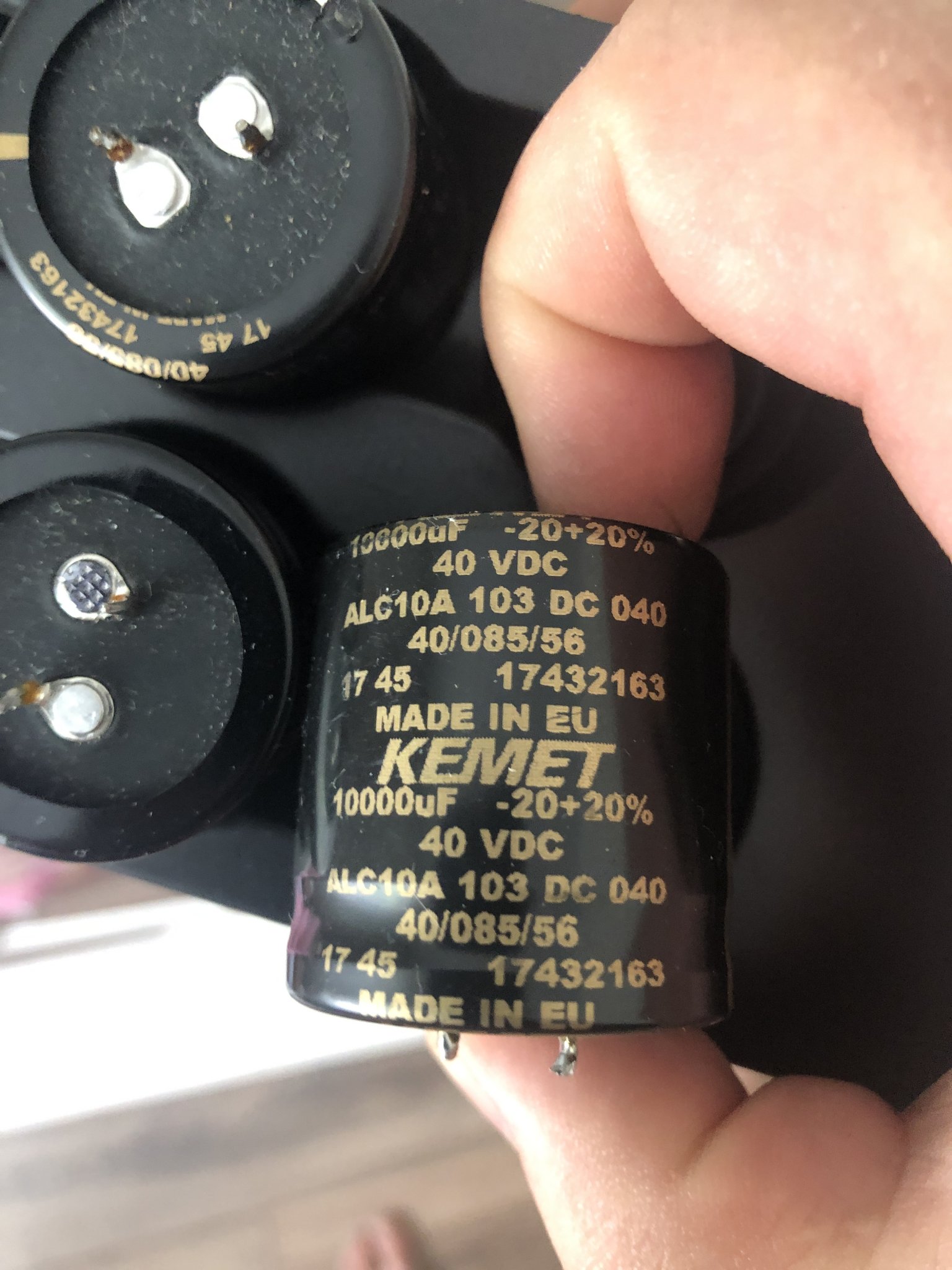

The power supply caps degrade over time. You might want to replace those 10000uF 40V with high quality ones, like Mundorf. Note that the new ones will be smaller so you’ll need to change the mounting clips.
Good day I try Mundorf and this is not Naim sound for repair caps need Kendeil 10000uf 40v or Kemet ALC 10000uf 40v but Kendeil better for true naim sound

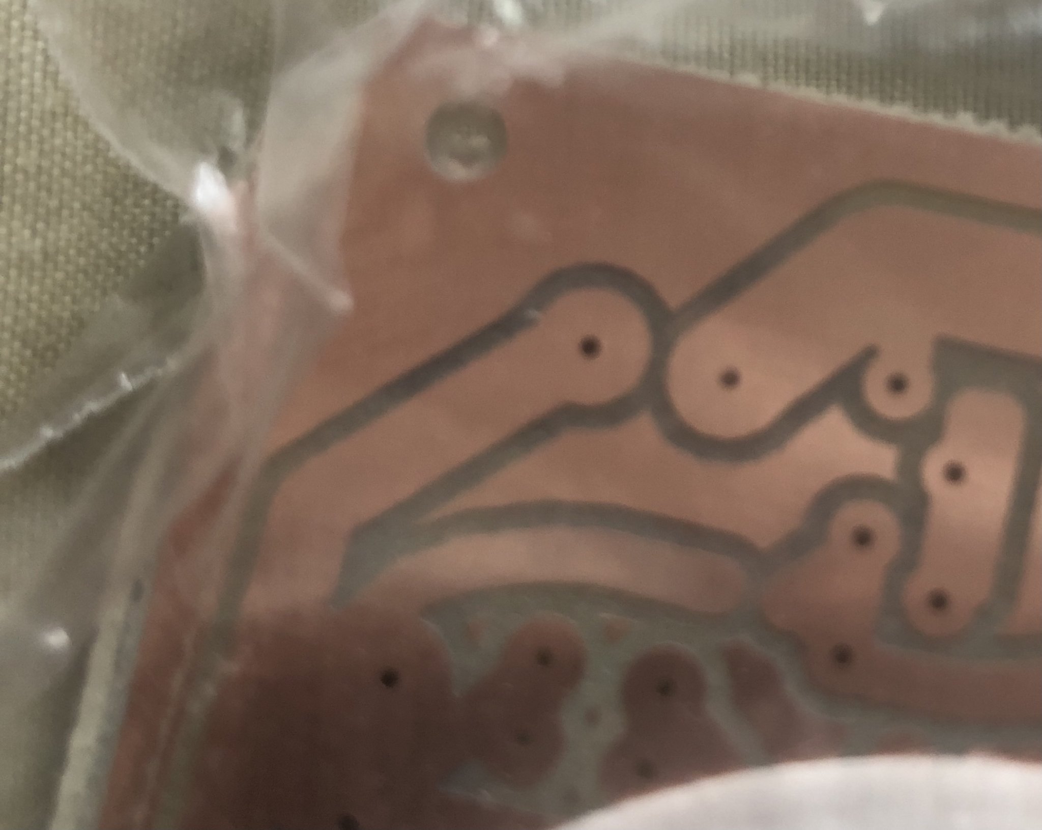

@ Oleg: i really like your pcbs
100% home made ? 70uM engraving ?
Good day Huggy
this is PCB made in factory. Need wait about 25 days for made and shipping to me. Cost for this design same with cost for two layers and all masks and silk screen and all metal holes :))
but some time (if I need small boards) I ask my friend Valeriy to make board on CNC engraving :)) (photo in attachment) this way is very fast but need more time for soldering and remove not used CU areas after CNC drill working :))
Also if you get CNC boards you have chance to use different solder
