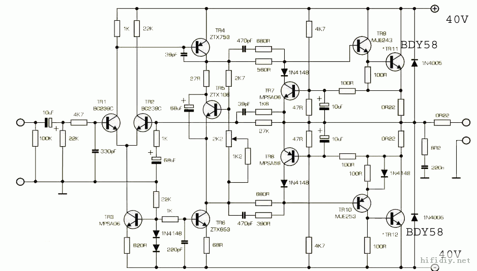

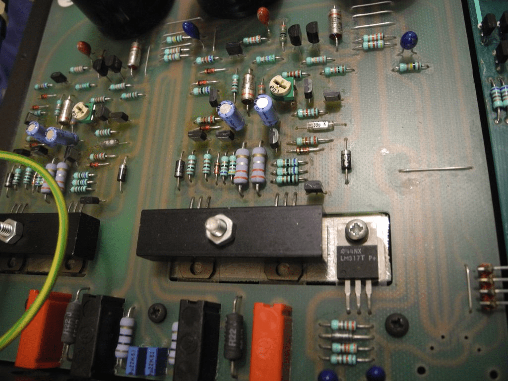

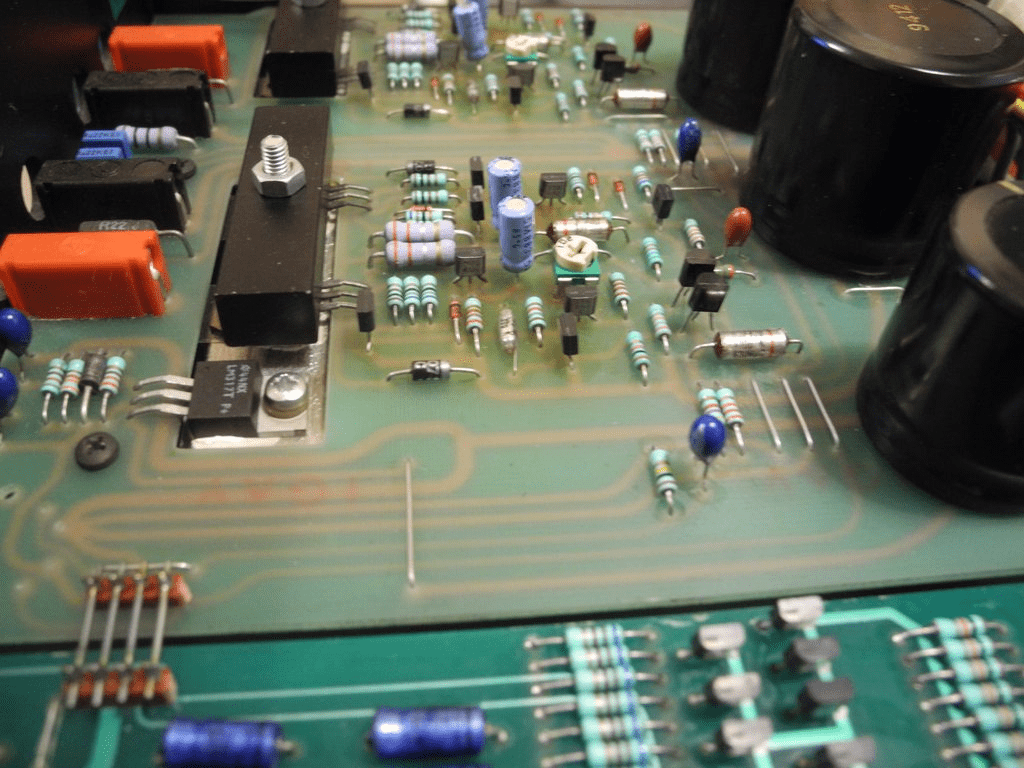

The first image above shows the same NAP250 (amplifier only) schematic you find all over the web, adopted by many clone kitsellers and also the basis of Avondale Audio versions like NCC200. NAP 110 is the precursor to NAP140. It's topology is quite similar but it has a much smaller, unregulated power supply with about +/- 30VDC rails. Also the bias and operating points of the input, VAS stages and a few other important features that affect sound quality are different. You won't find NAP110's real schematic on the net but you should be able to find the real NAP140 schematic which is similar, as are the products. I have seen it several times but lost it again when I updated my PC. Here's some general info. on early models plus some outdated DIY suggestions, so check it out with that in mind: http://www.acoustica.org.uk/t/naim/power_amps.html
BTW, you can casually say Naim's early models all follow the same circuit but actually they don't sound the same due to different operating points and component types. Cheap clone kits seldom sound anything like original models, simply because theyre' a soup of cheapest components that approximate the one NAP250 power board design (without regulation). They just ain't the same designs as advertised, nor do they get the same PSU or components. Together, these faults all detract from the original, desirable sound quality that I can only assume you were hoping to hear.

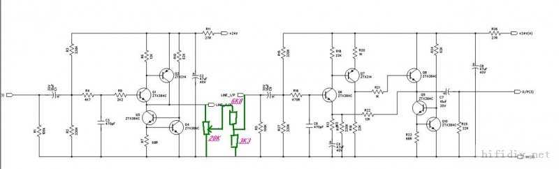

Nap90 and NAP110 is different schematicsI just got a Nait3 which has the Nap90 as its base amp which is quite close to the Nap110, I can give details if needed.
Nap90 it’s Nait3 power amp schematic
NAP110 it’s nap160 power amp schematic

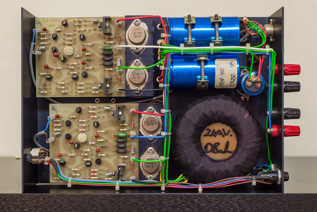

First attachment nap90
Second attachment NAP110
So if you check NAP110 photos you find all resistors nominals
110 and 140 is same schematic but different power supply rails also different output stage transistors and few RC circuits.The first image above shows the same NAP250 (amplifier only) schematic you find all over the web, adopted by many clone kitsellers and also the basis of Avondale Audio versions like NCC200. NAP 110 is the precursor to NAP140. It's topology is quite similar but it has a much smaller, unregulated power supply with about +/- 30VDC rails. Also the bias and operating points of the input, VAS stages and a few other important features that affect sound quality are different. You won't find NAP110's real schematic on the net but you should be able to find the real NAP140 schematic which is similar, as are the products. I have seen it several times but lost it again when I updated my PC. Here's some general info. on early models plus some outdated DIY suggestions, so check it out with that in mind: http://www.acoustica.org.uk/t/naim/power_amps.html

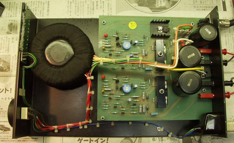

My former system 110+42 in attachment

Good day I not have nap90 but I have internal photos from internetwould you be able to make me a framed close-up photo with good lighting of the Nap90 please?
It's for my database.
Amp boards Nait3 and nap90 little different but schematic is same

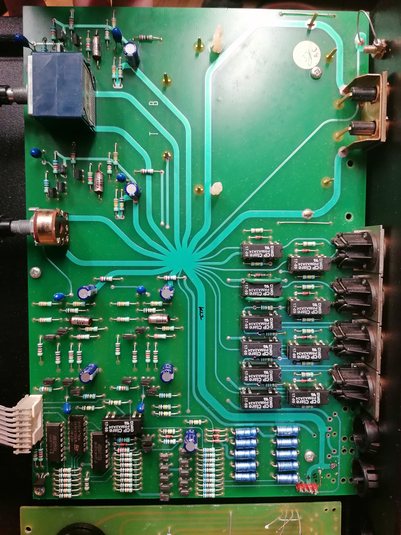

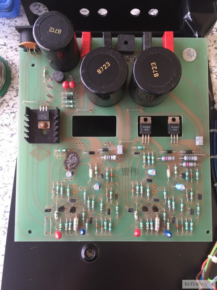

I have a doubt about the origin of this pcb, the color is strange, the resistors are disturbed, it looks "messy"
Please make photo of your Nait3 boardsame state of my Nait3
Great pics but ....Oh dear, it looks like a DIY with a blowtorch got to it first. Is either channel working now? It must have had the usual driver failure followed by a VAS transistor, like so many NAP90 before. It also seems the substitute/replacement power transistors were/are still a problem. I can only guess this amp was overdriven into low impedance speakers and then...who knows? Fire and smoke!

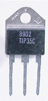

Can TIP35C/TIP36C be squeezed in?
https://www.jaycar.com.au/tip35c-np...os=2&queryId=8c02d8dfc1a504e32583789d8b21746f
https://www.jaycar.com.au/tip36c-pnp-transistor/p/ZT2294
TIP 35/36 are really the wrong type of power transistor for class AB audio amplifiers. However, a similar size package (TO247) version of Onsemi's audio transistors, such as NJW3281, might be workable and sound fine but the PCB would need surgery for either TO247, older TO218 or even the older TOP3 package you show above.
