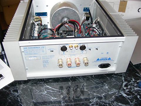

Kind of late reply, but anyway.
NAD S200 is a factory tweaked/modified NAD 218 THX.
They share the same schematics.:bigeyes:
The biggest difference between these two amps is the chassis with terminals.
Other changes are better PCB (two sided, same layout, but the wire straps are replaced with pcb tracks), Metalfilm resistors instead of the ordinary and some better capacitors here and there.

I had a few looks under the hood of the 218 and the S200. They do look strikingly similar at a glance. Pretty amp though (the S200).

218 THX vs. S200 Nad Silverline.
