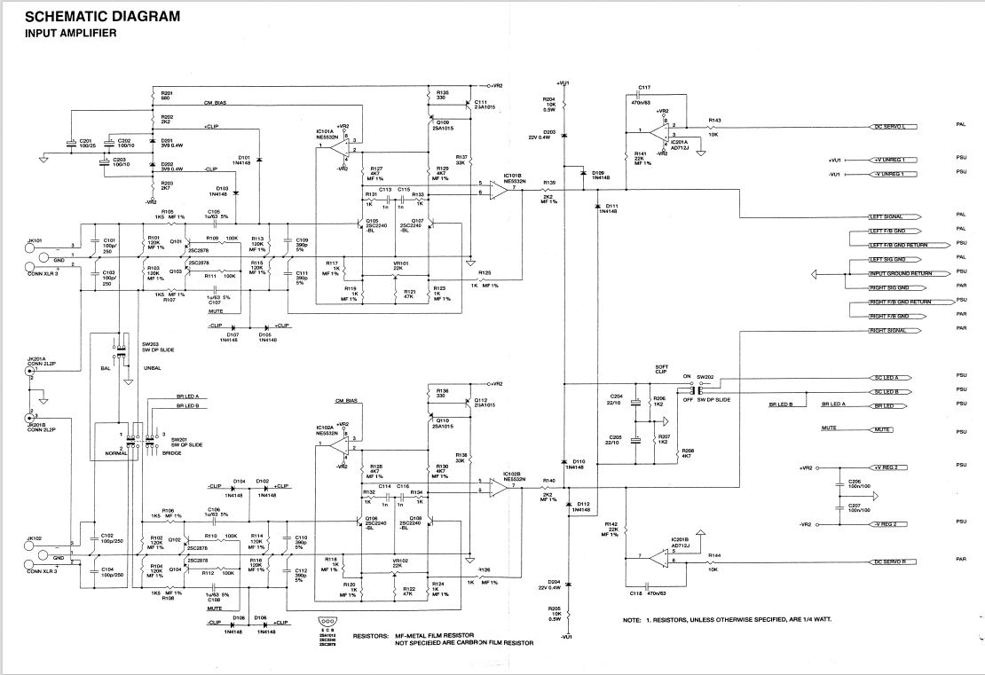

tonyliuxd said:You may change 4 red wima 1uF caps in input stage, and you will hear the difference🙂 🙂 🙂 .
I want to hear the difference!!!!
Which 4 red caps are you tolking about and what are specs of new caps you recomend?

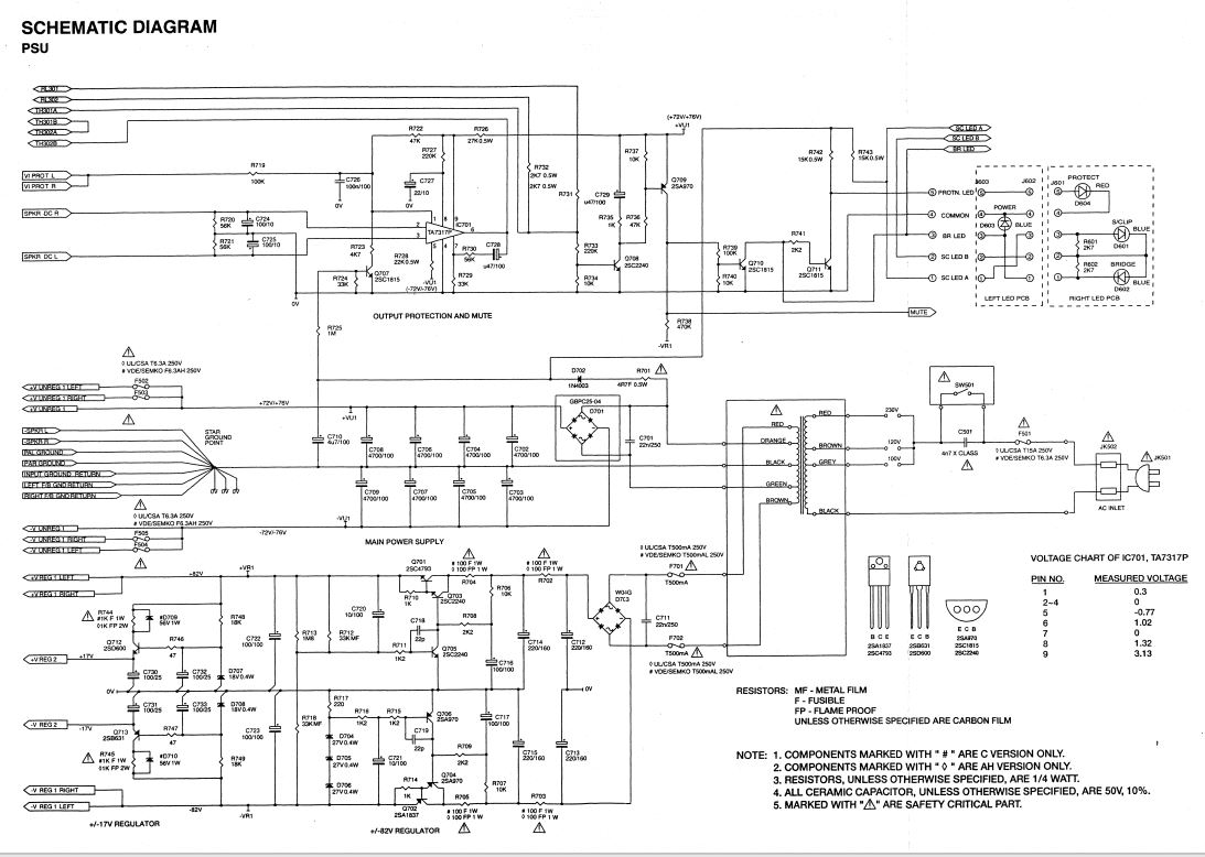

I'll take the benefit of this thread to describe the work I recently did on an S-300 (the one based on Gryphon Tabu Century):
1. replace main caps with Panasonic TS-HA caps, which are specified for 105 degrees.
2. reduce the bias of the preamp transistors (the ZTX ones) - this has great effect on the heat inside the amp.
3. remove the soft clipping circuit (also called SOA protection circuit).
All of these (mainly the SOA circuit), contribute to a more 3 dimensional sound, with less veil and grain - highly recommended

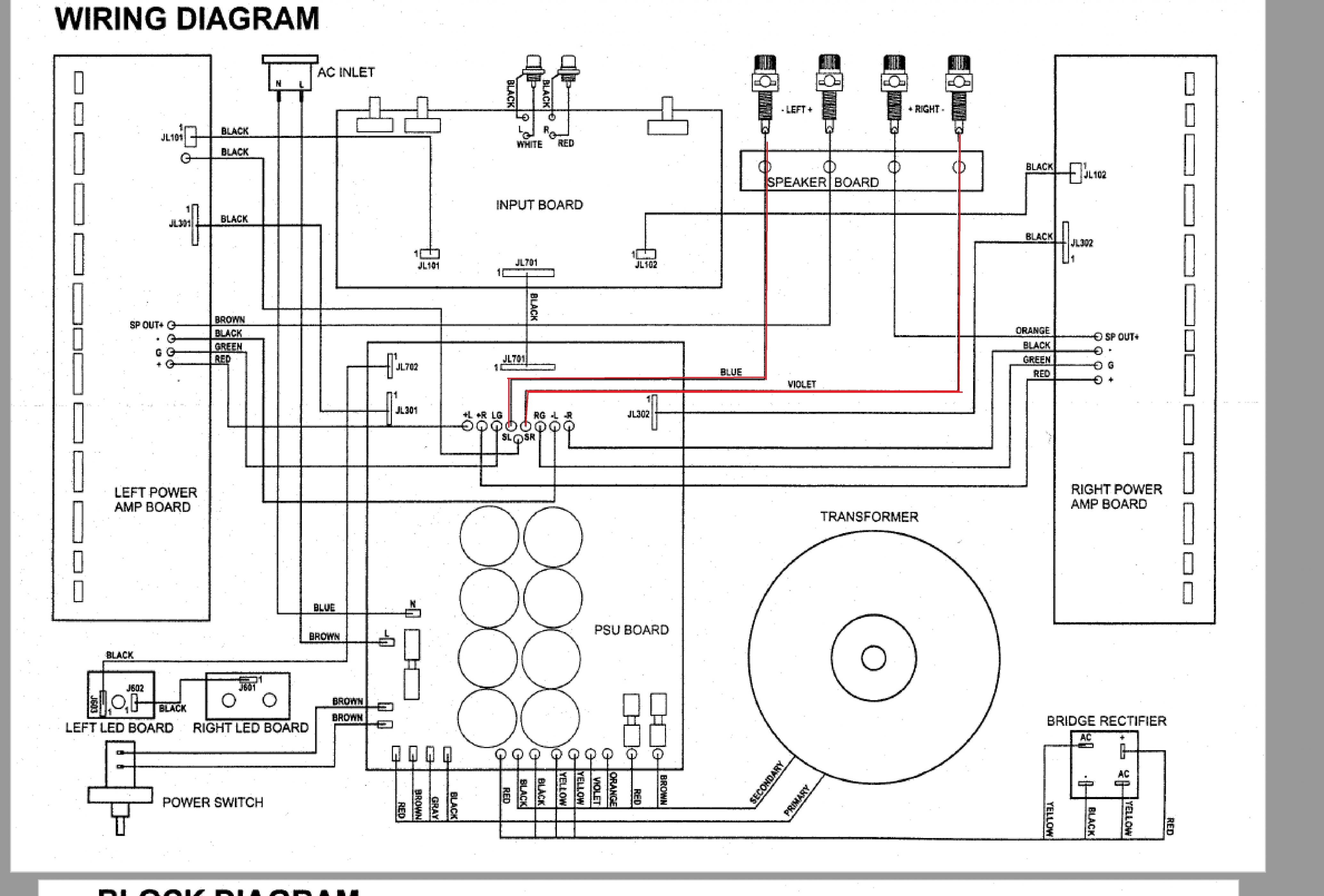

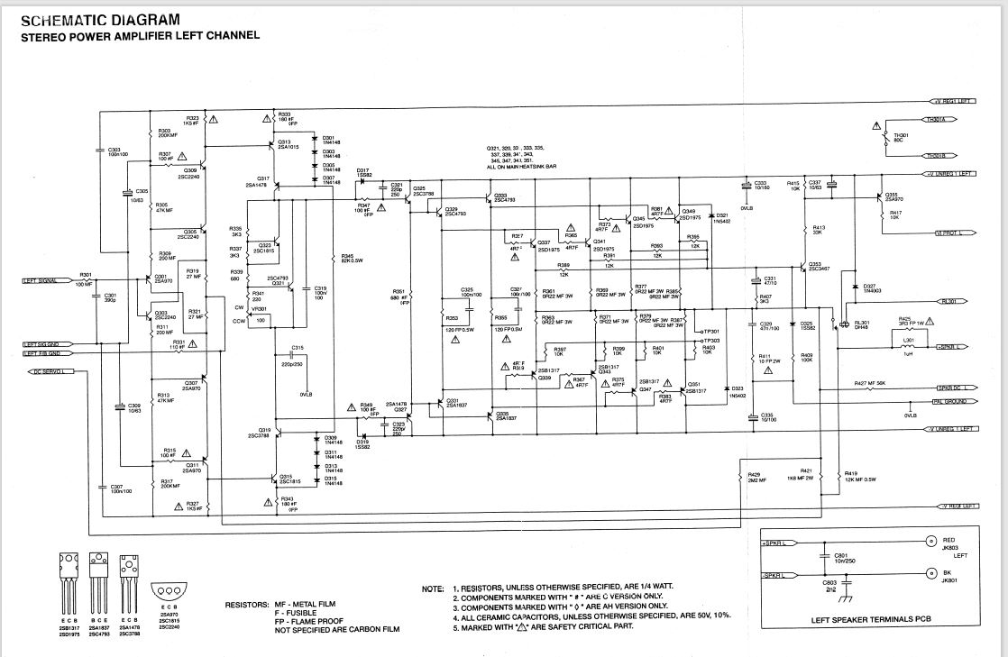

There are errors in the layout of the ground loops. I'll show you one in the picture. I will keep the rest of the mistakes a secret. Whoever needs them will find it himself, the path is indicated. Overall, after inspecting the circuit, it is clear that this amplifier could potentially sound much better. The circuit itself is very good. But, apparently, there are minor flaws. NAD 218 THX has the same errors. Perhaps this simplification is due to the possibility of balanced switching in these amplifiers. But I'm sure they just didn't give it the proper importance for an amplifier of this class. Like, and so it will come down for the money.
This is where the real oxymoron is in a beautiful wrapper ... technical mistake after mistake, and in its roughest form ... Where is this amplifier assembled? In Denmark? Is this a Gryphon factory?The more transparent an amp gets, the clearer the difference between cables gets, both signal and power.
And "good Soviet high end amp" sounds like a bit of an oxymoron to me. Even if the topology has been ok, the quality of the passive parts would have been very dubious, especially of electrolytic caps. Termination too.
Electromechanical loudspeaker protection relays
manufactured by FUJITSU Electric Co. Ltd. with a rated coil voltage of 48 V and a rated switching current of 16 A / 250 V. At least for starters, they should have learned from the masters of the old Japanese school ...
Moreover, I found that even the values of the resistors in the circuit are erroneously swapped, at least in the NAD 218 THX they are set correctly.
At the expense of the invented conclusions about the special clarity and transparency in the amplifier, made with gross errors, it is ridiculous to read.

There are errors in the layout of the ground loops. I'll show you one in the picture...
Hi Sasha,
I am sending greetings from Czechia. I have recently come across your post related to errors in the layout of NAD S200' ground loops.
Would you be so generous and share your thoughts on ground looops' improvement please?
Thanks a lot in advance.
Pavel
