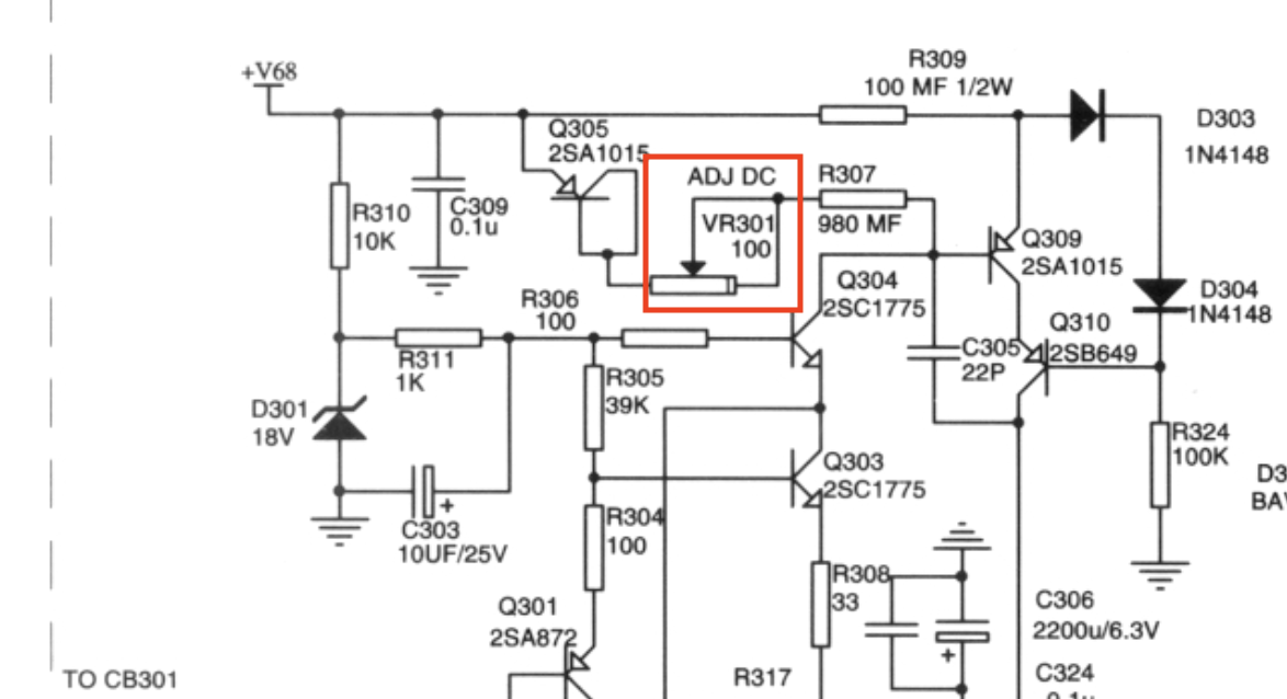

Having offset problems...
Status: all rails are good, amp turns on as expected, bias is adjustable.
The offset pots are having no effect (both channels). I've measured them and they change resistance as expected. I've measured the resistors close to them and they're all within spec. Any idea what's going on? What I can check? Is there something easy I can look for before pulling transistors off the boards? Thanks!
The circuit around them:
Just being certain: no speakers connected and amp is on for at least 10 minutes, all controls flat, no input source.
Check:
- Q308 + Q312 (shorts, opens)?
- Zeners D301 + D302 (are these holding at 18V reference)
- 1N4148 (D303, D304, D305, D306) shorts?
- Q305 (short, open)
Just some quickies than can be checked.
If one channel is within specification for dc offset then some measurements can be taken for cross reference with the one that is not.
It would be helpful to know the specific voltages of the dc offset whether negative, positive or variable within both ranges.
I suggest measuring the voltages at the bases of Q309 and Q312 in the circuit diagram provided if this is the channel with the discrepancy and compare these with the same parts in the one that is within specification. Hopefully Q312 will match with the partner in the other channel.
Q305 is configured as a base emitter diode and the resistance of VR301 and R307 is 100R+980R which matches R321 in the negative half of the circuit.
Q309 is a PNP type so adjusting at 1k total resistance of the adjustment the base voltage will change the voltage at the base of Q309.
The closer this is to the emitter voltage which is fixed in this instance the less current it will pass.

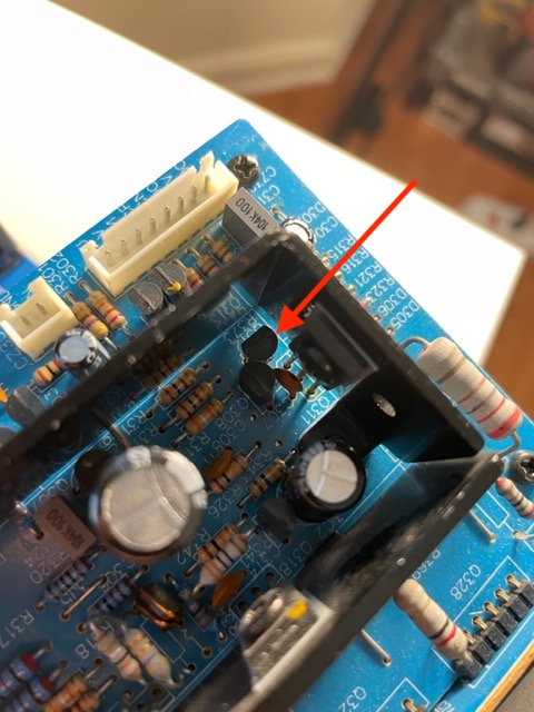

Hmmm the way everything is laid out, I can barely get probes to some components with amp modules on my desk. Some of the transistors are impossible to probe. Basically there's no way I can think of to take measurements with everything installed and plugged in in the chassis. I have one of these el cheapo testers https://smile.amazon.com/dp/B07WT9VVZB?psc=1&ref=ppx_yo2_dt_b_product_details so I'll take the boards off the heatsinks and start pulling components. Thanks guys.

OK, that is an el cheapo meter. 🙂
So you can check without power. Sure resistances may not be accurate, but device shorts will showup (diode mode).
I try and check as much as possible without power applied. Plus it's safer than a probe slipping with power applied.
Also, as one poster states, you have a decent channel to compare to.

You don't need to take a blanket approach with other components like you did with your recap. Faults can be detected by following processes.
Forget for the time being there is no change in dc voltage from moving the trimpot and do the measurements for the few points I suggested. That should should help narrow the focus.

Ok, will do thanks.

If the modules are on your desk where is the connection to earth. You need to have this so capacitors C303 and C304 bypass zener noise due to diodes D301 and D302. If there is zener noise in the input set up it will be amplified.
You have measured 400 m.v. a.c. at the output of the faulty channel. Also if the modules are not inside the case there is no shielding against radiated h.f, noise in the ether or by the power transformer in combination with diodes in the rectifier bridge switching on and off in the process of charging the capacitor bank.
If you put everything back into the chassis and connect the earth system you might find the shielding and effective earthing will make a difference.
