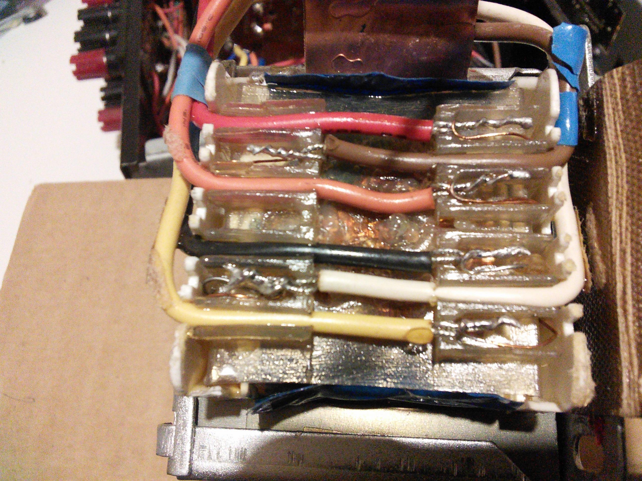

The Primary connections and their associated colours are shown in the attachment to Post #45 by ALAN4411.
We have established that any fault probably lies with the BLACK wire - there is no chance of repairing this Primary as it is usually the first winding on the bobbin.

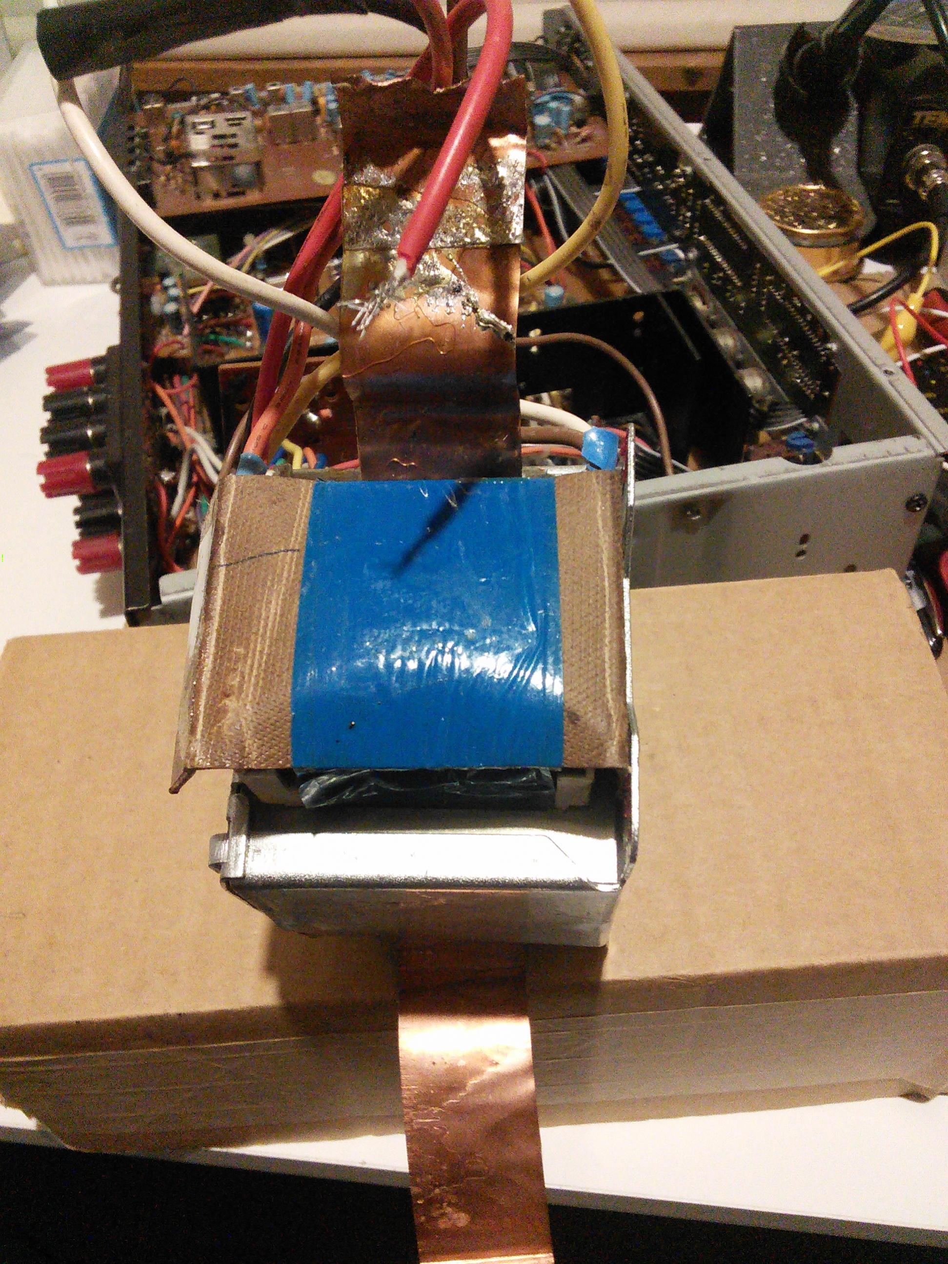

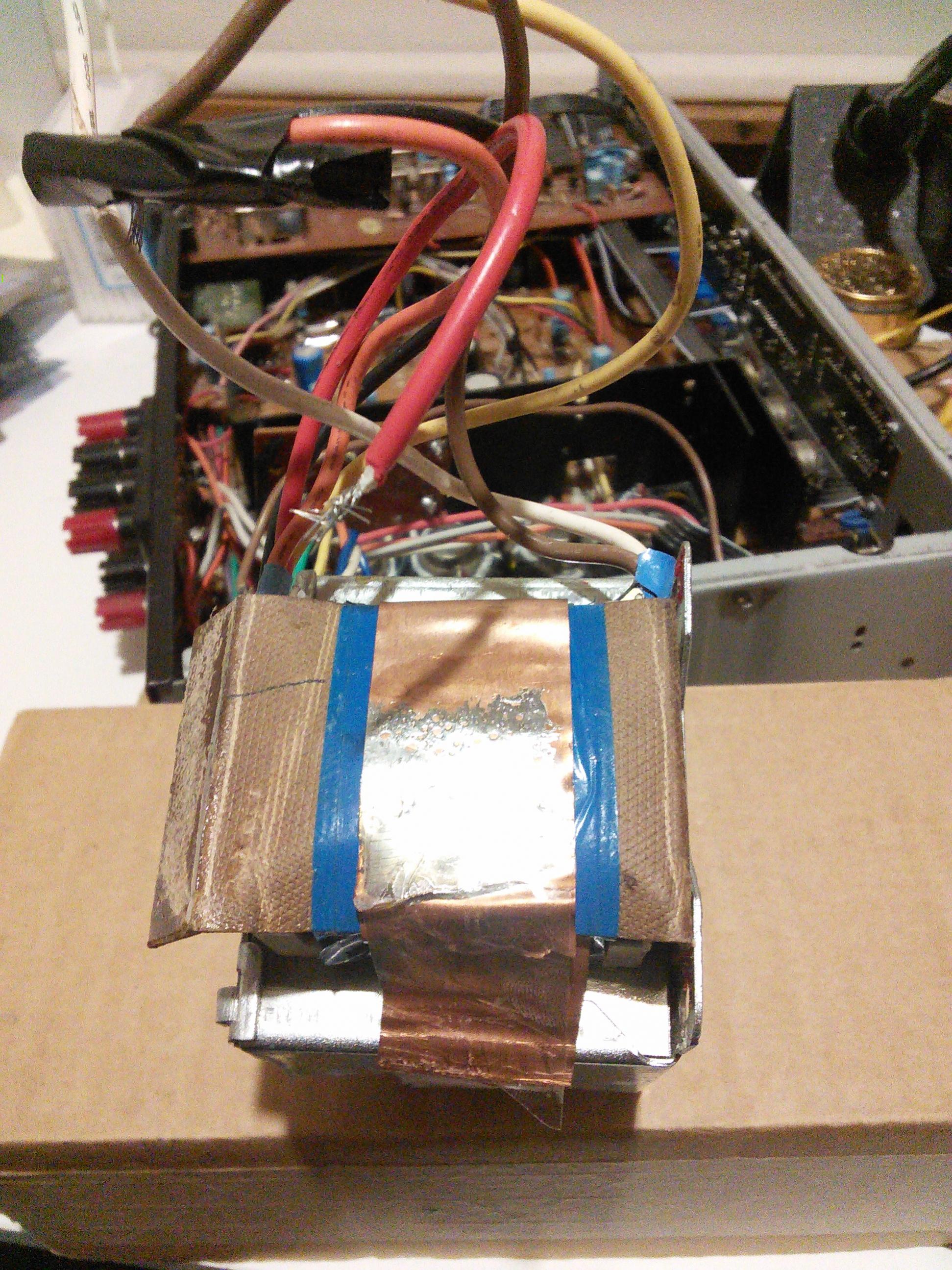

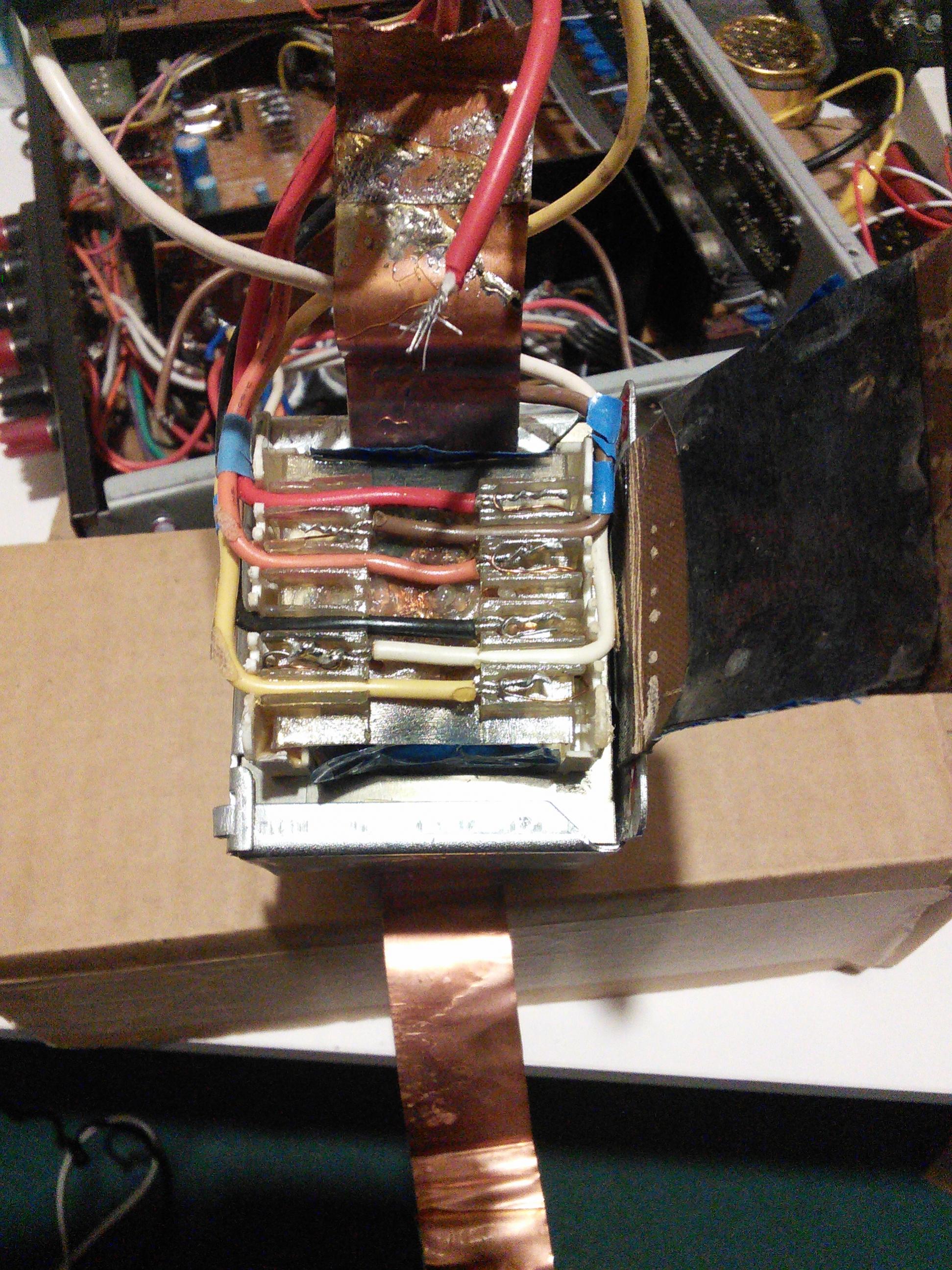

Transformer Disassembly
Various stages of the NAD 7020i transformer disassembly:-
And a close-up view of the Primary connections:-
With the expert help of Forum Member Alan4411 we've deduced that the BLACK wire, the only one with an internal connection problem, must be linked to a thermal cut-off or fuse of some type?
