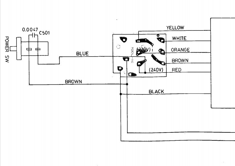

The blue wire at lower right of your board is from AC plug or power switch.
I think the brown wire that goes to lower right also from AC plug or power switch.
Those theories can be tested with the ohmmeter. This test should be done with power switch on. 0 ohms. It is not unheard of for power cord to get broken, they get stepped on & yanked. If infinity, your problem is outside or power switch.
then one AC blade, blue or brown should go to 0 v on the board.
the other AC blade should go to 240 since you live in UK & use 240.
Any of those solder joints on that board can be bad.

BUT you haven't mentioned the impedance of the other 120v winding ?!!!
I measured that previously but I checked again and it's around 10 Ohms.
So what options does that leave us or can we assume it's shorted windings?

I have 240V AC coming into the receiver and the power switch is functioning correctly. This AC input is connected on the small board via the power switch to the RED and BLACK wires that run inside the transformer. As mentioned previously, the metal cover on the transformer has been spot welded making access impossible? You mention a jumper and someone else mentioned a possible thermal fuse but no doubt they are under that metal cover?
I may reflow all those joints on the small board just to rule those out?

Two 120v primary’s, each should have ~8ohm across ‘em at DC
As there’s no standby TX in this product, that ~16ohm should also be present at the mains plug
If you can’t see the 16ohm at the plug, there’s a break somewhere between that and the TX, be it a dodgy cable/connection or fuse that you haven’t spotted yet.
PS: the jumper is just on the square PCB , this just puts both 120v windings in series for 240 operation.
The internal thermal fuse (if indeed there is one) would show up on your two ~8.2ohm checks

You have 245 volts AC at the Red and Black wires entering the transformer?
You measure approximately 10Ω across each section marked 0 - 120 on the brown board (White /Brown and Yellow/Brown wires.)? So with the amp unplugged and if everything was working normally, you should measure approximately 20Ω across the red and black wires, but yours is O/C.
If the answers are yes, you have 240 volts into the transformer and both primary windings are correct, then you have to conclude there is another fuse or lost connection inside the transformer.
Further - Have a look at the service guide. There are 6 wires entering the transformer on the primary side. There are only 5 taps on the windings.
That strongly suggests that either the Live or Neutral entering the transformer (on the Red and Black wires) has a fused connection internally that has failed...

Hi Alan and thanks for your re-cap of this ongoing saga!
Your summary of my measurements and readings is correct I would confirm that there are no other connections, components or circuitry between the AC mains and the BLACK/RED wires going into the transformer apart from the fore-mentioned on/off switch and the small board. So no other fuses that I can see?
To eliminate the mains power lead, the on/off switch and the small board I am considering disconnecting the BLACK and RED wires and connecting them directly to a new power lead - so a direct connection from the AC mains to the transformer.
Is that advisable if implemented with the usual safety precautions or will something go bang?

Before you do that (it won't go bang if you do, but use the lamp limiter) - out with the meter again please.
Unplugged of course, measure the resistance from the Black wire/pad to any of the other pads other than red. If you have continuity then do the same from the Red wire/pad to any of the other pads other than black.
If either is open circuit then there is an internal fuse or break in that lead inside the transformer, so no point trying a direct mains connection.

Thanks Alan - I think we've reached a conclusion?
Measuring the resistance from the Black wire/pad to any of the other pads other than red I'm getting nothing.
Doing the same from the Red wire/pad to any of the other pads other than black I'm getting a low Ohms reading.
Same pattern when checking continuity - nothing for Black wire, continuity for Red wire.

The statement that AC comes in on red & black doesn't make sense to me. Red should go to the transformer. On the picture there are not two wires to the terminals labeled red & nothing (black)
The black wire doesn't have a name in post 31. Is it possible the black is the earth wire, to the case? In that case it should connect to nothing else but the safety ground of your power cord.
Low side of AC cord should to to 0 on little board. Also one wire of transformer. 120 next to it should go through a wire to transformer, also through jumper (soldered to board labeled 220-240) to 0 above. 0 above should go to transformer. 120 above should go to the transformer, also the other side of the AC cord, or the power switch.
If there is low ohms (6 to 10 you say) between 0 and 120 below, and between 0 and 120 above, the transformer is not open.
You haven't said where blue goes. Looks like a power cord. There is a terminal labeled grey, which goes to nothing. Looks like a good place to put the other power cord or AC switch wire, which should then go to 0 or the top 120.

If you look again at the picture in my Post #29 above you should see the AC mains cable coming in at the bottom right area - BLUE and BROWN wires going the two terminals there.
The BLACK wire that runs to the transformer is connected to the AC mains BROWN wire
There are two other BROWN and BLUE wires that run to the on/off switch - they both run off the bottom of the picture. This BLUE wire is connected to the AC mains BLUE wire while the BROWN wire connects to the RED wire that runs to the transformer - this can just be seen at the top right off the picture just behind the YELLOW wire.
Accordingly, the RED and BLACK wires that run to the transformer carry the AC mains at 245V AC.
Hopefully this clarifies matters but it takes us no further forward as the receiver still doesn't work!

Finally - Have you considered there is a fault on the amplifier that has caused this problem?
Thanks Alan for your ongoing support and interest.
You mentioned 'powering the transformer bypassing the 'fused' line and measuring the secondary voltages' - any advice on how I could do that?
And of course at the back of my mind is that there may be a fault with the receiver which has caused this problem - but that's a bit 'chicken and egg'?
The NAD 7020i power page schematic I have, there is no primary fuse or circuit breaker. There are fuses on most secondary windings, but not on +5.6 v & +12 v windings. Thus NAD has set this receiver up to burn transformers fuse if an electrolytic cap in that section or something else shorts in the tuner. Great way to sell transformers, if the company was still operating.Finally - Have you considered there is a fault on the amplifier that has caused this problem?
