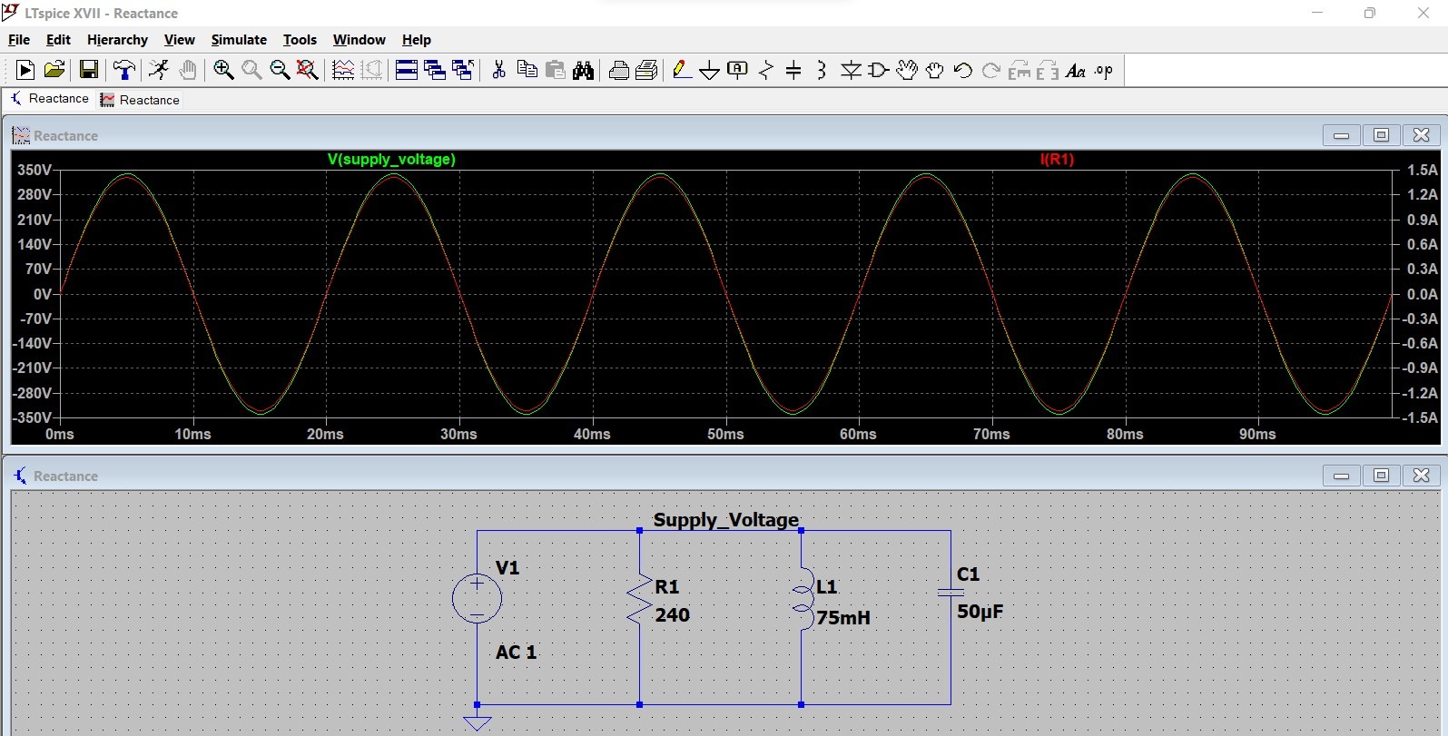

This will get you thinking. Take one of your amps and pull the mains plug out. Now switch it on and measure the DC resistance between live and neutral. Pretty low isn't it. So if I =V/R and the voltage is 230 volts rms then why doesn't a 3 amp fuse blow?

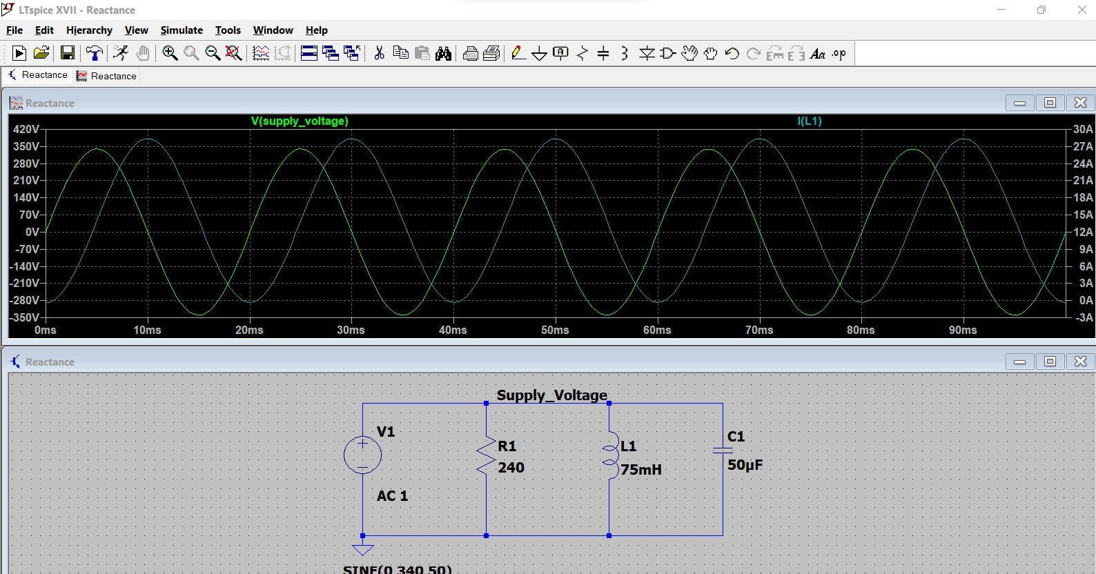

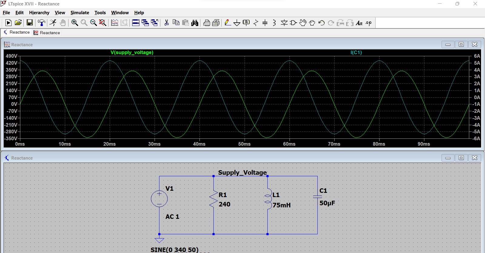

You need to understand that in a resistor the applied voltage across the resistor and the current flowing through the resistor are 'in phase'. As the voltage rises the current rises in proportion.
For an inductor (like a transformer winding) the current lags behind the voltage by 90 degrees. For a capacitor the current leads the voltage by 90 degrees.
This shows mains voltage across a resistor, an inductor and a cap. Look at the timescale. 50Hz takes 20 milliseconds for one cycle. Look how the current lags the voltage by 5 milliseconds (so 90 degrees) for the inductor and how it leads by 90 degrees for the capacitor. For the resistor they are in phase.
