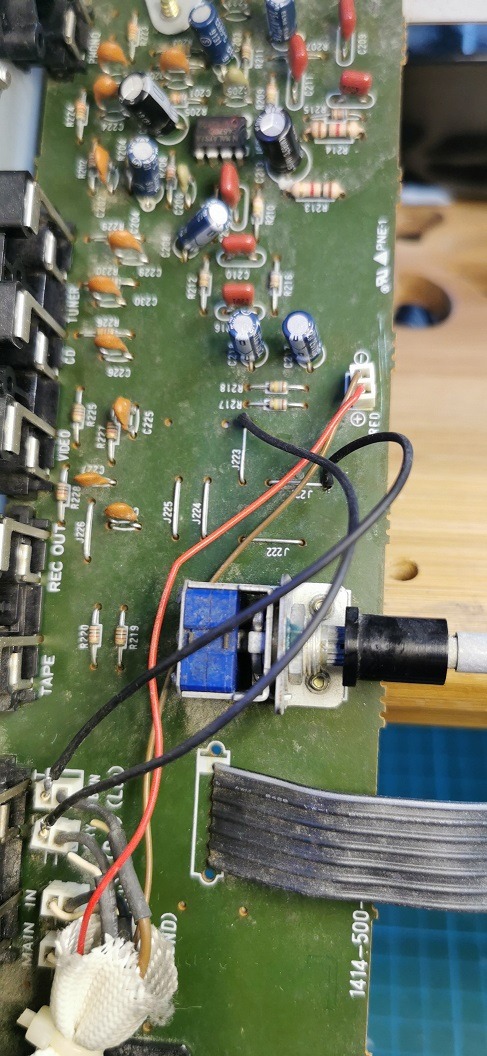

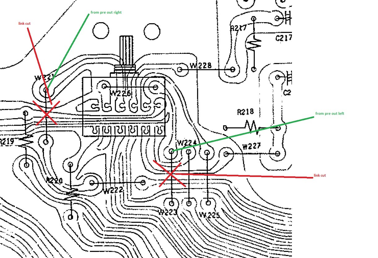

re:#17
It looks like someone had been trying to replace the volume control with perhaps a plain, no loudness tap version but run into difficulties and probably lost interest in the project. That's a polite way of putting it, at least. Never mind that the resale value just plummeted when things no longer worked properly. Their loss - your gain, I guess. Nice, easy repair if the pot is still good for some time to come.
yes it was fine, just a bit crackly, just needed a bit of a clean. There isn't very much you cant stirp down on amps of this age, all the pots and switches come apart ok if you are patient and clean up ok, but spraying with something like servisol though normally does the trick ok.re:#17
