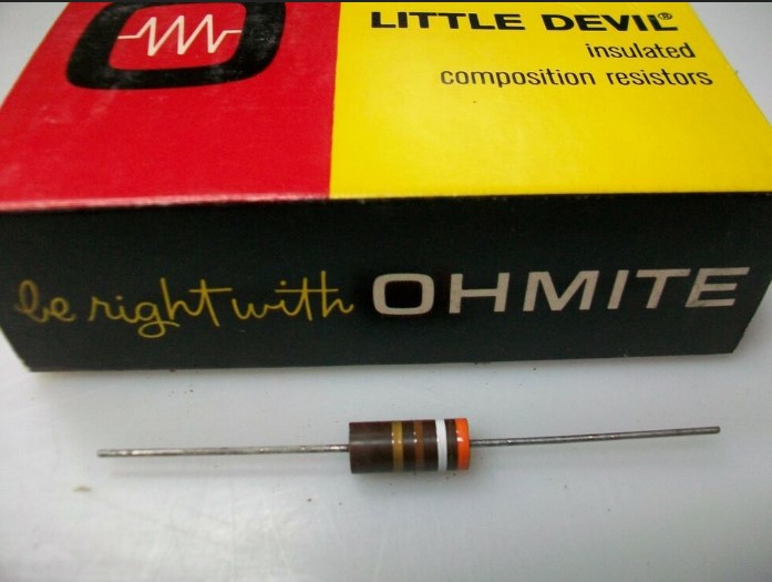

If the resistor is in series with a relay coil, sitting there running hot day in and day out, it could turn brown into violet easily. Discoloration is a sign of long term (over)heating. And if it does read 490 ohms that pretty much confirms that it’s running too hot - values tend to go *up*. Probably using 1/2 watt carbon film when they really needed 2 watt MOX or WW for long term stability.
it was def a 2w carbon installed

sorry yes composite
Composite as in carbon composition... NAD use those things? Carbon film is fine but not the other. That's very 1960's.
Carbon composition, you could keep it original:

More a case that the applications that used them have disappeared I think. Things such as line output stages on CRT based TV's although they do still turn up in switching power supplies which see the same very high voltage very fast rise time pulse waveforms. Thy do have their uses still.
