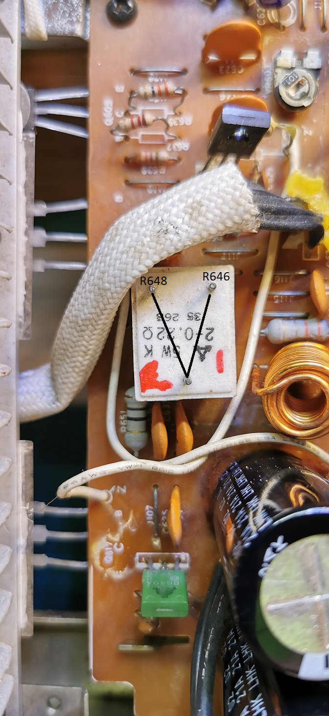

So I would just look at the voltages now across one of the 0.22 ohm and see if it alters as the bulb becomes brighter.
well they are -71mv across and when you adjust them, the value changes and goes up as the lamp glows but then immediatly goes back down to -71mv
its the -71mv bit, its pretty much a constant
something isnt right here, when you test for the idle as per the instructions i can only get +5mv on the left test point by adjustment, but if i also alter the other channel i can get it to +11mv, but then the lamp is realy bright
could something be leaking to ground?
im going to get to the bottom of this because its something simple i recon and proberbly staring me in the face.

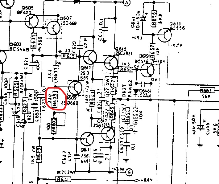

71 millivolt across 0.22 ohms is over 0.3A. That is a lot. I can't really see any way for anything to flow to ground tbh.
If the transistors have been replaced for different types in the past then that might upset the bias adjustment range.
You are going to have to start at the beginning with this one. Concentrate on one channel and begin by forcing zero bias on both. You can lift this resistor to do that.
Bulb should be out and there should be no voltage across either 0.22 ohm.
If that is OK then refit the resistor and work on one channel. If the bias voltage across the resistor is to high then try a 390 ohm or 470 ohm instead of 330 ohm.

I'm getting really confused with what you are measuring here :)
There should be no interaction between channels. If you turn the bias preset on one channel up or down and the bulb goes brighter or dimmer then the control is at least doing something that it should.
thats exactly what i have already done,
So have you forced a zero bias condition on both channels? and is the bulb out or at least very dim?
Lets get it to that state first.
it is zero bias on both, this is with the pots in the positions as instructed before you attempt to make adjustment vr603 fully clockwise and vr604 fully anti clockwise.
with these in those positions the lamp is very dim but as you adjust them the lamp gets brighter, but no change on the meter reading.
on the instructions it refers to TP1 and TP2 ok,
A-method-so ive been using the bottom pin common to both resistors and i get 0v and no movement.
B-method-if you use either of the top pins you can adjust it to say 8mv and what you end up with is -8mv on the other side which i guess you would expect
with both sides adjusted the lamp is still fairly well lit up.
so which pin would you use, it doesnt specify in the instructions

so an update on my last post.
in the end i stumped reluctantly to good old youtube and watched a guy doing the adjustments on there
doing it his way, which was to connect leads across the resistor and adjust the pots that way i have both bias currents set at 8mv and the centres at 0v, but the lamp is still lit up a bit, so maybe some other faulty component in the circuit i just have to find?
the lamp should be off right?

im wondering if im actualy chasing nothing now
all the voltages seem ok, the centre is 0v on both and the idle 8mv on both
the lamop is still on a bit though, so this is realy whats bothing me at the moment, or is it not a prob?

The lamp will glow when you have bias current flowing. So not a problem.
Just remember to make sure the adjustment is still correct when on full mains as it can change with the higher supply voltage.
The centre pin of the resistor pack will go to the speaker output and so measuring from speaker + to that centre pin would always show as 0 volt. If the manual says to do it that way then it is wrong. You have to measure across one of the resistors which you seem to be doing.
8mv will about 36 milliamps current
