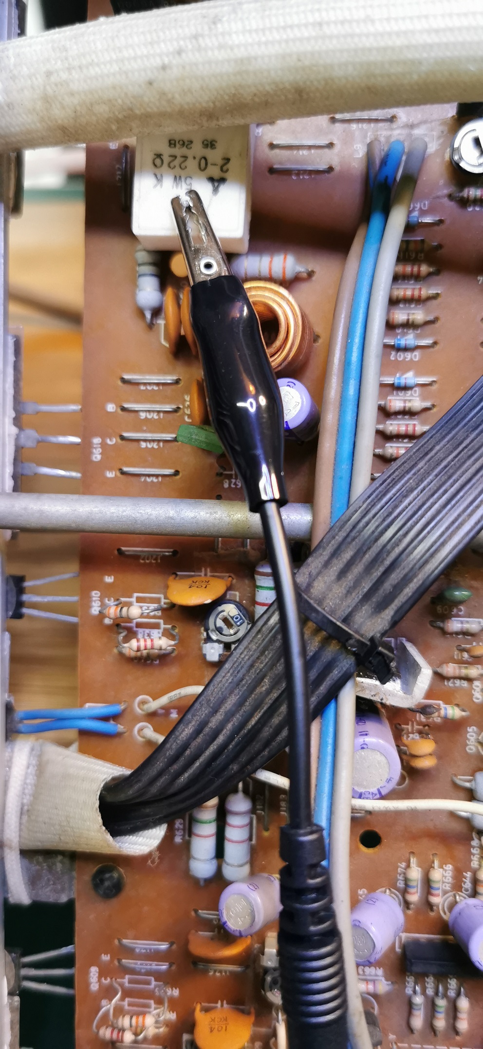

problem is i cannot find TP1 or TP2 which i presume means test points and they are supposed to be on the underside of the board, bit i cant find them for love nor money
maybe someone on here has had the same issue and knows where they are?
ok for those who may need to find in the future tp1 and 2 are ontop of the large white resitors

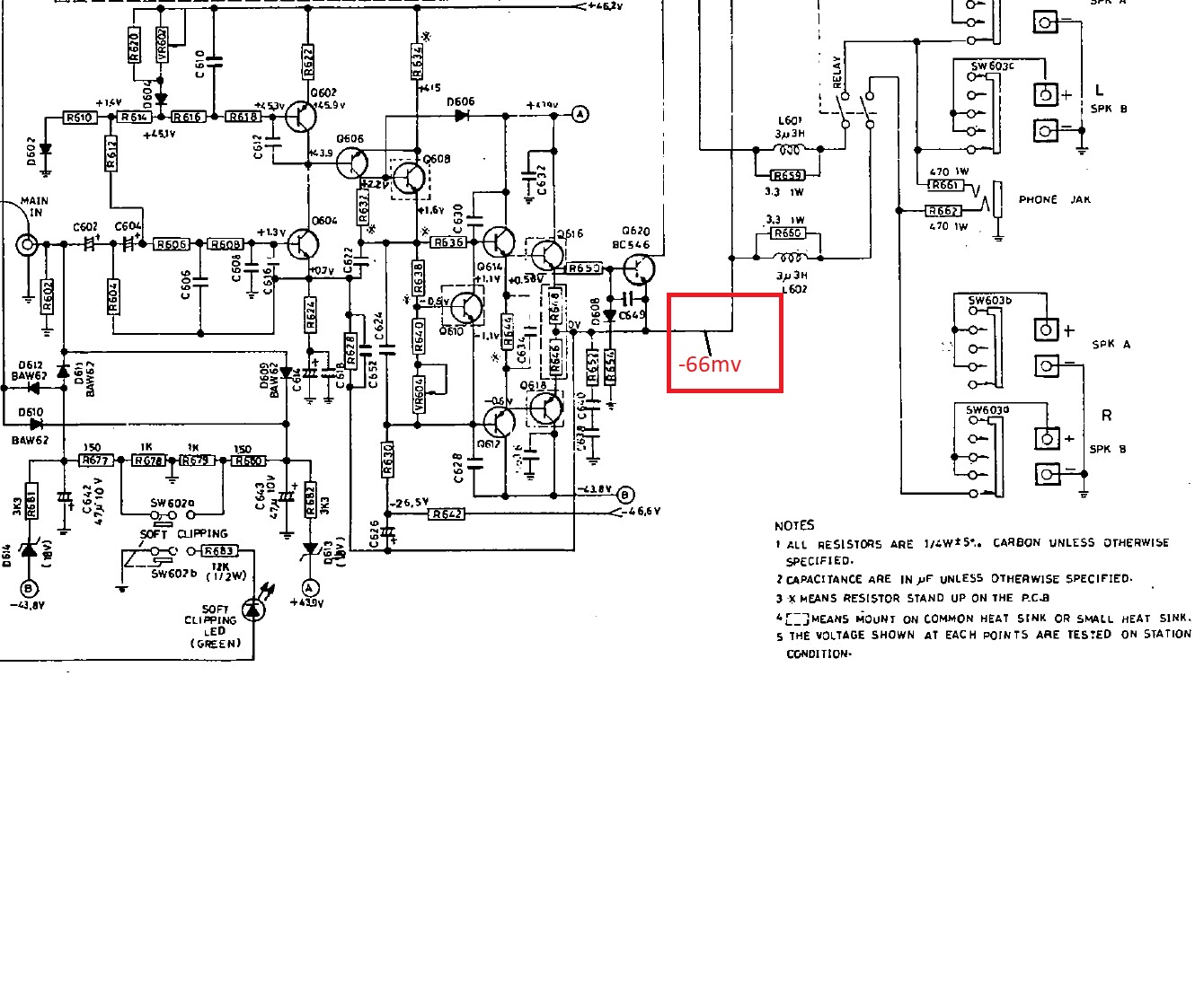

main issue at the moment is i cant alter the idle current.
when i do it as per the instructions there is no movement on the meter at all, as i turn the pots the lamp just gets brighter or dimmer, i guess as the current is increased, but no change in the meter readings.
worked ok doing the centre no problem so nothing wrong with the test points ,or the pots as they are new ones.

It sounds like the adjustment is working if the bulb increases in brightness.
Just measure voltage across the emitter resistors in the normal way to start with. It has to be working.
ok so i think i might be getting somewhere here
i think the left channel is ok,it says to let it warm up for 5 mins and i proberbly didnt first time around ,but the left channel adjusts up ok so set at 8mv and centre is 0v
right channel is at -11mv(closest i can get) so i think the issue is with the right channel and thats where im going to concentrate my efforts starting with the voltages from the beguining

For the centre voltage it is the voltage across the speaker terminals that is the one that matters.
If you have zero volts done that way and then you measure from chassis ground and see -66mv at the output then that is probably because of slightly different ground potentials within the amp which is not normally a problem.
(If all grounds were absolutely all the same and had zero resistance between them then we would not have all the problems we see with ground loops and hum and buzzing. So we have to work around them and create 'local' grounds relevant to the circuitry in that area. It is common in digital stuff like CD players to see analogue ground, digital ground and perhaps a separate ground for the motors. They all seem to connect together but the way they do is critical to get low noise because of small voltages and circulating currents)
its just the idle
something is just niggling at me because i cant adjust it and if you try to adjust it the lamplights up realy bright, and its always on, dim but always on
ive checked all the voltages, right from the power supply, replaced that resistor that was open circuit, and the rest of the voltages seem ok, and yet i just dont think its right
i certainly wouldnt want top plug it into speakers as it is.

Lets start at the beginning... it gets a bit confusing what is going on you see :)
1/ The centre voltage adjusts OK to zero volts as measured at the speaker terminals. Yes?
2/ The idle current doesn't register as altering on the meter and yet the bulb goes brighter or dimmer as you turn the preset. Yes?
If those two are a 'yes' then connect your meter across either of the 0.22 ohm and with the preset turned to make the bulb at its dimmest measure and record the voltage across the resistor.
What is it?
Now turn the preset so the bulb is brighter and measure the voltage again.
What is it?
Also silly question... I'm assuming the speaker relay is closing correctly and you really are measuring the true DC offset and not just some floaty value because the relay is open.
