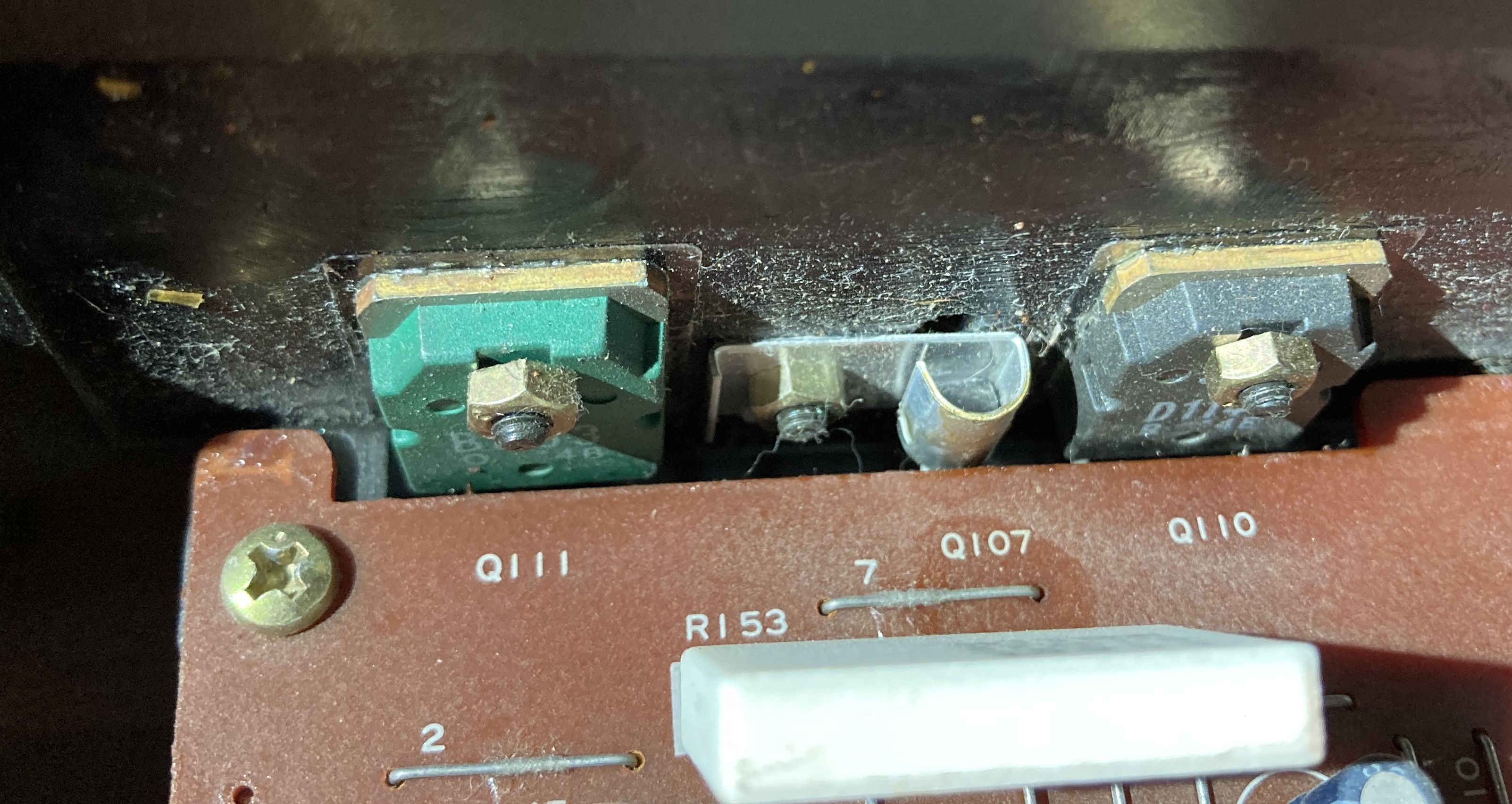

In a previous post it was recommended to leave Q110 and Q111 out and in their place tack a diode on the B-E pads. I have not tried that yet, but wouldn't that be the same thing as putting Q110 and Q111 back in but leave C disconnected? I have previously tested Q110 and Q111 out of circuit and the B-E junction looks OK.
Are these TO3 output transistors? Leaving C disconnected means not placing the transistor on the heat sink, and that endangers them if the cross current is 1 or 2 amps. Even for a few seconds. I'd just put them back, let the 40 w bulb limit the damage, and measure idle bias current or Q107 voltage quickly. I use an outlet strip in front of me to give me quick access to the AC power switch.

Q110 Q111 and Q107 are mechanically connected to the heat sink but are all electrically isolated. The bracket for Q107 is pretty kludgy and if one is not careful the TO92 could get pushed deeper into the bracket and risk shorting out the leads (heatsink is chassis ground). I did not see any evidence of this happening though.

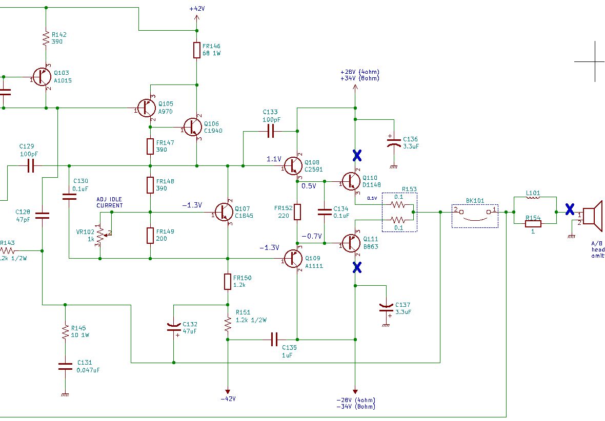

Checked the fusable resistors and they are OK. Output transistors Q110 and Q111 are back in (C is not connected). I'm getting the 2.4V across bases Q108 and Q109 as shown. Q108 and Q109 starting to get toasty and beginning to pull down the +/-28V rail. Hmm...

Umm .. Except, if an Emitter resistor has failed Open, there's no path for the current to increase. It's a handy way to roughly estimate the health of the bias circuit, without putting the output devices at risk .. Or buying a pile of fuses .. Or wearing out the Variac or the dim bulb tester .. 😉

What is the voltage across the two legs of R153 to BK101?
If +28 is collapsing, perhaps Q108 is leaking. Voltage above should show it. Could be Q106 bad, voltage across 68 ohm resistor fr146 should show if that current is excessive.
We're getting closer to the real problem, then! 😉 There shouldn't be enough current demand to more than slightly warm the drivers, let alone yank down the high-current 28/34 volt supplies.
Is the 4/8 ohm switch in the 8 ohm position, by any chance? What is the dim bulb tester saying at this point?
What voltage do you show across FR152? What voltage from it to ground? (In other words, is the feedback loop doing its job?)

Speaker in 4 ohm position. High current rails are +/-26.5V
Q109 B = -1.3V, E = -0.7V
Q108 B = 1.15V, E = 0.5V
So across FR152 I've got 1.2V, or about 5mA flowing through that resistor.
Quick check shows three legs of R153 are sitting at -0.1V

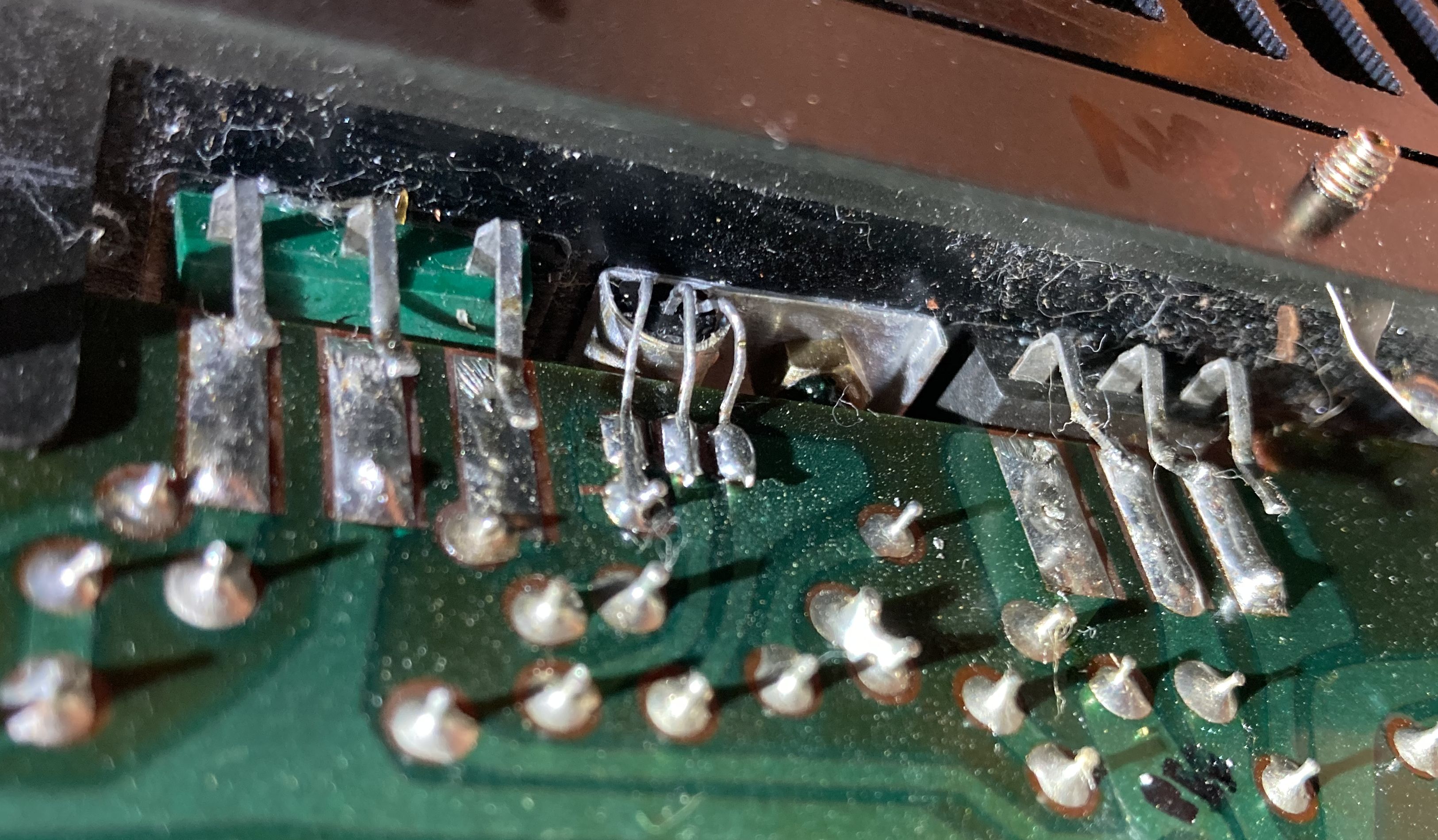

Hold on... I may be looking at a bad solder joint somewhere. Pressing on the board makes the 40W dim bulb glow and dim. Will touch up all the solder joints and in L and R channel amp sections now.
More profitable is taking more voltages to speaker ground from the component leads. Usefully, touching component leads with the meter probe often makes the dim bulb go out. If so, bingo! that lead is the problem. Write down the voltages you take, as you've done here prviously. The problem may not be obviousl, but after you stare at the print with voltages improbable readings lead to analysis.
If voltage on the component leads at two ends of circuit trace are different, you've found the bad solder joint. No point in touching up the others, they were made by pros. Meanwhile, the voltages themselves tell you something about the components. Vb>Ve of a transistor more than ~.7 v, it is likely open. voltages at two ends of a resistor > that allowed by wattage rating, it is blown. (experience will tell you what wattage rating is by size). V^2/R=P.

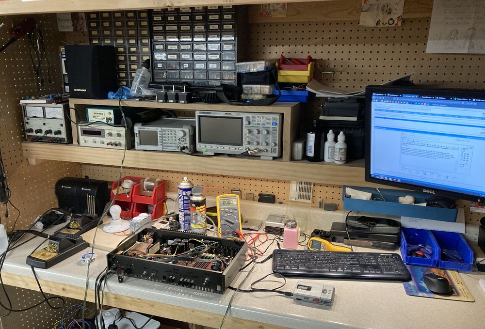

Well after going through both amp sections with a soldering iron and touching up all the solder joints the voltages around Q108 and Q109 started to look more consistent across L and R channels. So I fully connected the output power transistors Q110 and Q111. And both channels seem to be working now. No hot smell, no magic smoke. Everything seems to be running cool. Adjusted VR101 for 0V at the output OK. Adjusted VR102 for 2mV across R153 OK. Switched out the dim bulb and hooked back up the regular AC mains. Let it sit to discharge the caps, then turn it on. Cycle power a bunch of times. All fuses seem to be holding. 🙂
Huh. Maybe it was just a crap solder joint after all. This NAD amp was manufactured in Japan in 1985. The overall quality of the solder joints is OK but there was a shocking amount of solder flux left on the board. Doesn't look like it was cleaned at all after going through the wave soldering machine. Maybe that was OK in 1985 but it wouldn't fly today.
Anyway, close it up tomorrow and put it through it's paces with better speakers attached. I'll update the schematics and post them here to help others who have been asking for the NAD 3125 details. Thanks for helping a digital guy re-discover the elegance of old school analog.
