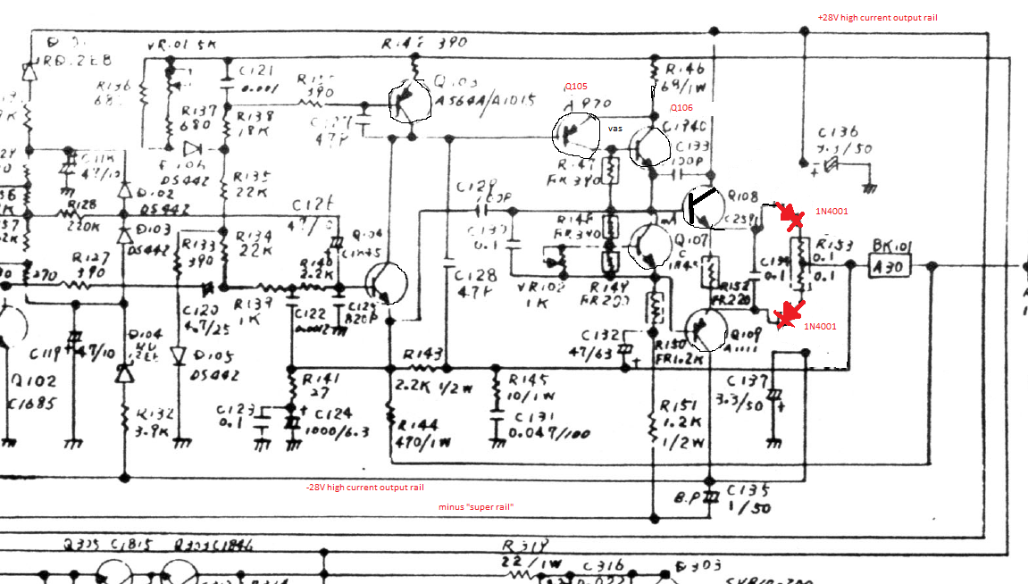

20 ma on output transistors is fine.

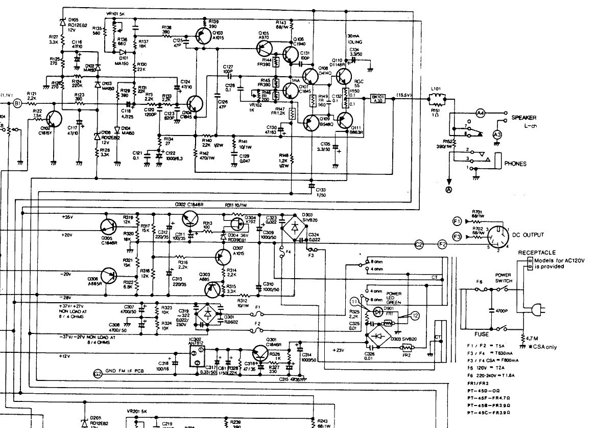

Well after going through both amp sections with a soldering iron and touching up all the solder joints the voltages around Q108 and Q109 started to look more consistent across L and R channels. So I fully connected the output power transistors Q110 and Q111. And both channels seem to be working now.

Got it all put back together and connected to some proper speakers. Sounds GREAT! I'll have to check to see if this amp is based on the famous NAD 3020 design. Anyway, here are the updated schematics for the amplifier and power supply sections of the board. Hopefully this thread is useful to the next person who takes on rescuing one of these nice little integrated amps.

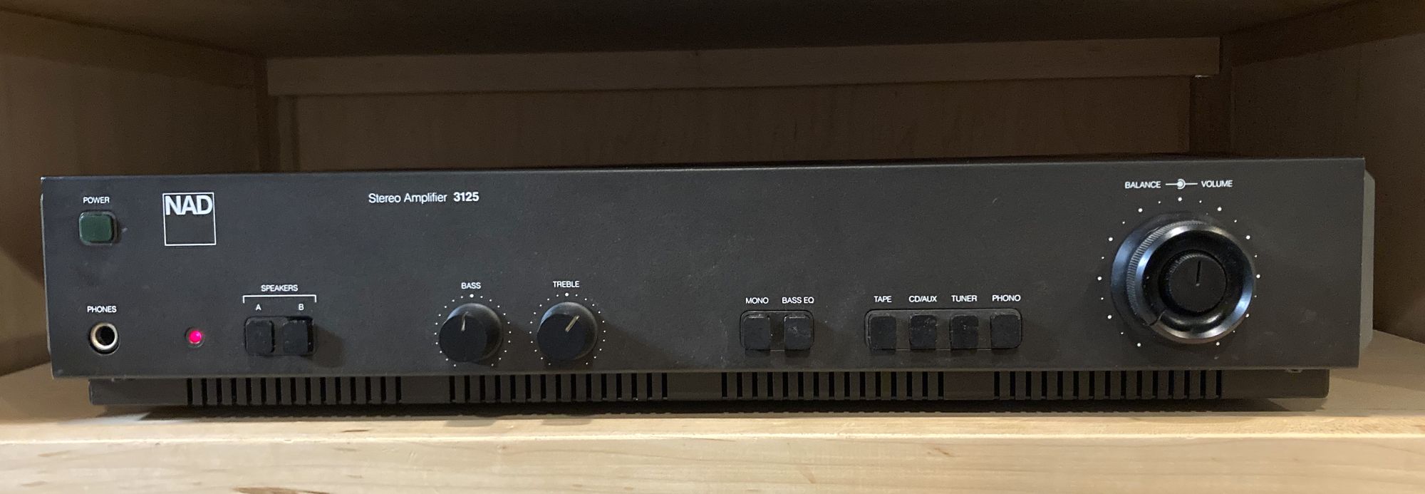

I've got this NAD amp connected to a pair of Micca MB42 bookshelf speakers (supposedly 4 ohm) and I will say the setup can get LOUD. Speaker setting on the amp is set to 4 ohms. Don't get me wrong, it sounds fantastic. But to me the "usable" portion of the volume knob is about 15 degrees. Are these speakers just too puny for this amp? Or is this just how this particular amp is?
I believe my turntable has a moving magnet cartridge and I am using the phono amp in the NAD. No issues when listening to records; the volume knob can be turned about 90 degrees before it's too loud for my tastes. I have a DVD/CD player on the AUX input and a MiniDisc deck on the TAPE input -- the signal levels that these things are putting out seem to be overdriving the inputs on the NAD and that's where the volume control is limited.

The line in attenuators worked OK but something about the volume sensitivity still wasn't sitting well with me on this amp. I got out the trusty soldering iron and touched up all the solder joints on the preamp, tone controls, volume pot board, and cleaned all the pots with a contact cleaner. That seems to have helped. Before this work the usable volume range was from 7:00 (no sound) to 7:30 (LOUD!) on the volume knob. Now it much smoother and I can turn it up to 9:00 or 10:00. It's pretty amazing that a 35 year old amp sounds this good.
