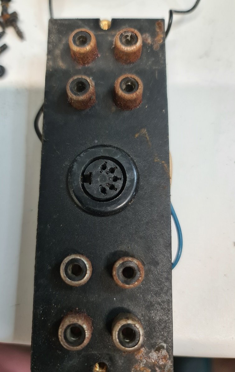

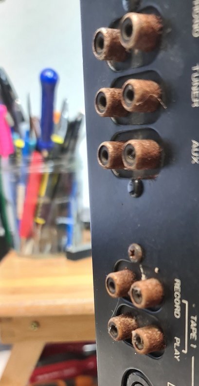

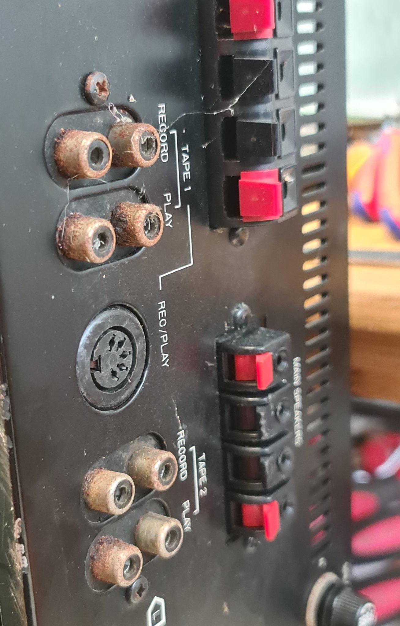

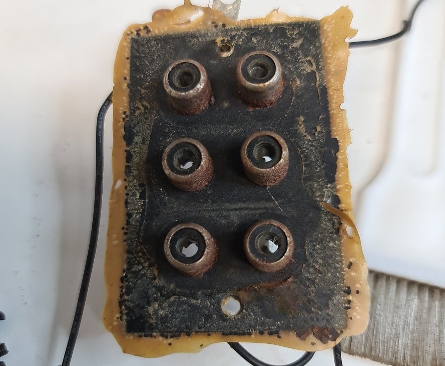

Those rusty rear RCA's have to go.possibly convert to gold plate? or leave original?
possibly convert the grab terminals with push in's? or leave it original

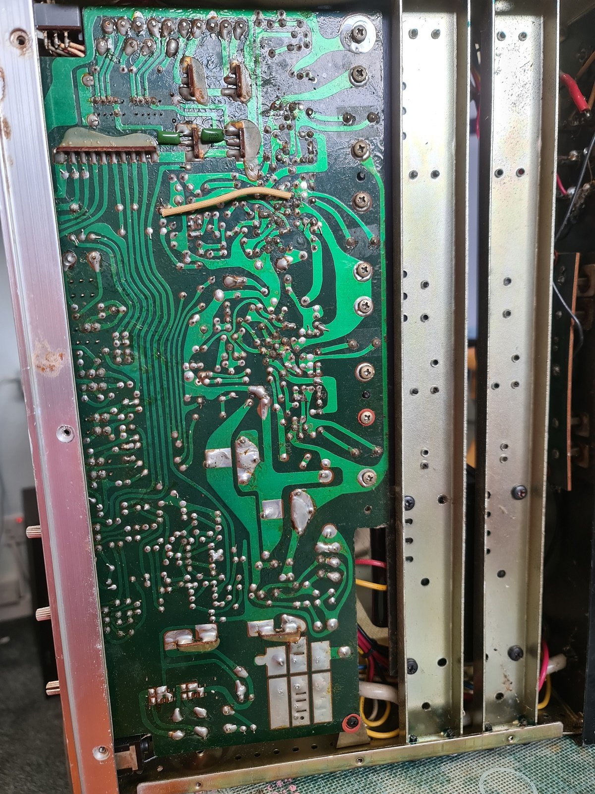

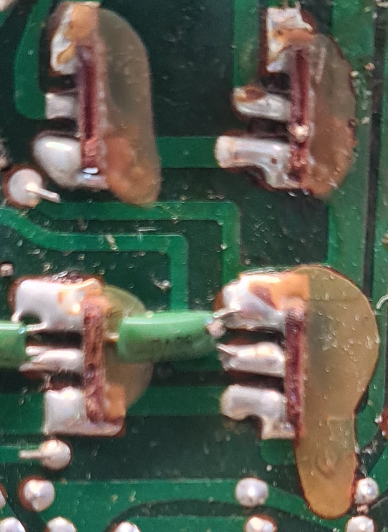

Replace all those old diodes.I have found quite a few over time that have been cracked-poor quality maybe?

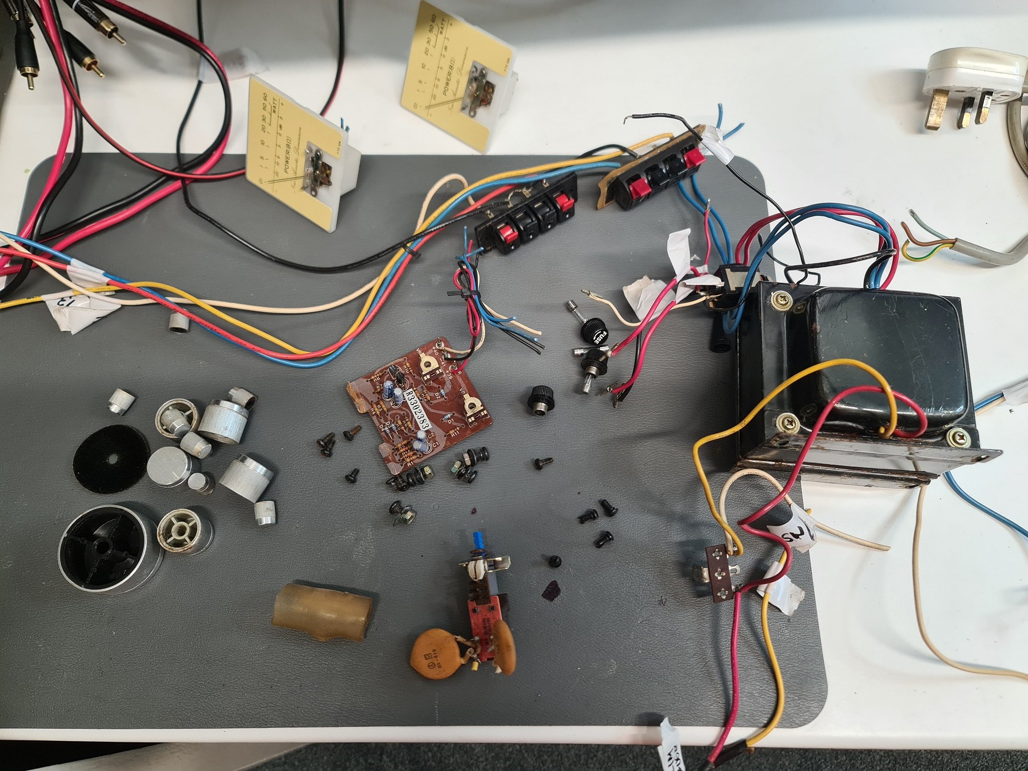

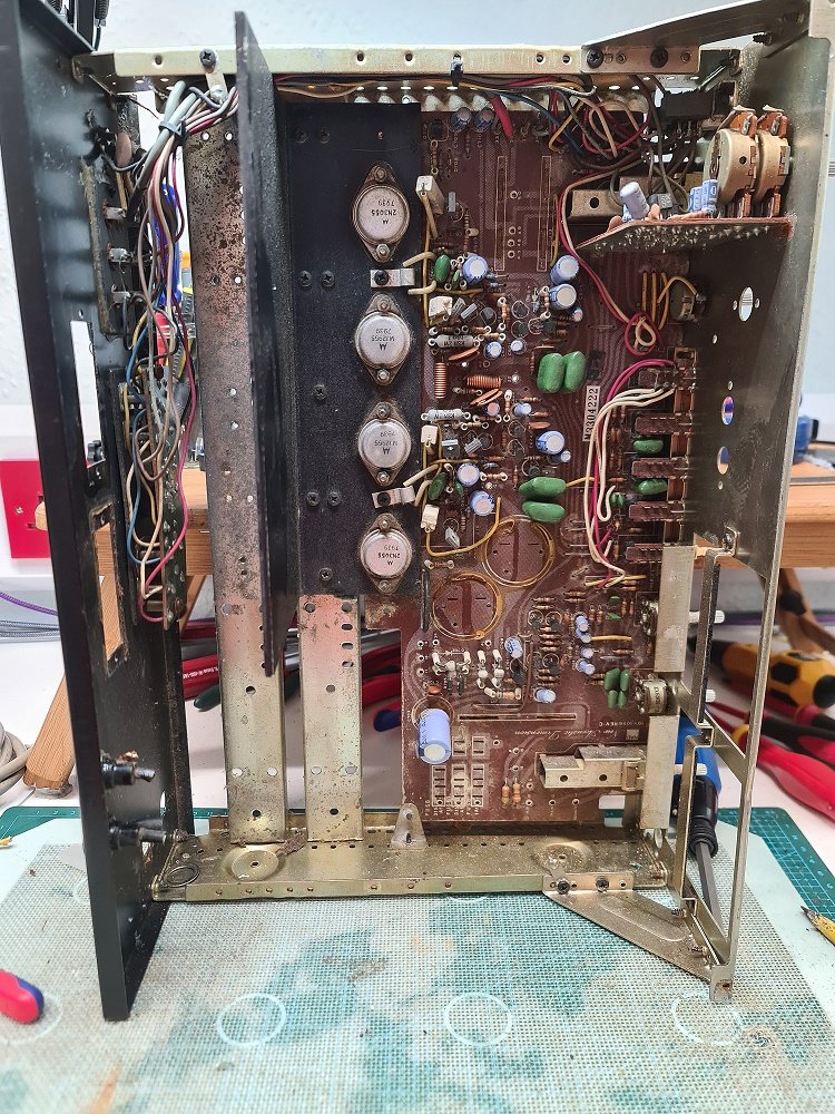

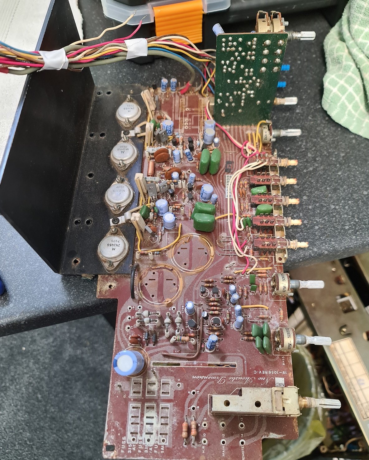

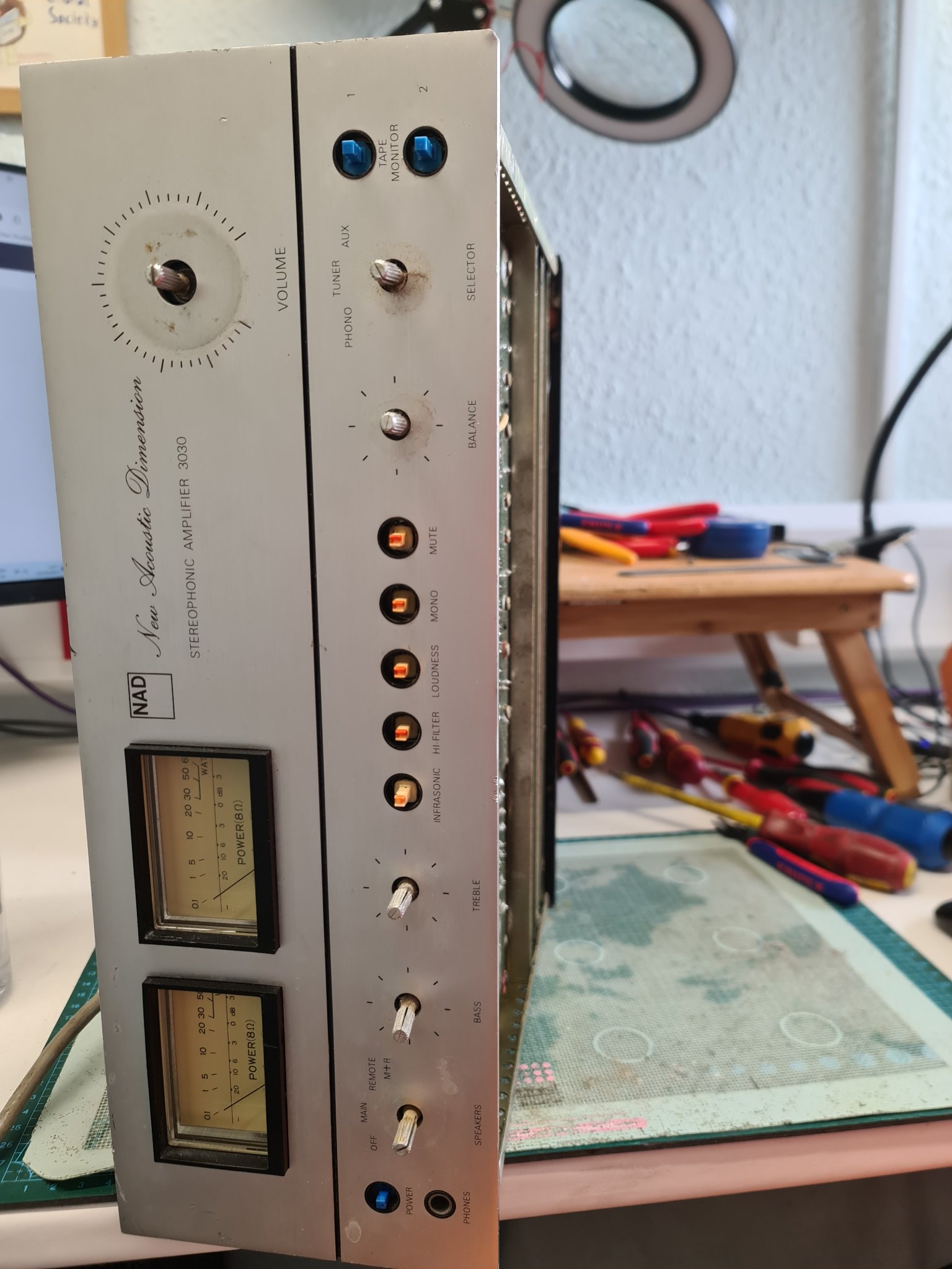

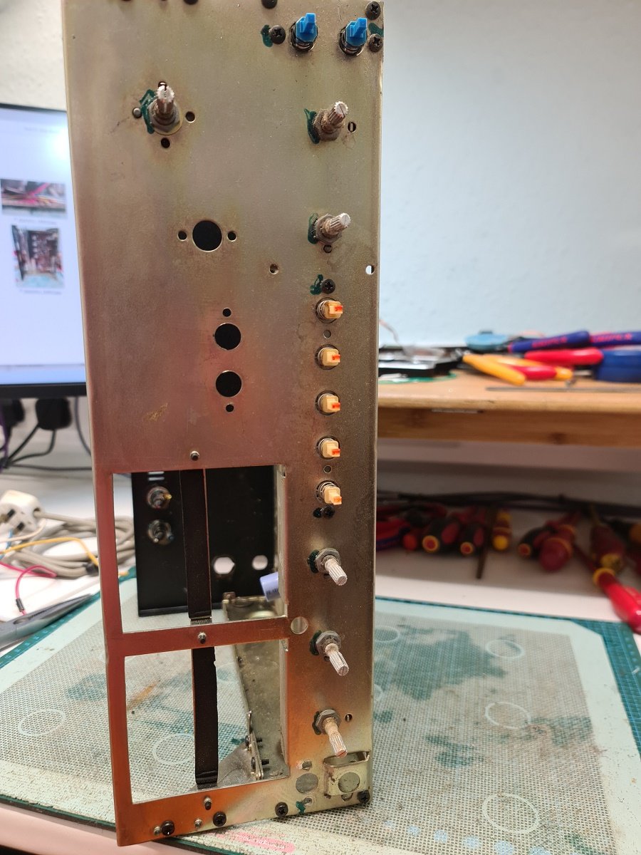

so ive strated the strip down,and there is alot to do

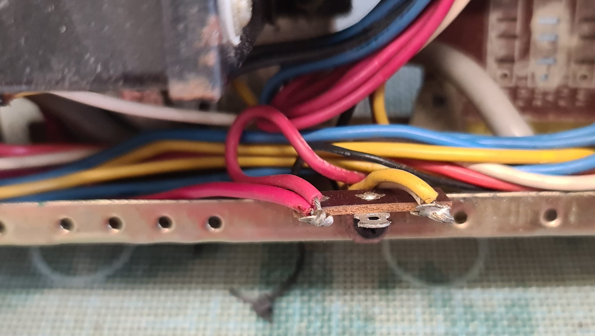

All the cables have been numbers and photographed
need to find some replacement terminals for the rear
just the rear terminals to remove along with the main PCB, then i can get to work cleaning it before i go any further.
I still cant decide if to go with originality or modify
Originality to me seems to be the way to go realy

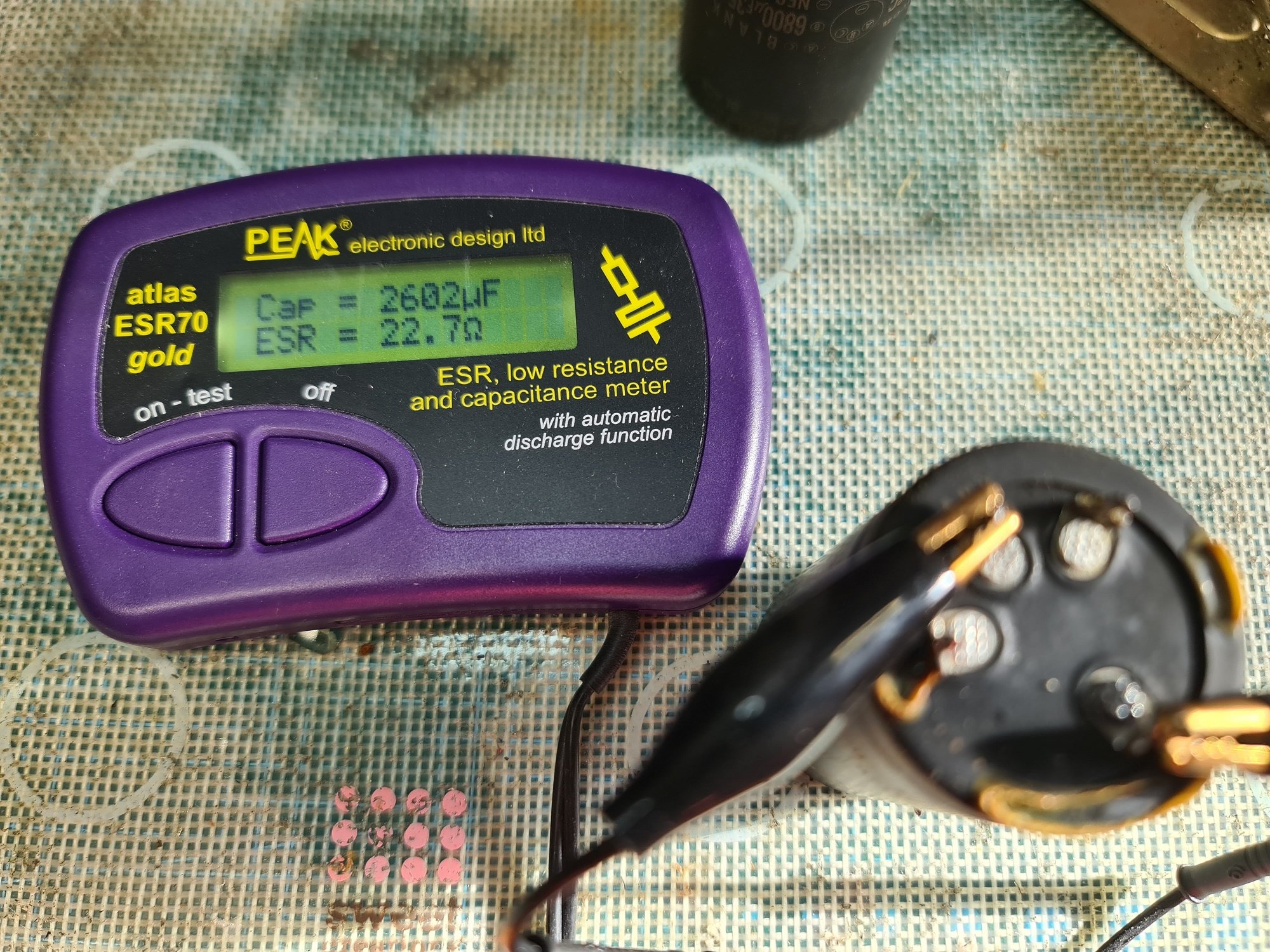

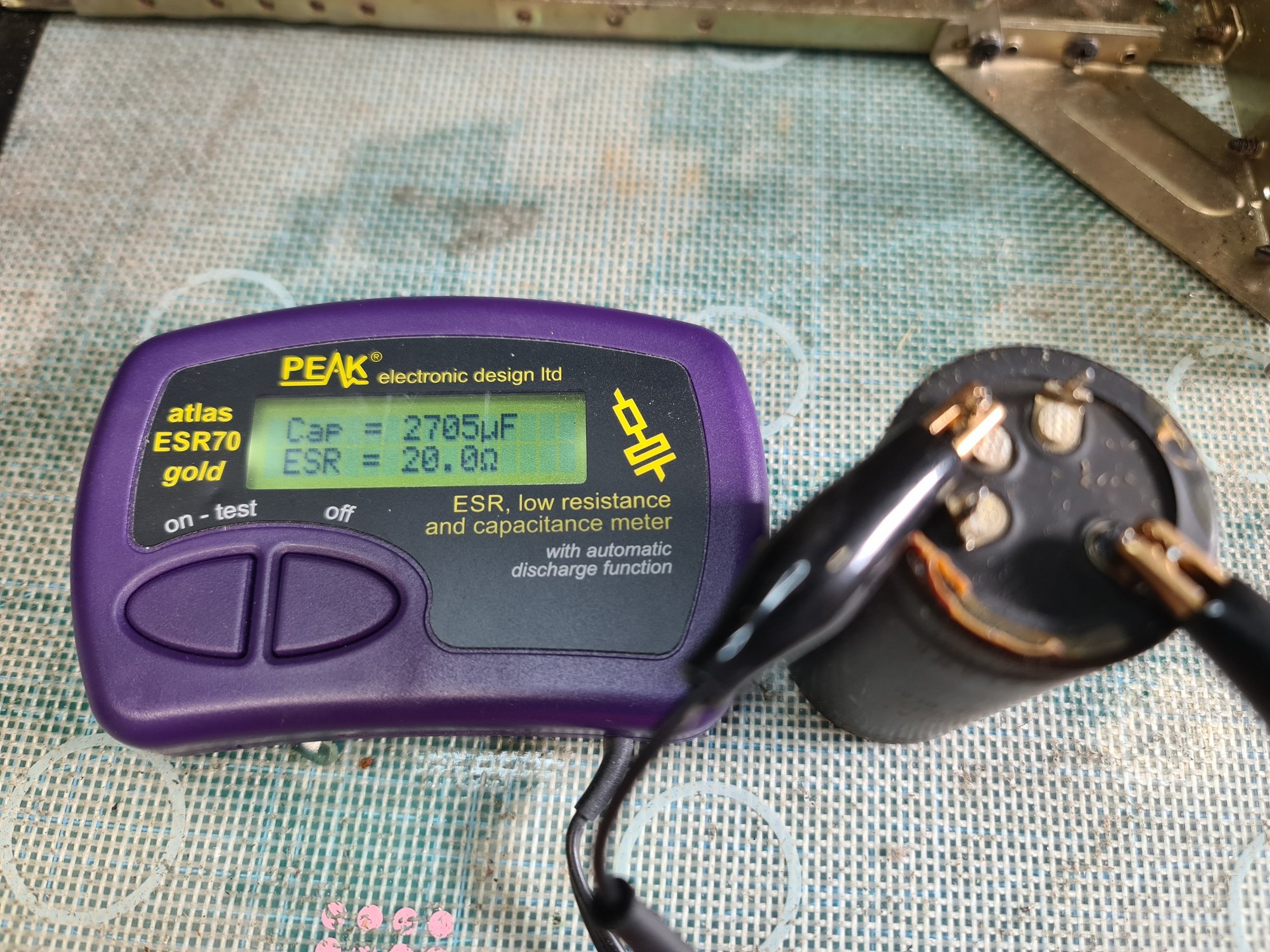

Those main caps were well down,lowest ive ever seen,(originaly 6800uf) other than fully shorted.

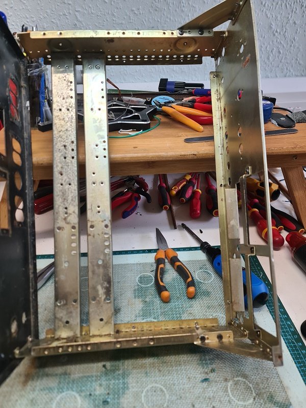

so the strip down is complete.

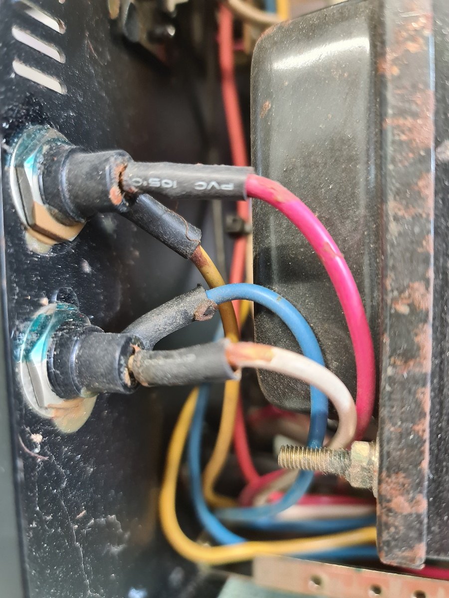

A few challenges, mainly the rear terminals, they are beyond saving, so i need to look at replacing them.Problem with these is that they were pressed into the holding plate in the factory, so ill have to look at an alternative method, but keeing the original look.
The case can be cleaned, as can the front cover and PBC

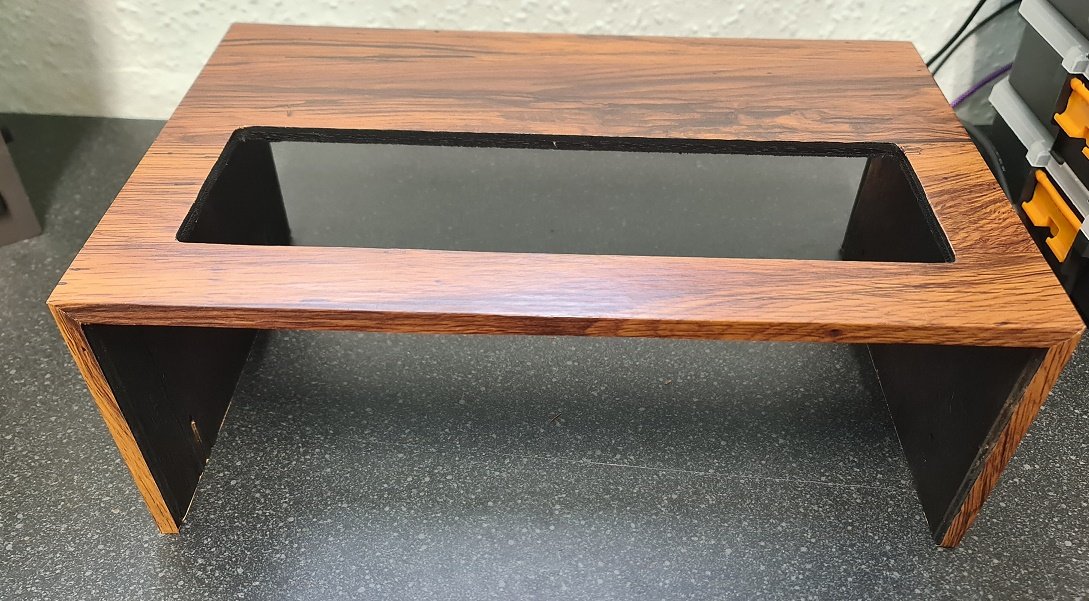

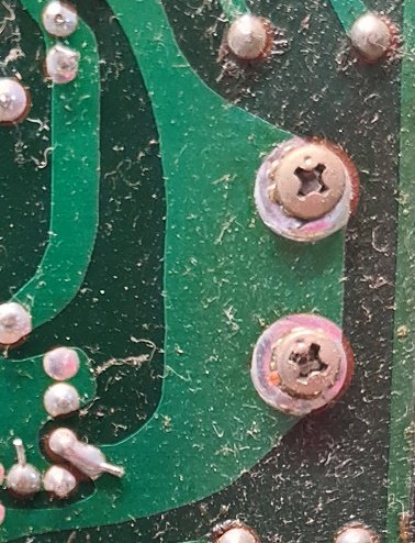

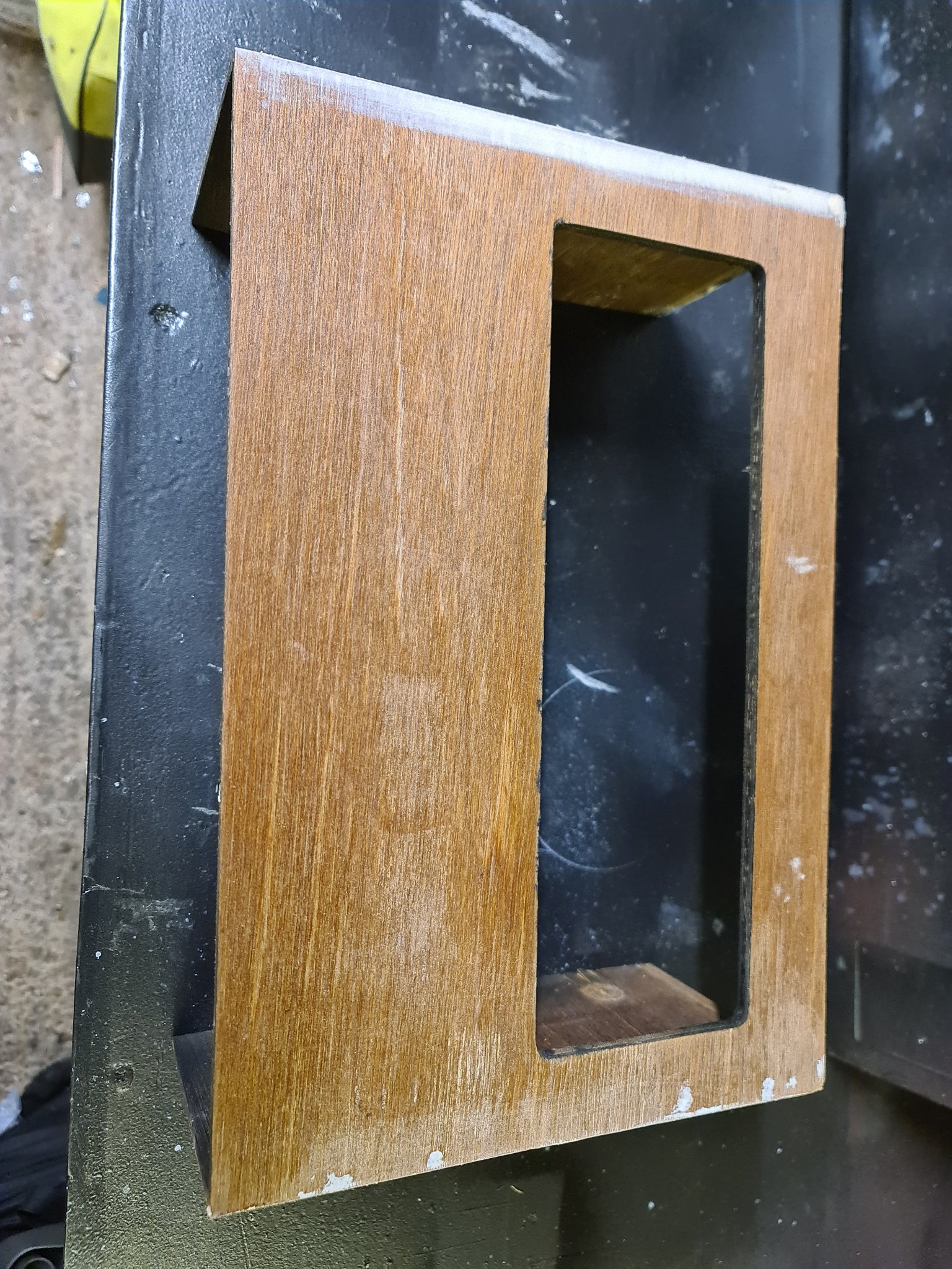

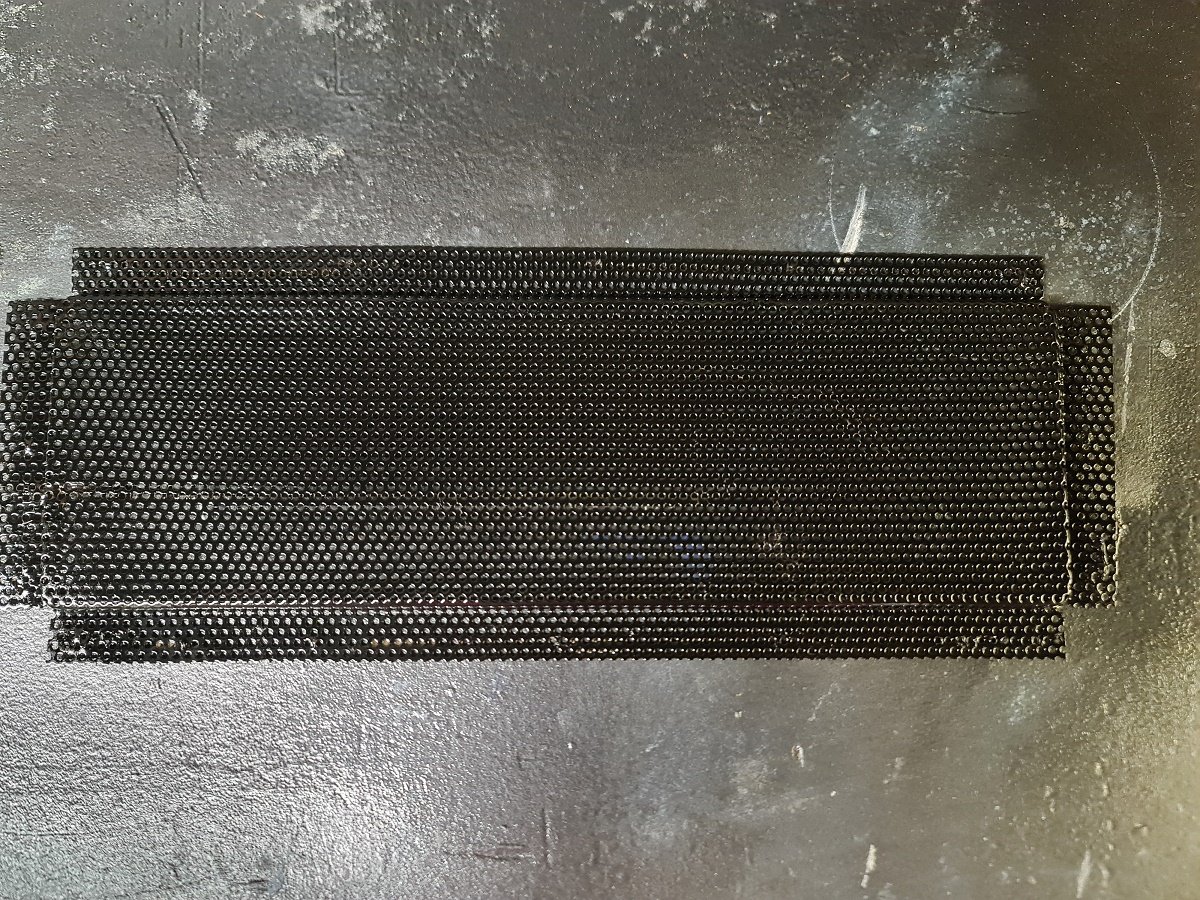

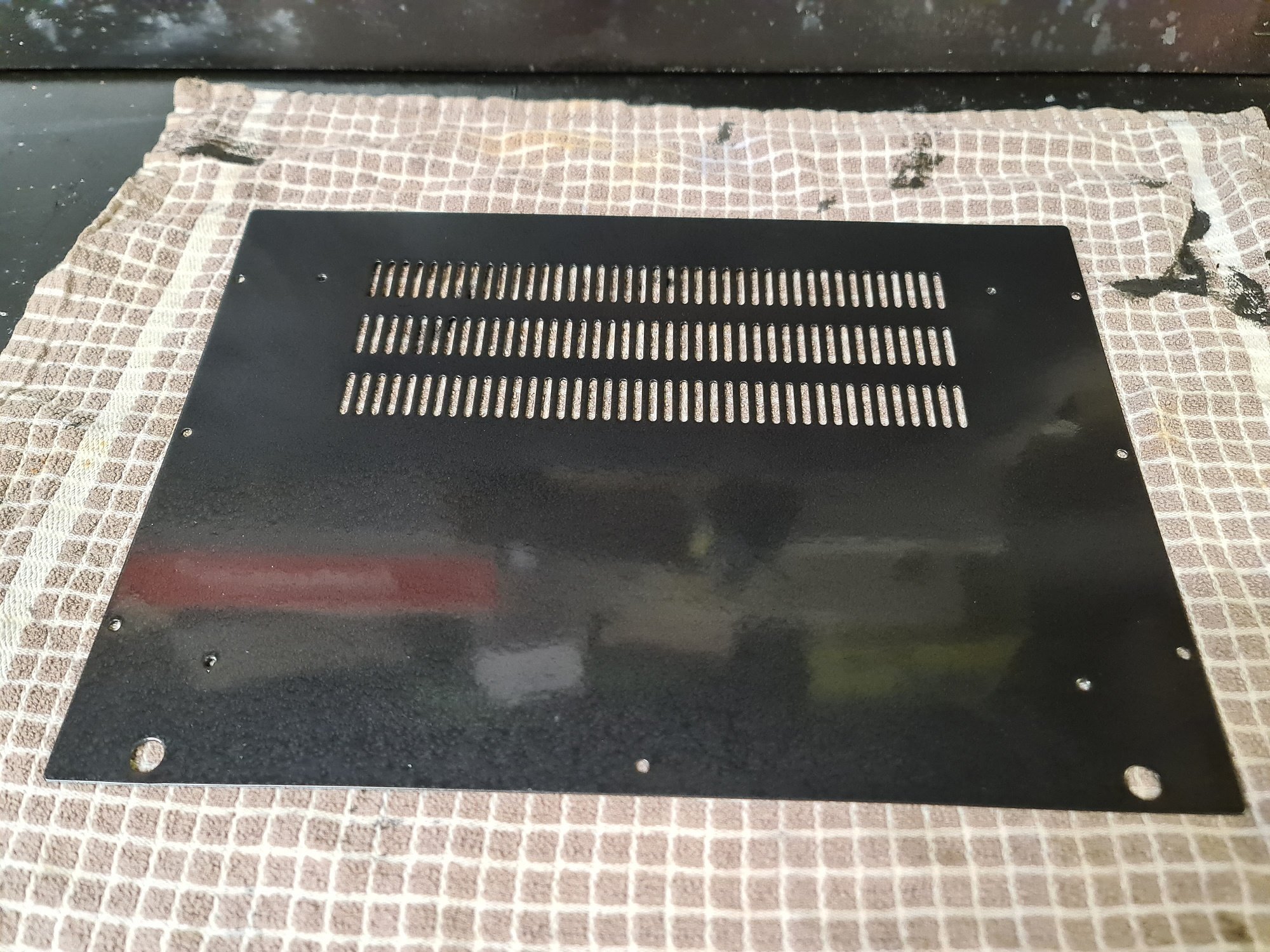

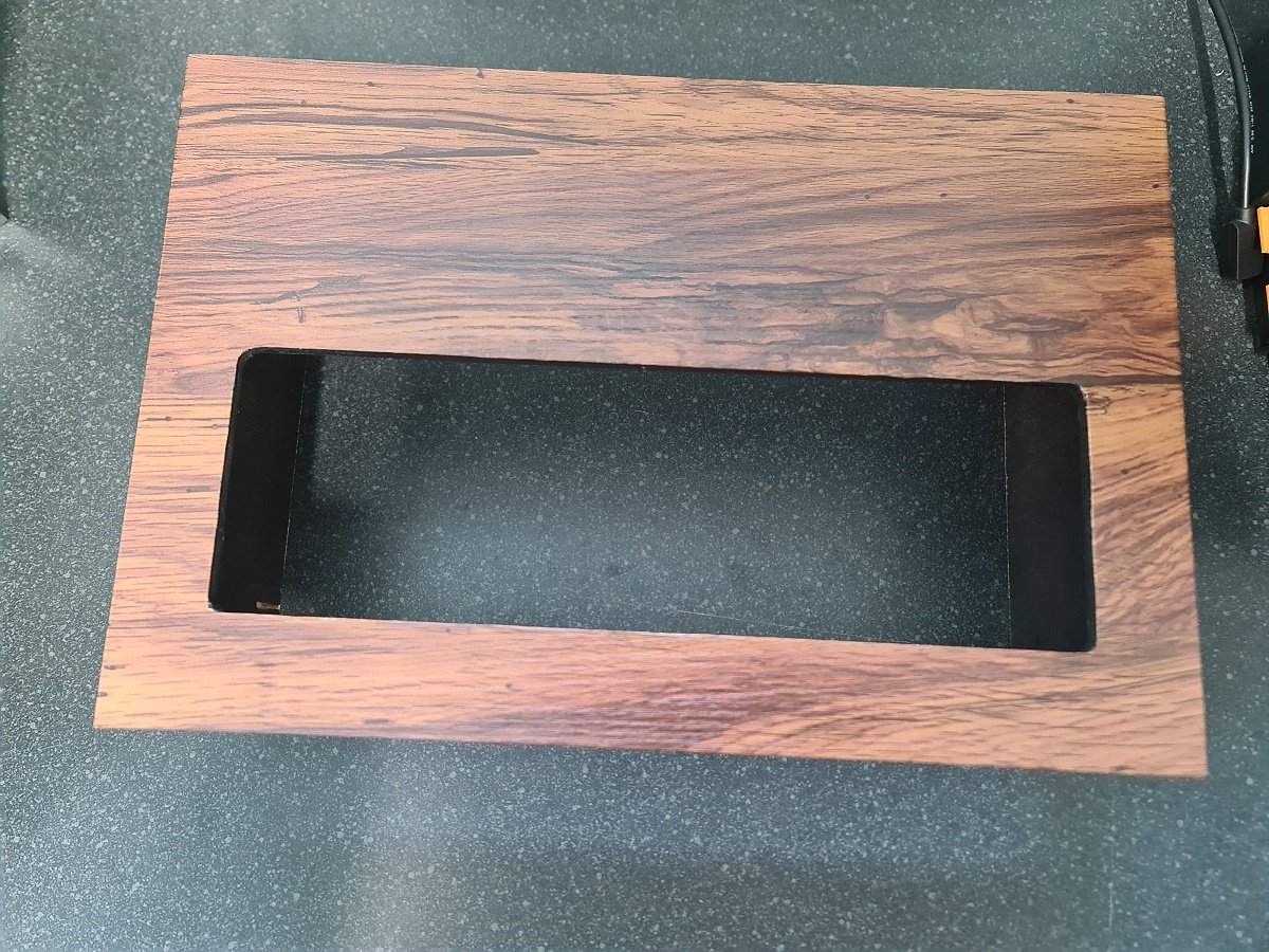

Ive cleaned the main PCB,repaired the wooden cover and re covered it.

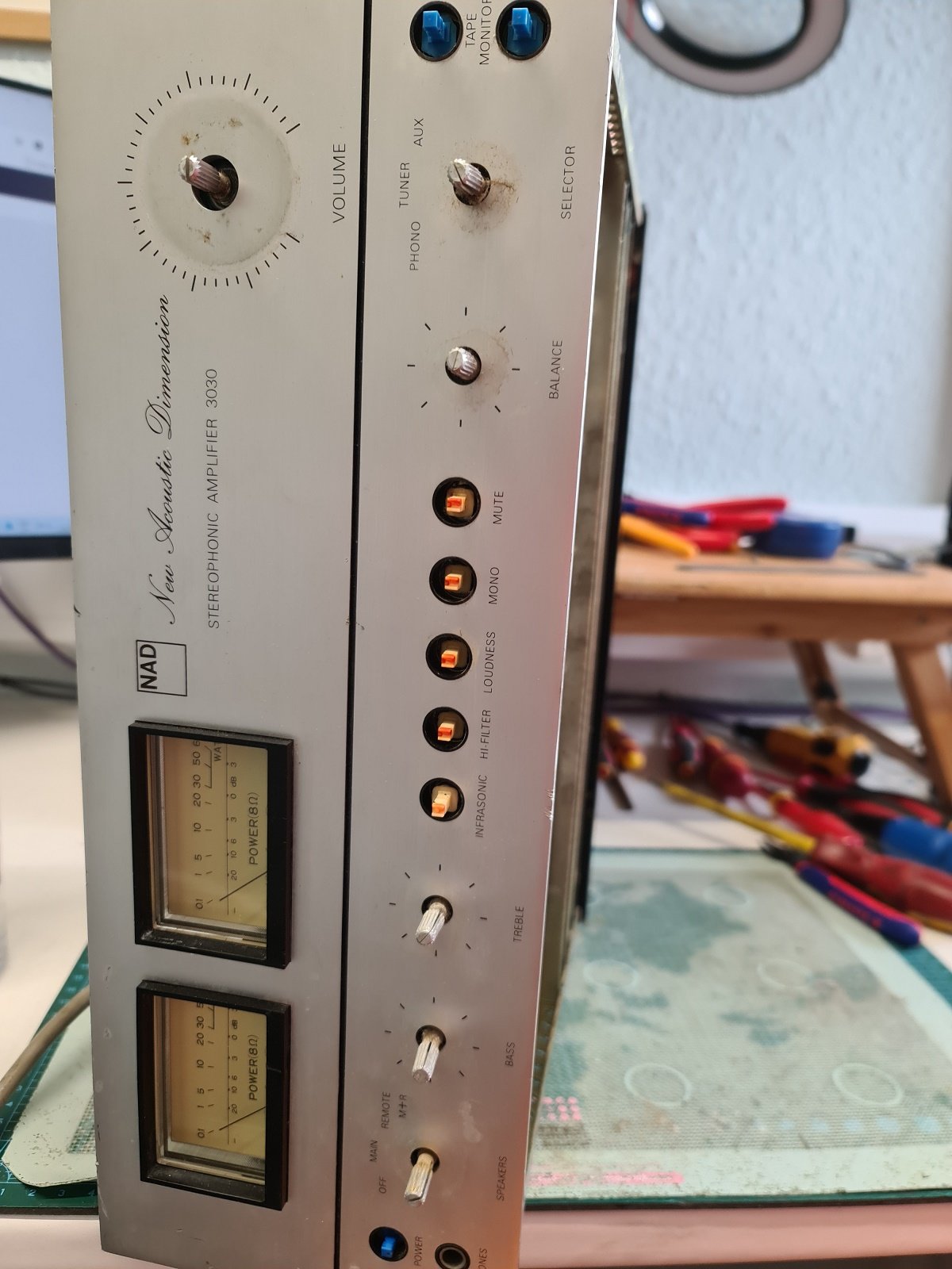

The metal vent grille re sprayed
The base plate has been sprayed as it was realy rusty and would have cost quite alot to get re treated
Well I have to say it looks great 🙂 What can I say... if you enjoy refurbing them then go for it.
