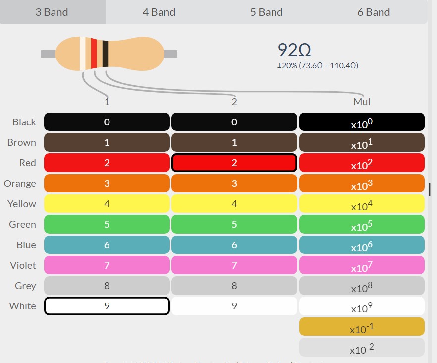

A white/red/black resistor would be 9, then 2 and then 0 (no) multiplier giving 92 ohm.

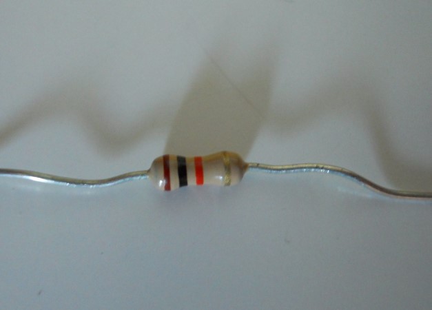

If it is a 10k and has a three band colour code then it would be brown, black and orange :)
which would be 1 then 0 and then three 0's giving 10,000 ohm or 10k
This is a 10k where the last band is orange.

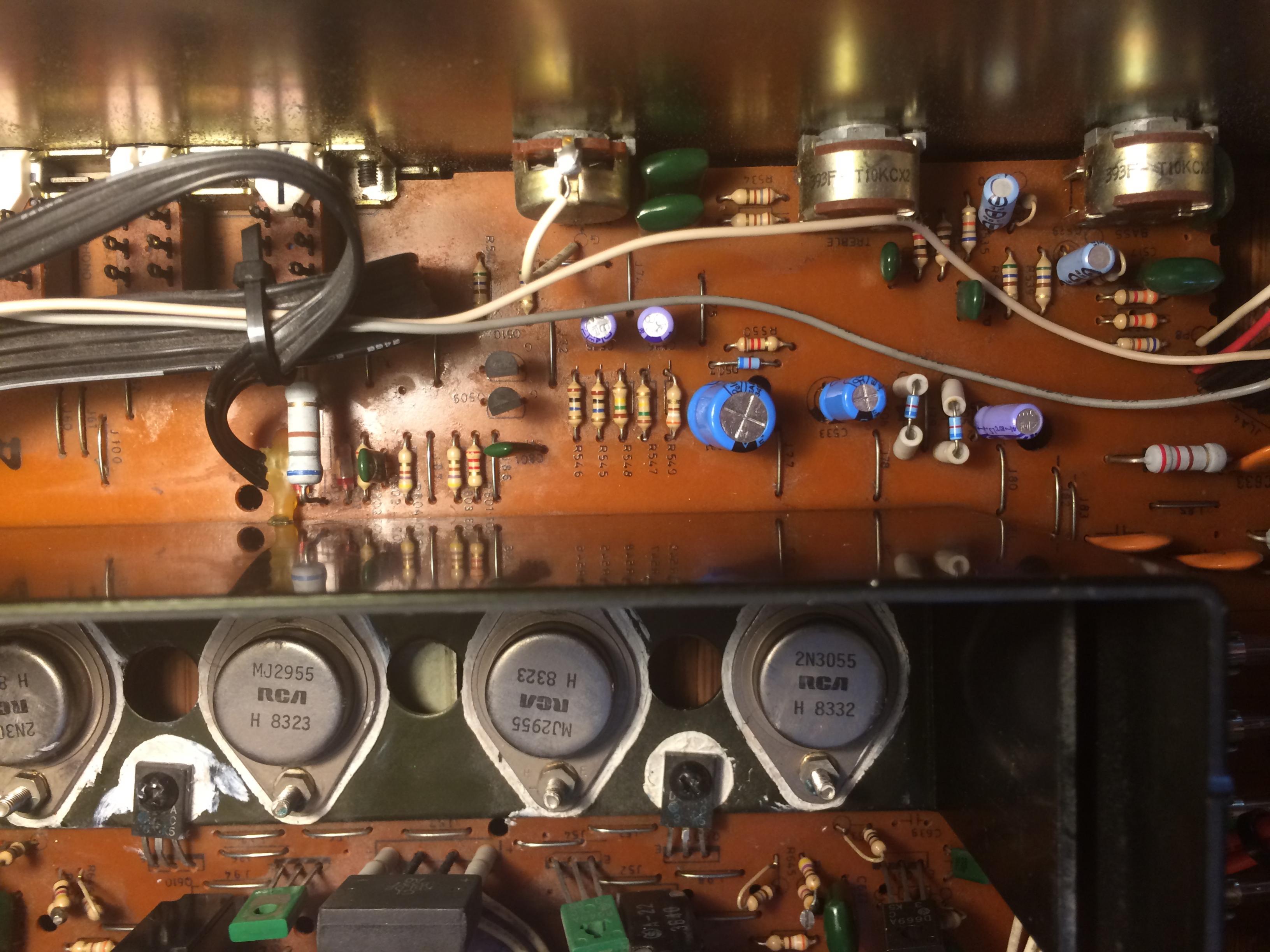

I am trying to send a picture of the resistors of this amp, not sure if it gets thru.

I think that helps a lot Peter. Your resistors are both 150k in that picture.
Based on what you describe... this is where it gets interesting... and the switch would appear to be leaky.
The switch should be 'open' for the circuit to work (unmuted) and so if connecting that lead causes the circuit to mute then it implies the switch is passing current.

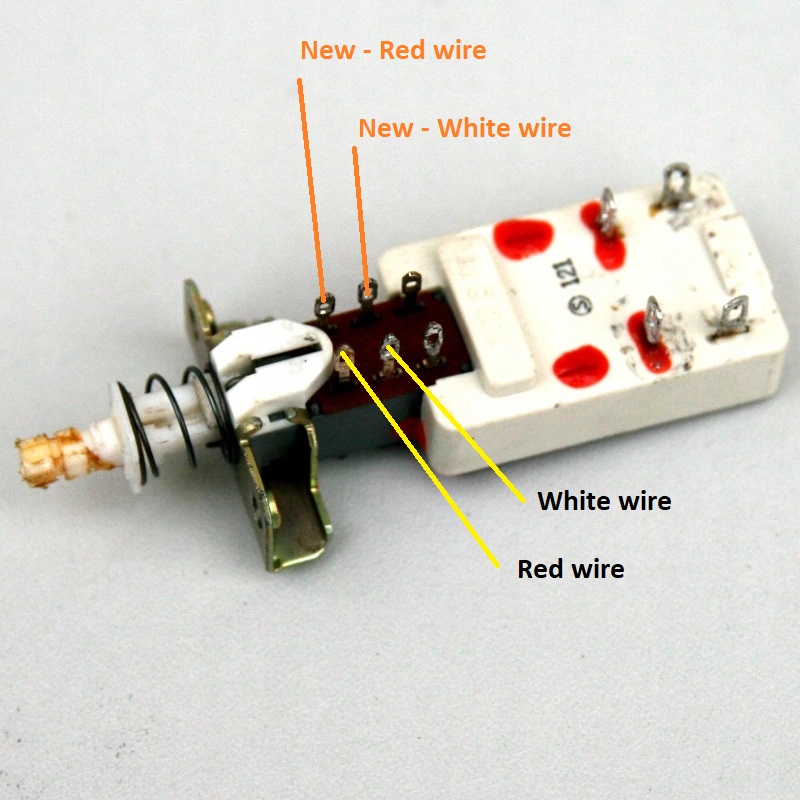

Amp OFF, plug pulled, and the 2 meter leads touching the 2 switch terminals where red & white are usually connected, I would expect almost no resistance, e.g., something like 0.1 Ohms (I'm measuring a spare switch here). You're measuring 62 Ohms - suggesting the contacts are possibly 'dirty', I can't see where else 62 Ohms could be coming from. Is the 62 Ohms repeatable ?
Amp ON, plug pulled, and the 2 meter leads in the same places, I would expect OL for a good switch, as indeed you're measuring.
Need to have a think here... try the following:
The photo shows the 'normal' positions of the red and white wires on the switch where the yellow lines indicate - yes ? please confirm (important).
If so, please repeat the same measurements as above, but putting the 2 meter leads onto the 2 unused terminals indicated by the orange lines and marked NEW. What are the values then ?

I'll take a picture of it if you want me to but on mine the red and white wires are on the same side as in your picture but in different order. On mine the white wire comes first then the red and not the other way around. The left side of the switch is the same as the picture. With the meter set in the Ohm range I get OL with the power switch pushed on and 14.2 ohms with the power switch off or out. That's on the opposite or free side of the switch and the amp not connected to AC on both readings. The switch does look rather dirty, by the way. The outside of it. I have Deoxit, I can spray into it with that if you think it helps.
Mooly - I've always understood the switch to rapidly discharge C531, and thereby effectively 'swamp' the +ve voltage on the JFET drive - so also turning them off immediately as the amp is turned off.
What suprised me somewhat is Peter's result of 'OL' when the switch is in the ON position, which is exactly what it should be, and doesn't suggest 'leaking', or am I missing something ?
Peter - I wouldn't try the deoxit, it's almost impossible to get any into it without physically dismantling the switch, especially the front section (I've tried both... it's not fun). The wire order red - white or white - red doesn't matter, as long as it's the exact same 2 terminals.
