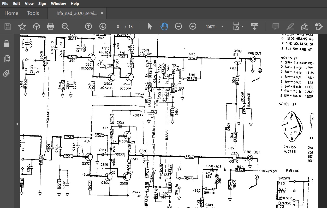

Lets try this in order. Refer to the diagram attached which as far as I know is for a 3020A.
Remove the short and lets have it all back to original.
1/ Measure the DC voltage on the end of D507 that has a stripe. This is the end that goes to the FET gates.
What voltage do you see and also does the sound appear?
2/ Do the same for the other end of D507.
What voltage do you see and also does the sound appear? (polarity is all important for ALL the tests we do here)

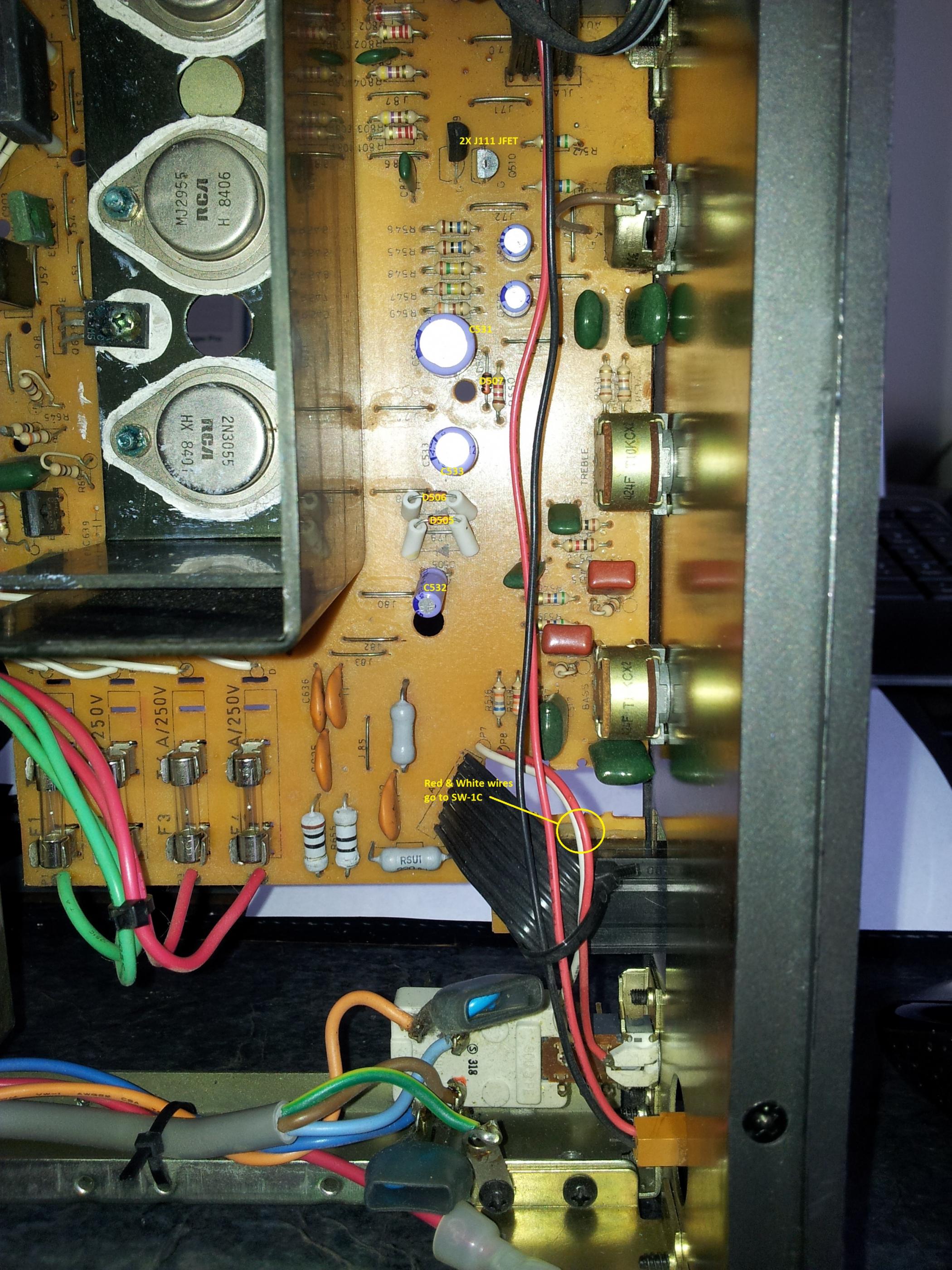

Hi Peter - not sure if it helps, but I've just marked up an old photo of the muting area in 3020A with the main components. If you zoom into the photo the labels should be legible. The resistor codes that you need can mostly be read directly on the pcb / in the photo.
If yours looks different to the photo, please try to post a photo of yours.

4/ The red and white wires to the switch SW-1C. If you measure from ground to each wire what voltages do you see? That's two readings.
5/ Without touching the mains switch at all try unplugging the amp from the wall and then carefully measure between the red and white wires using a low ohms range on your meter. Is the switch reading low resistance?

Yes, thanks, I've studied the attachment upload tutorial but in this case there is no need. Goldie's picture is perfect and it's exactly the same as my amp. These are the measurements, I set the meter on DC:
Red wire 56V negative
White wire 20-21V also negative. Doesn't stay steady
Not quite sure how to measure the resistance, I had the meter on Ohms and with the plug out of the wall it showed something like 120 k ohm when I touched either the red or white wire.
D507 Negative 0.14 and the sound is on
the other end is negative 22V no sound
R548 28V one end and negative 28 the other
Hope this helps. I disconnected the short.

Yes, that helps and makes sense.
There are not many possibilities here... look at the circuit diagram.
We have R548 (I think it is an 8 and not a 6) and R547 in series and across the approx +29 volt supply.
That generates a voltage of approx +20 volts at the junction of the two. D507 and the 10 meg resistors are way to high in value to alter that result. That is calculated using ohms law, 29v across the two resistors splits into 20v across the high value one and 9 across the other.
So you should be seeing that positive voltage at that point (D507) and you are not.
The fault is going to be around that negative rail generator and depending on weird and obscure failure modes could be any of those three caps, the two diodes and (unlikely now given your readings) the switch.

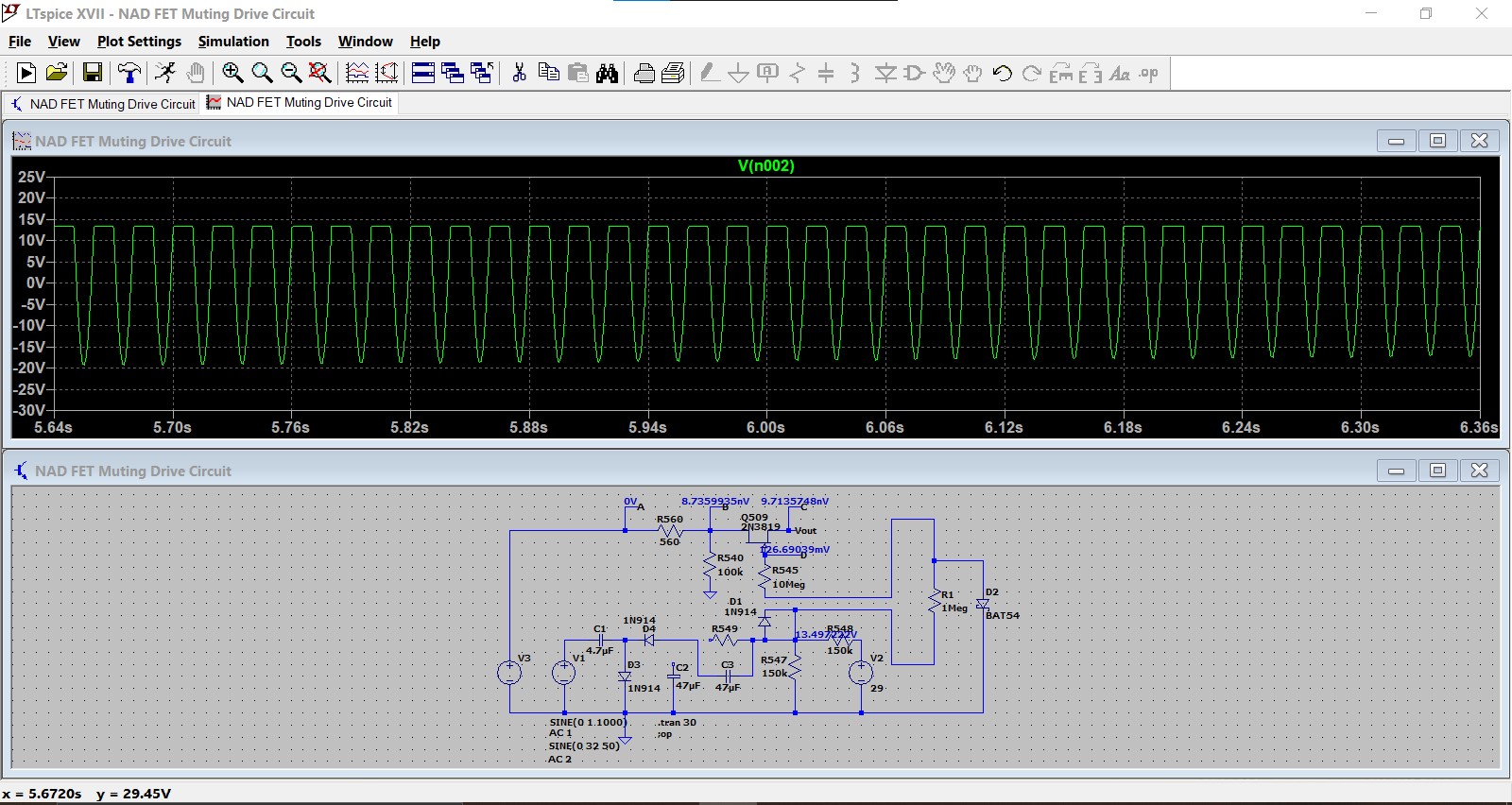

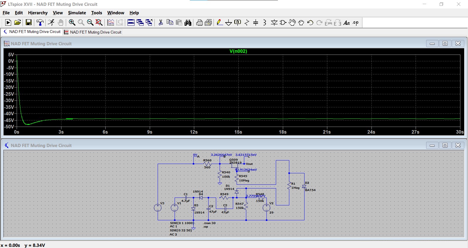

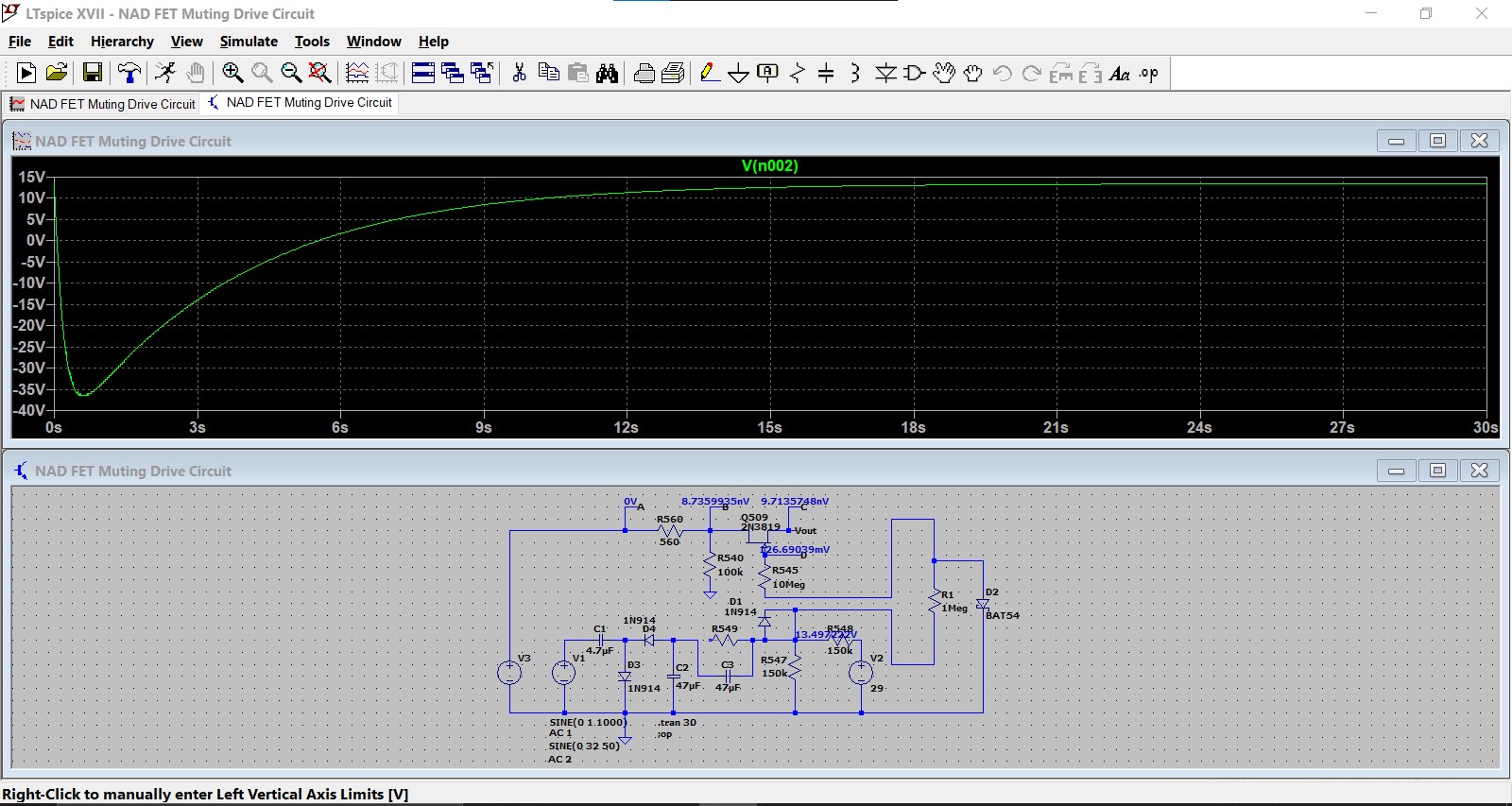

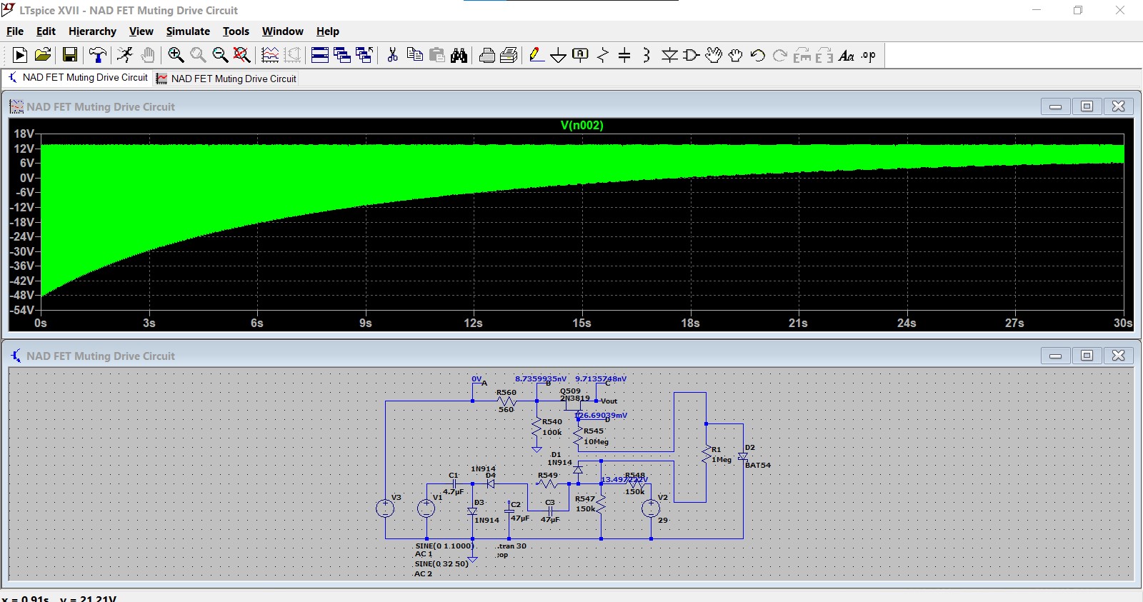

This shows the voltage you should see on D507 over time. These diagrams are how an oscilloscope would show them. D507 settles to a positive value. Once the voltage crosses the approx 0v point the sound unmutes.
First up is all working OK.
Second is a leaky C531 with 20k leakage. The switch would give identical symptoms if leaky.
Third is with C533 open. This cap passes a relatively high ripple current and so that makes it likely to go high E.S.R (equivalent series resistance) meaning it loses goodness.
The waveform appears as a solid colour because it is actually an AC value. If we look at a smaller time period (like on a scope) we would see this (fourth image).
