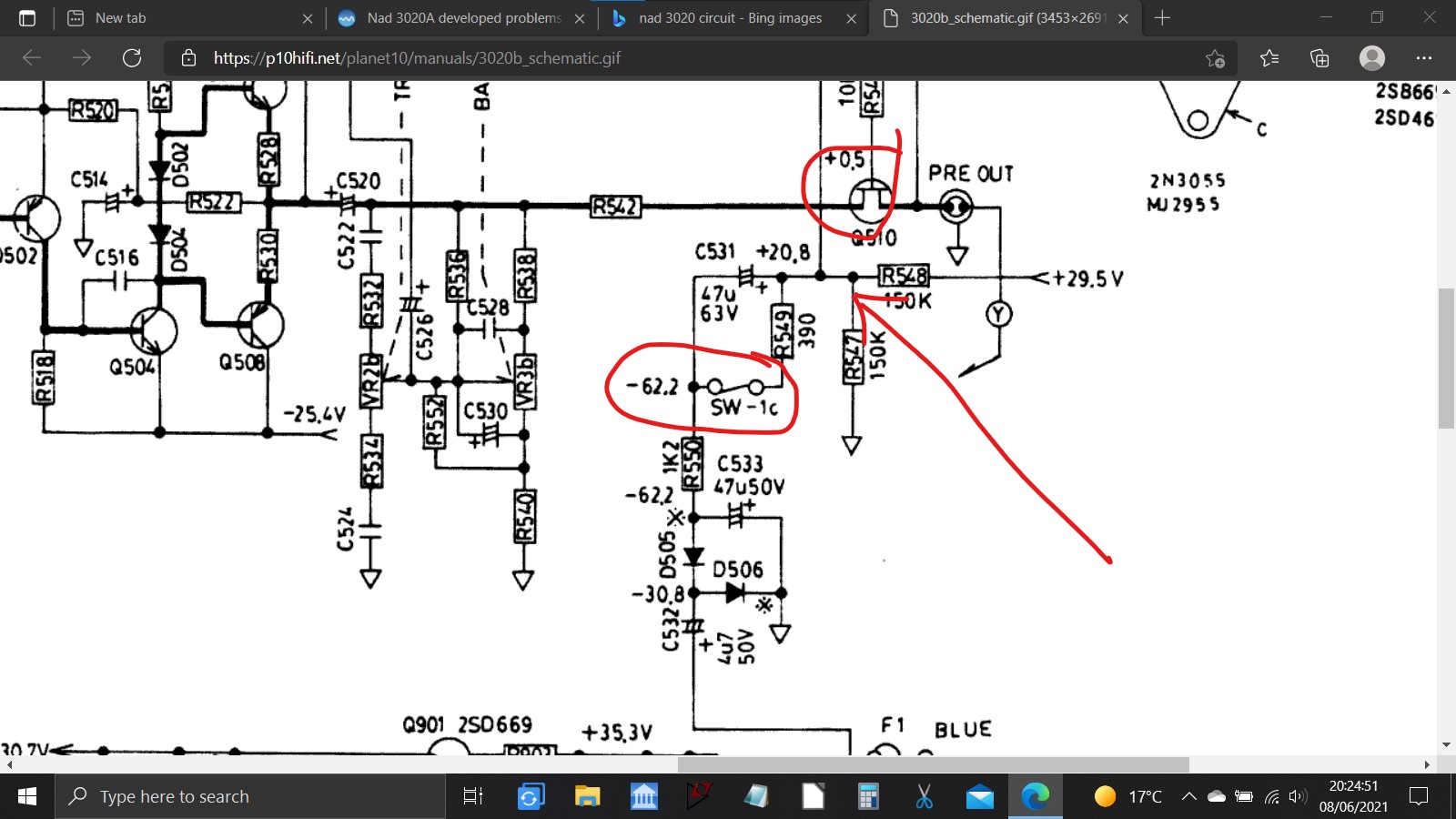

Hope this makes some sense. The two diagrams show the control voltage to the FET's.
The first has the switch disconnected and the second has the switch action in circuit (simulated with a transistor) The green trace is the AC from the transformer feeding the negative rail generator, the blue trace is amplifier positive rail voltage and the red is the control voltage to the FET's.
At 30 seconds into the run the power is removed. The supply voltage for amp the slowly collapses and the control voltage in the case of no switch also collapses slowly (so no mute). With the switch and the control voltage is instantly pulled negative thus muting the audio.

Mooly - thanks also for the additional LTSpice examples - I'd been wondering how the switch function could be easily incorporated into the simulation... turning ON was straightforward, turning OFF less so (I haven't used the PULSE option before) :up:
I think to protect the switch contacts from dumping the (oh hum) 'large' discharge current from the cap. It would be enough to pit the contacts over many operation... but maybe that would have helped the switch in other ways 😀
