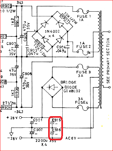

A quick test in the case of your circuit would have been to measure the volt drop across each of those two 1k2 resistors. Because they are in series then volt drop should be identical across each one. That hold true no matter what other fault there might have been.
So if the cap was removing the bias current you would find R902 would have much more voltage across it than the other one.

According to the schematic the earth point for the centre tap of the winding for the regulator section is not local.
If there is resistance in the centre tap earth path perhaps due to bad wiring or a dry joint what happens to these 47uF capacitors with suppression capacitors C903 and C904 sitting between the secondaries and connecting to the earth line.
Those caps are just across the secondaries for suppression of the bridge.
Even if there were an open circuit in the grounding somewhere, the 1k2 resistors would limit any current flow in the 47uF to about 25 to 30 milliamps peak at a guess. That would be a worst case scenario assuming the reservoir caps were out of circuit as well.

there is a grounding tap on this boardAccording to the schematic the earth point for the centre tap of the winding for the regulator section is not local.

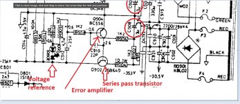

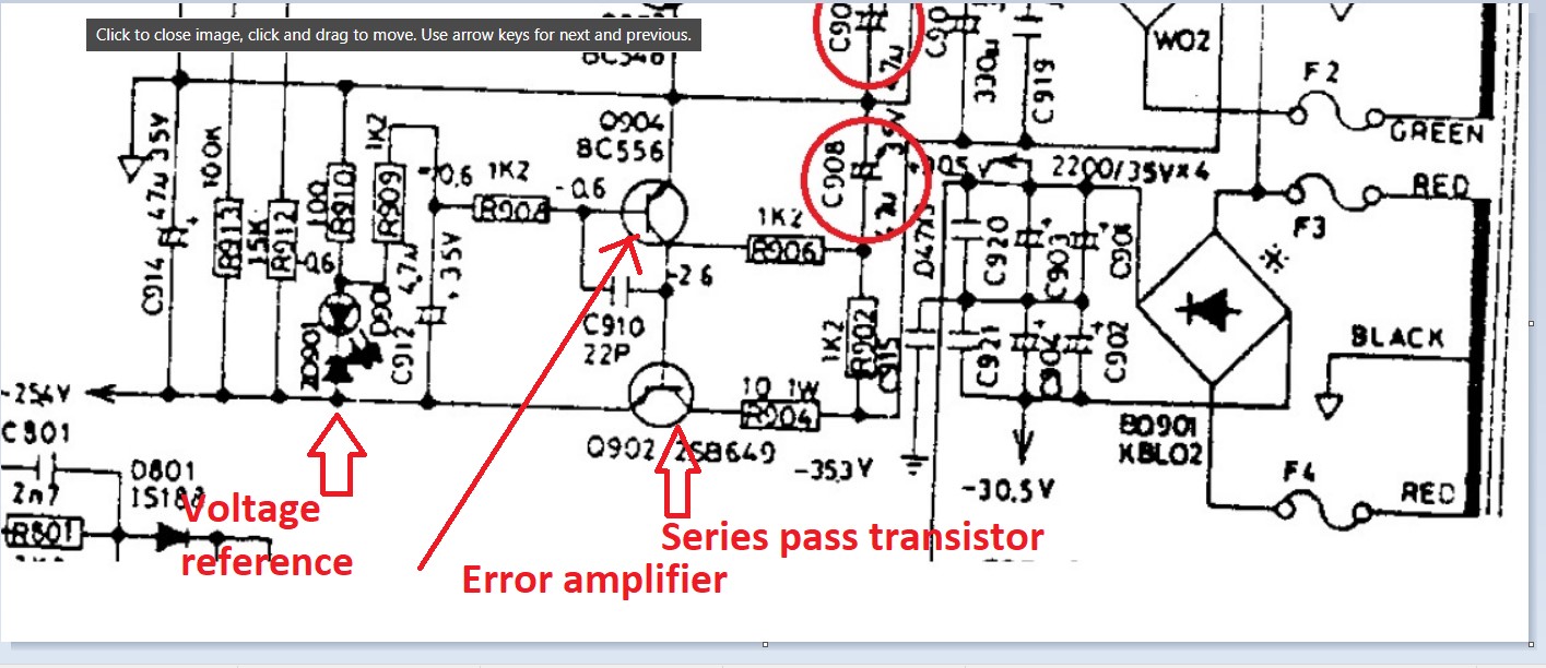

The regulator is really the whole of that circuit but you could break it down and say it consists of a top half and bottom half. The bottom half is the negative regulator and the top the positive regulator.
The negative one is important in this configuration because the output of the negative side is used to provide a reference for the positive one.
It is called a regulator because the output voltage remains constant even if the input voltage varies and also if the load current varies.
