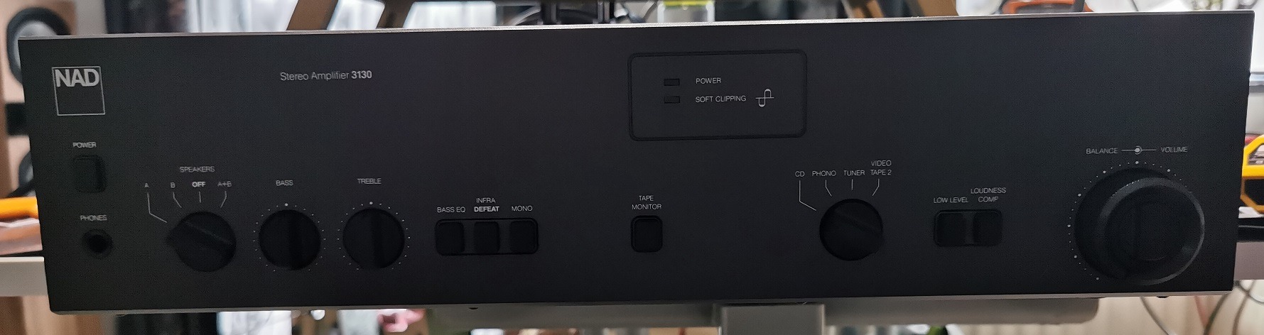

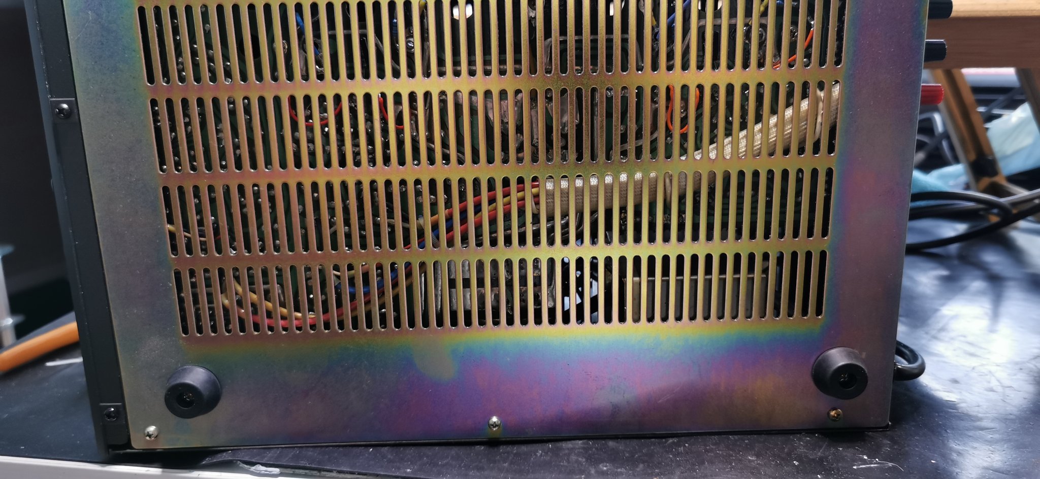

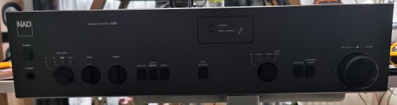

so all finished

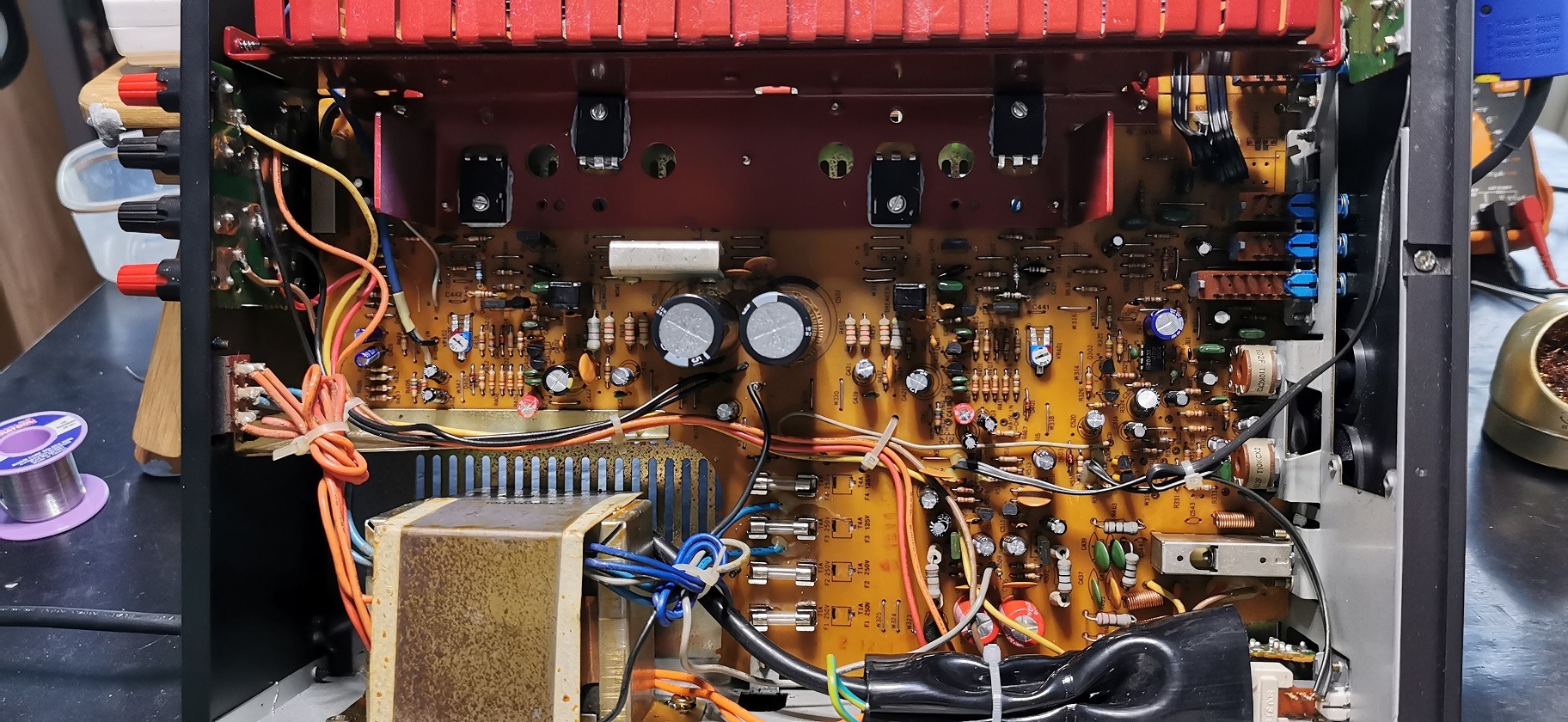

I tested a standard 3130 this morning and found it started to hum at around 100ma of current, and didnt want to take it any further , they heat up pretty quick at this value, so i am assuming its a design thing, a standard amp would only be run between 26-30mv across the 1 ohm
anyway so i settled for a non audible 45ma of current and put in fixed resistors instead of the trimmers
so it sounds realy good and im going to swap it over with my current amp (the 3020 soft clip mod we did) to enjoy it for a while
The soft slip conversion always had a buzz on one channel so i need to find that
so there you go all done and back together with a new set of feet on the base 👍

I loose track of where you are up to with all these, so is this one a FET conversion or standard bjt? Those look like new FET's in the images.
A standard NAD that hums if the bias current is turned up suggests perhaps poor PSRR (poor power supply rejection ratio) and that ripple on the rails, which will increase at higher bias currents, its getting into the audio chain somewhere.

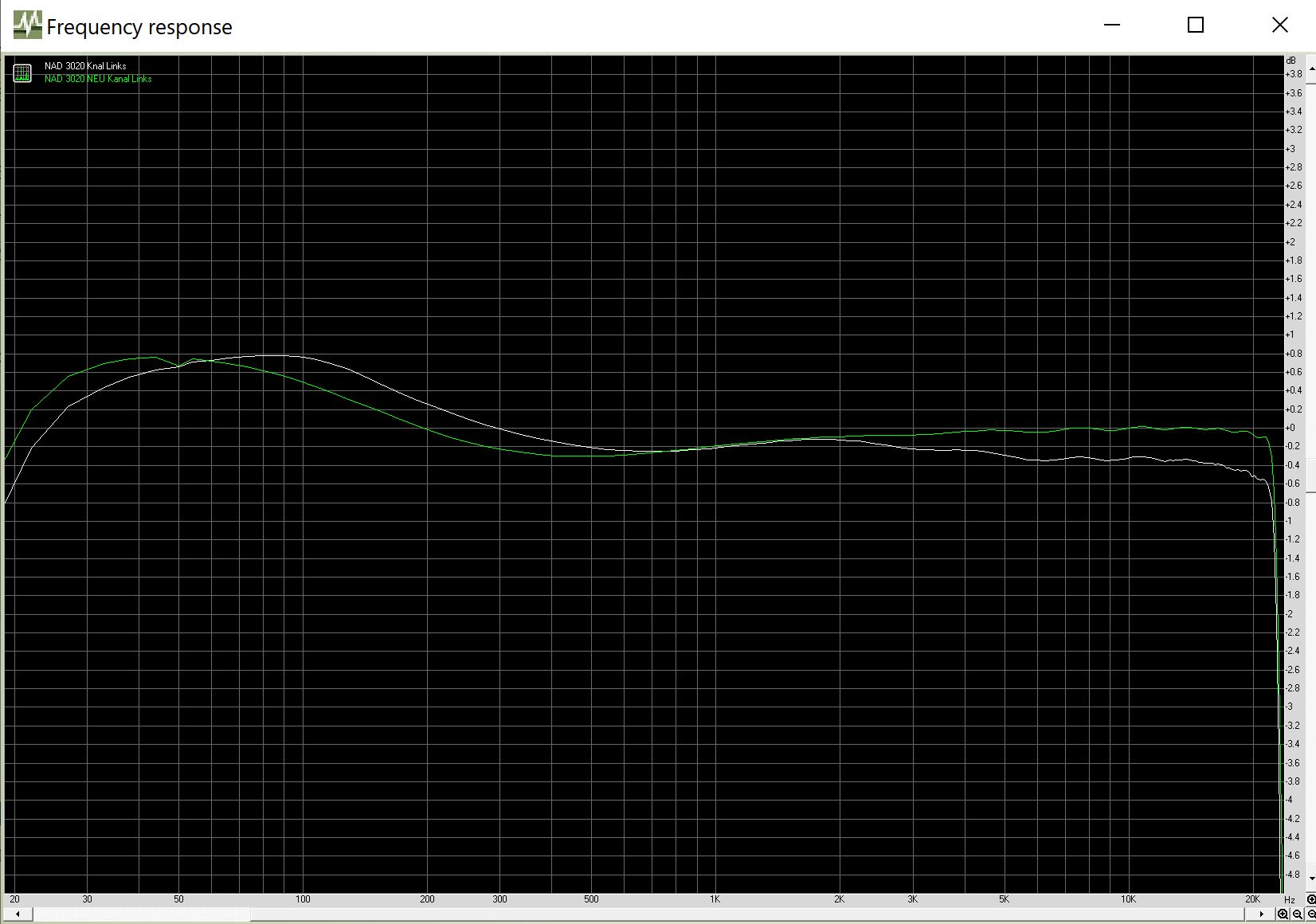

That's my experience also. It's caused by the recap. I recapped all elcos in my NAD3020 and replaced all elcos in the range from 0,68 uF to 4,7 uF with WIMA MKS Types (the small red ones). All elcos are new Panasonic FC now.well i think its better than the original, but that is my opinion
IT is certainly brighter, better treble top end
I measured the frequency response with the RMAA program before and after the recap. The green line is the new result.

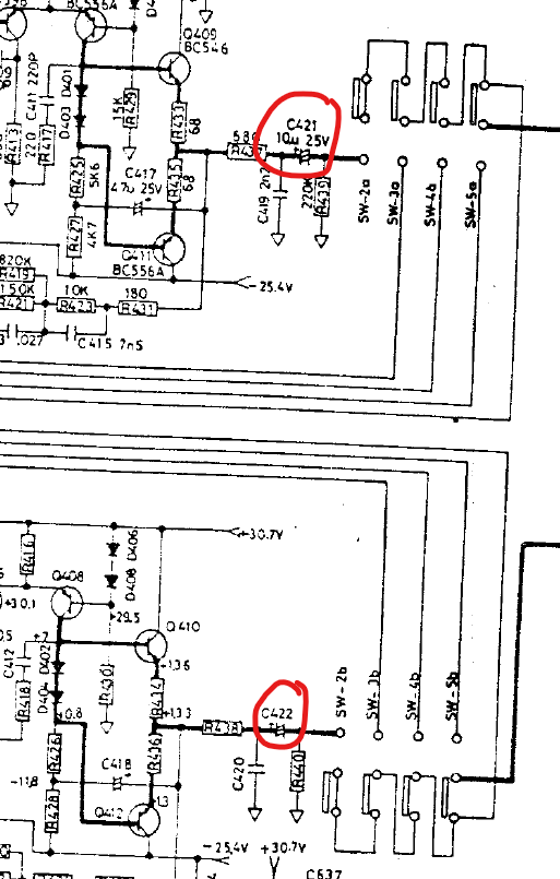

@poundy, can you please help again.
Can you tell me the values of the capacitors on the picture marked with yellow circles?
I cant read the values on the board very well. I pulled 10uf caps out of the bottom yellow circle but dont have enough 10uf caps in the kit. So I am guessing 10uf isnt the original value.
Thanks in advance.
