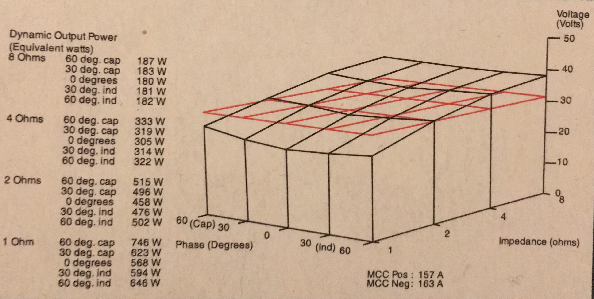

Down below a pic from Swedish Hifi&Musik nr 1-2000 when they tested this amp (and 116 pre) and did some measuring. Very powerful in my eyes in standard config 6x4700uf)

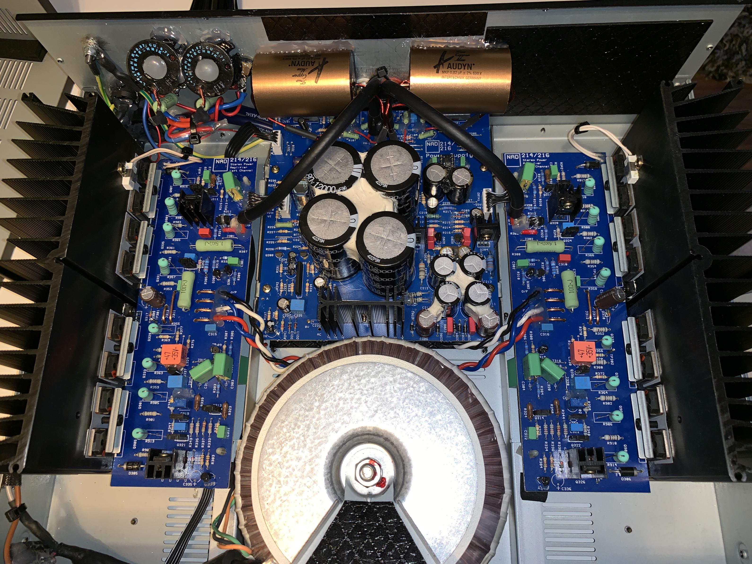

Then i took a pic of my amp and it’s manufactured 1994. Later in -95 the ”Holmgren” or ”Hölmgren” sticker came to stay on it.
Listened to it now for maybe 10hours and quite impressed. Good 3D, relaxed and powerful. Little laid back english ”soft” sound. Treble feels a bit coloured and ”electric”. Bass a bit too swampy. Mid is open and airy. Best part with this amp..

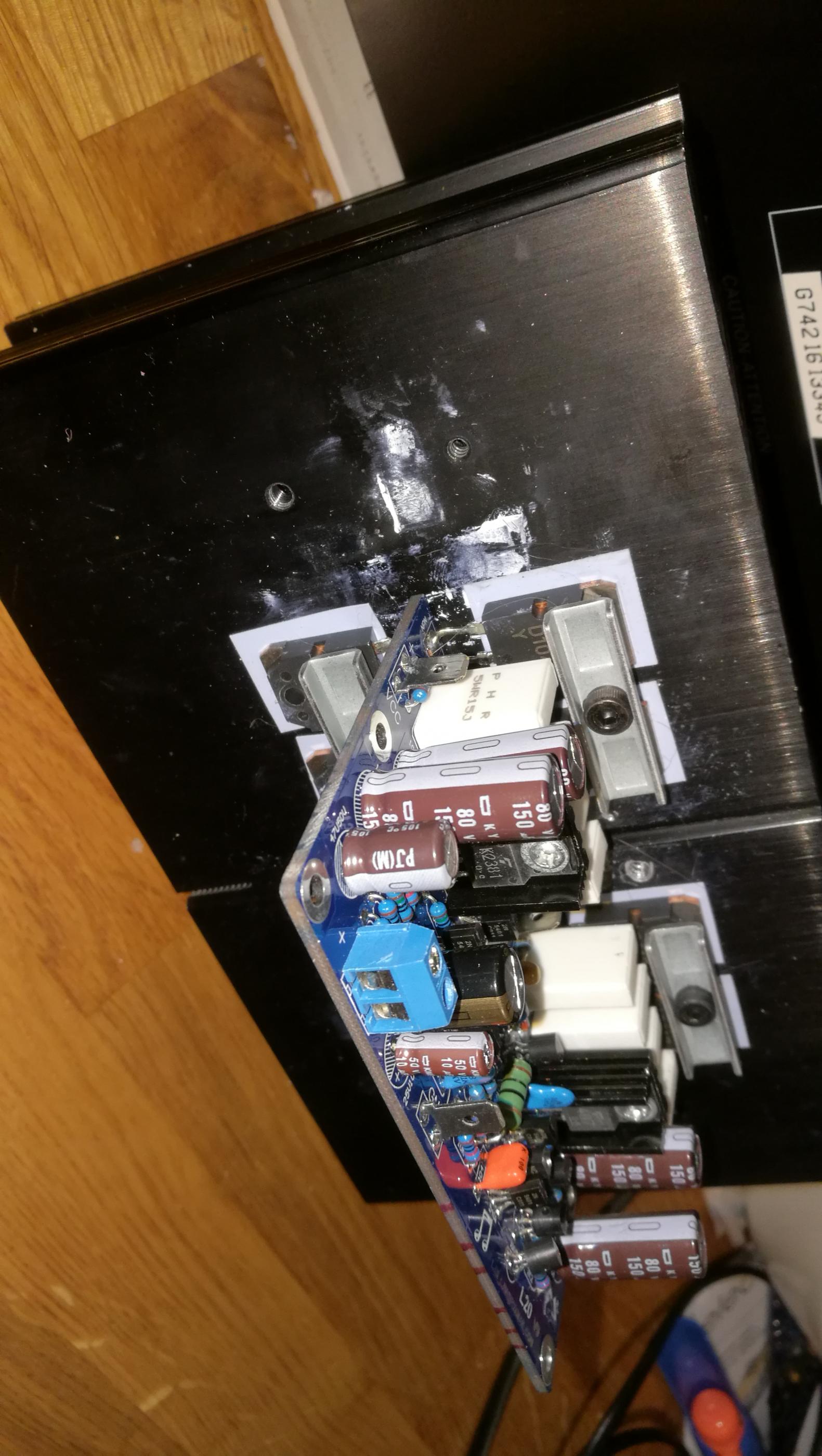

I am rebuilding my faulty 216 with L20 V9 DIY kit using the transformer and some other parts. My primary results are quite good since the transformer is delivering a lot of power. I had to make some changes and add 2 Fans 12 cm in order to matain the temperature low.
The fans will be controlled by 9 V (With a LM7809) in order to keep a very low noise level.
I will publish some pictures in a couple of weeks, but you can see a small part now in the attached picture. IMG_20171213_215918.jpg[/IMG]

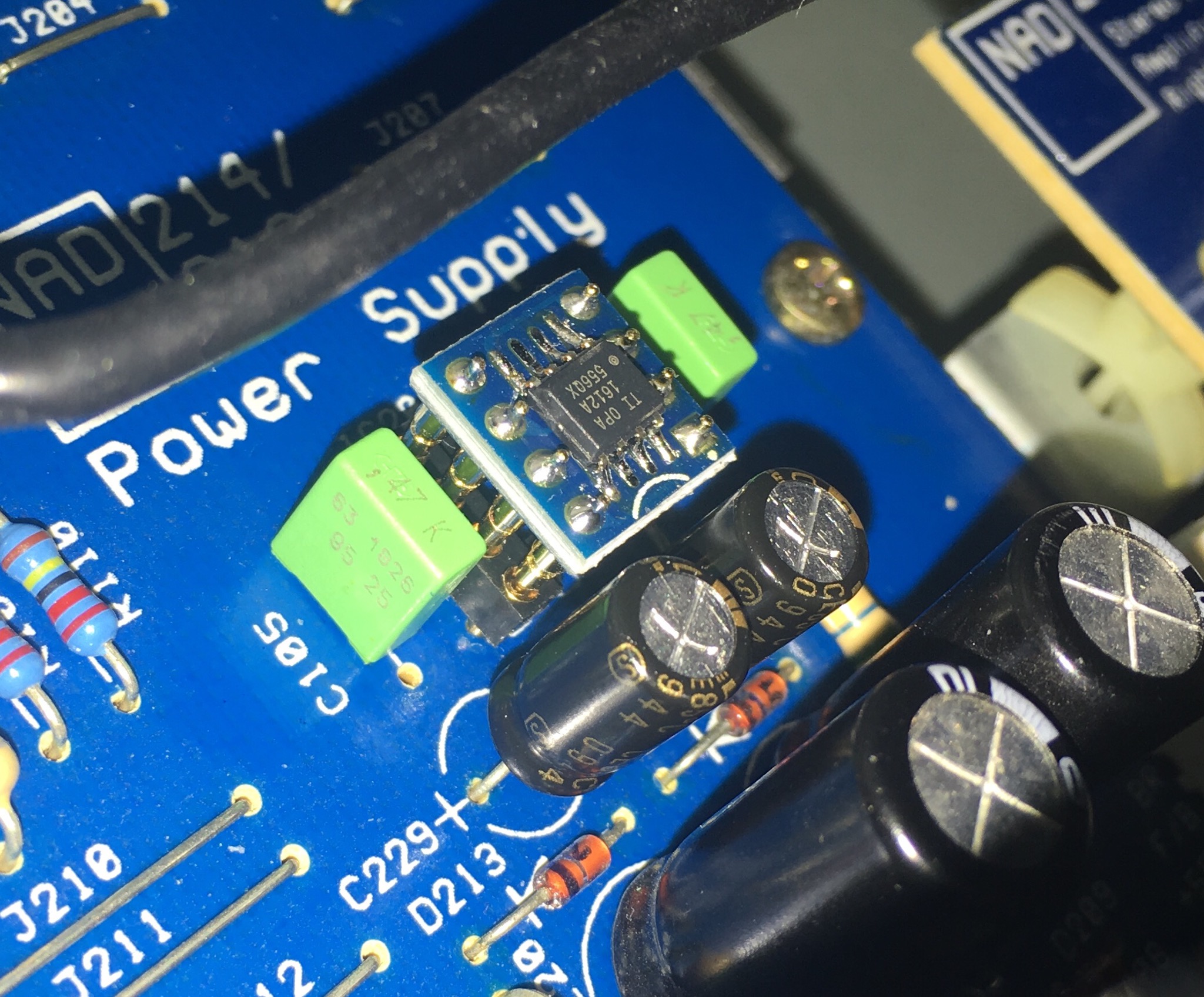

I don’t know if my ears playing with me but i hear a quite big improvement by changing that op amp to OPA1612... feels like level is up atleast 3 db, more hard hitting bass/dynamics better and the whole upper freq. is more smooth and resolved.. now i fon’t skip songs so often for some reason like before.
Yday i changed relay, inputcaps (to Ero MKT 1826 cuz i had them) and 0.01 ceramic to transformer (Wima mkp x2). I think that didn’t do as much.
Overall that little coloured treble and tucked in “english” sound is not so present anymore and i like it. Very open mid now.
Replaced also some other caps near the protection ic

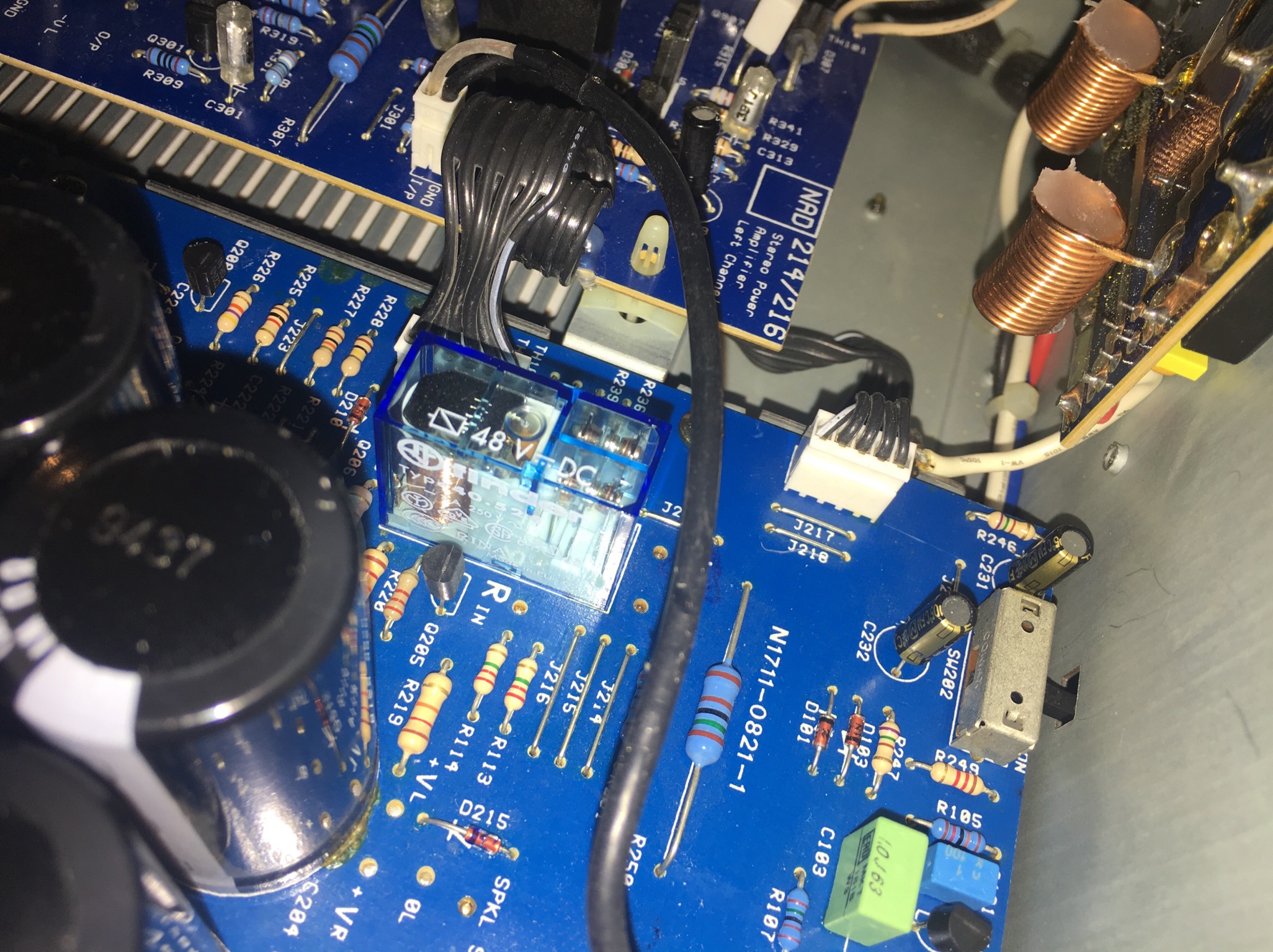

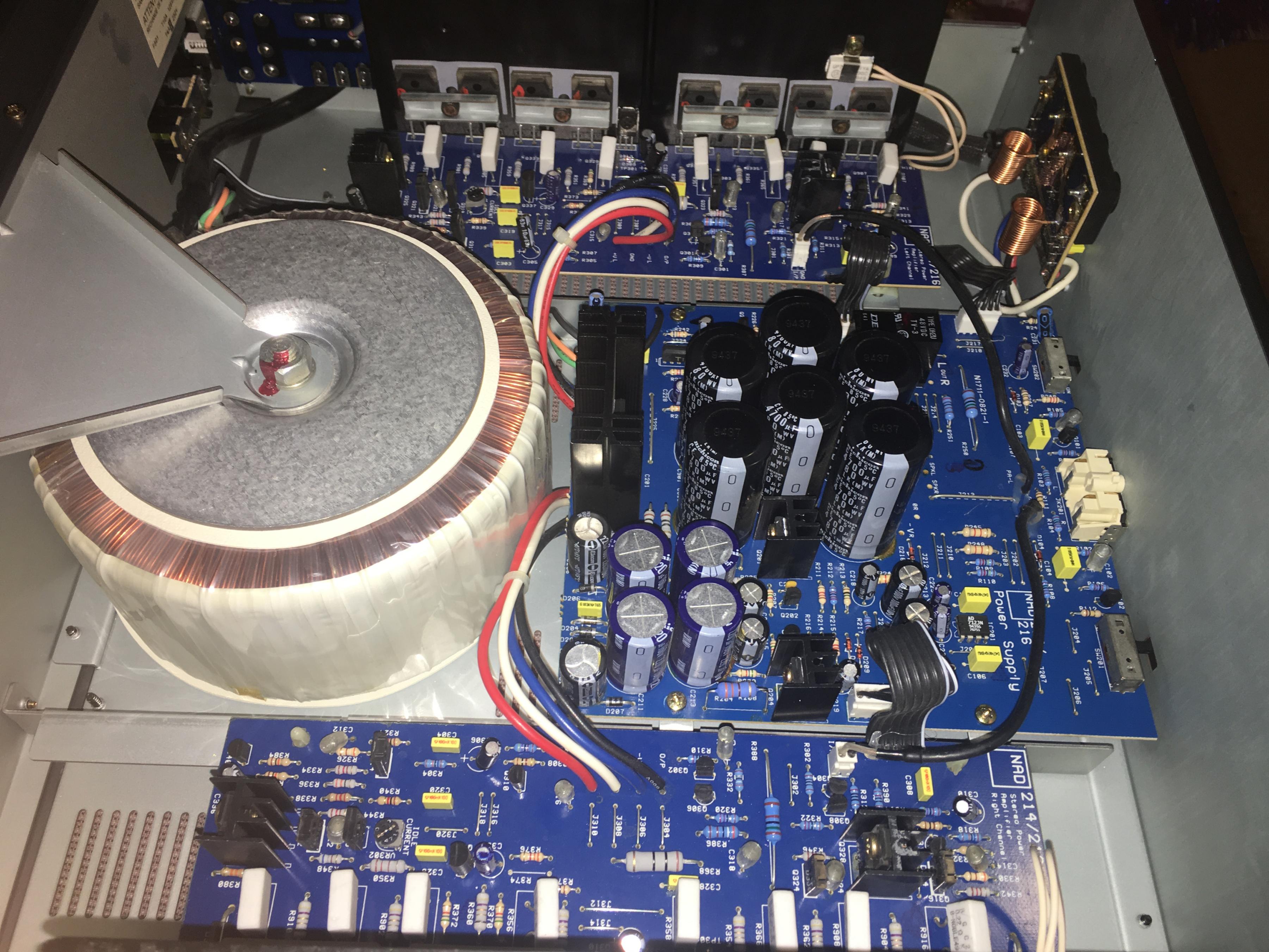

Sorry if this somehow hijacks the thread, but people also mentioned improving the 214. So. I am fixing my 214. Sometimes the sound at one channel disappears during silent passages. Moving the soft clipping switch back and forth fixes this sometimes.
I think the problem is with the relay, and that moving the switch simply causes movement to the board and that helps it. I'm getting a) new relays, b) new main caps (the 4700 uF ones), c) new secondary supply caps (the 160 V 220 uF ones) and maybe new switches for bridge and soft clipping.
I am not into upgrading the main capacitance to an immense amount. I think adding a third pair of 4700 uF is enough. The caps are 22 mm in diameter and 50 mm high. Nichion UVY1J472MRD are a perfect fit.
For the secondary power supply I will have Panasonic EEU-EE2C221S. These are 160 V 220 uF, 18 mm in diameter and 25 mm high (the originals are 35 mm). I heard that Omron G2R-2-DC48 is a perfect replacement for a relay.

I recommend a minimally invasive approach. Replace the relay, clean the switches, visually inspect the solder joints and only reheat those that look bad. Add a pair of 4700uF caps if there is room for an extra pair. Measuring caps in circuit may not yield accurate results so you shouldn't make judgements about the capacitors based on those measurements. After doing the steps I listed, test the amplifier and see if it has returned to full performance. If it has, return it to service and enjoy the music.
Hello
One 214 has now a new relay and six new capacitors. RCA connector and the slide switches have their pins reheated with flux and some solder added to a few pins that looked like needing it. Plays fine.
