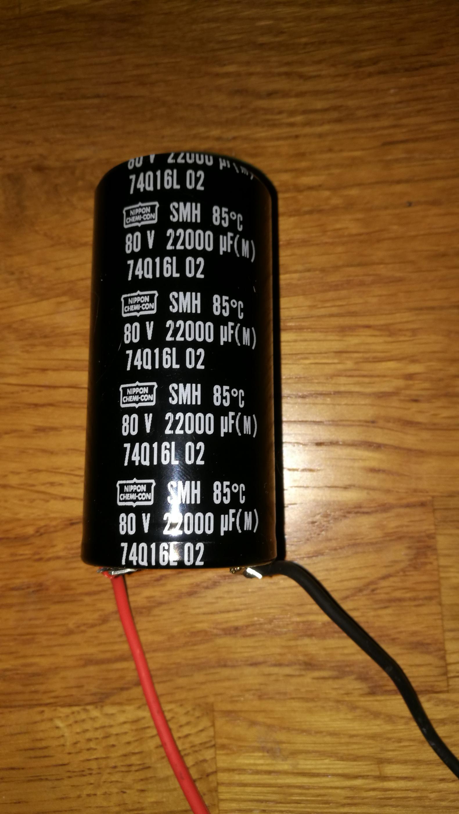

Yes, It was that caps I hade linked to earlier and they were measure to have an ESR of 0.01 ohm. It seems to be the relay that is not clicking any longer. I read something about resistors going bad, but I don't see any looking bad or faulty. However I will start to measure them.

Yes, I did change 6 caps with only 2 big 22 mF each. The improvements are in all frequencies. But it was more audible for me from ~300 Hz to 30 Khz since I drive my speakers with 2 amps. A NAD C272 for the Woofers and 216 THX for the midrange and treble. I have now tested the whole register and an improvement in the lower frequencies are also audible.
I had to make a very simpel wiring from the new cap to just one of the inputs from the old cap.
I could do this since the old 3 caps were connected in paralell. I used 4 wires, but you can also make it with just 3 wires if you conect the 2 caps in serie. Since the power supply delivers + /- 67 Volts.

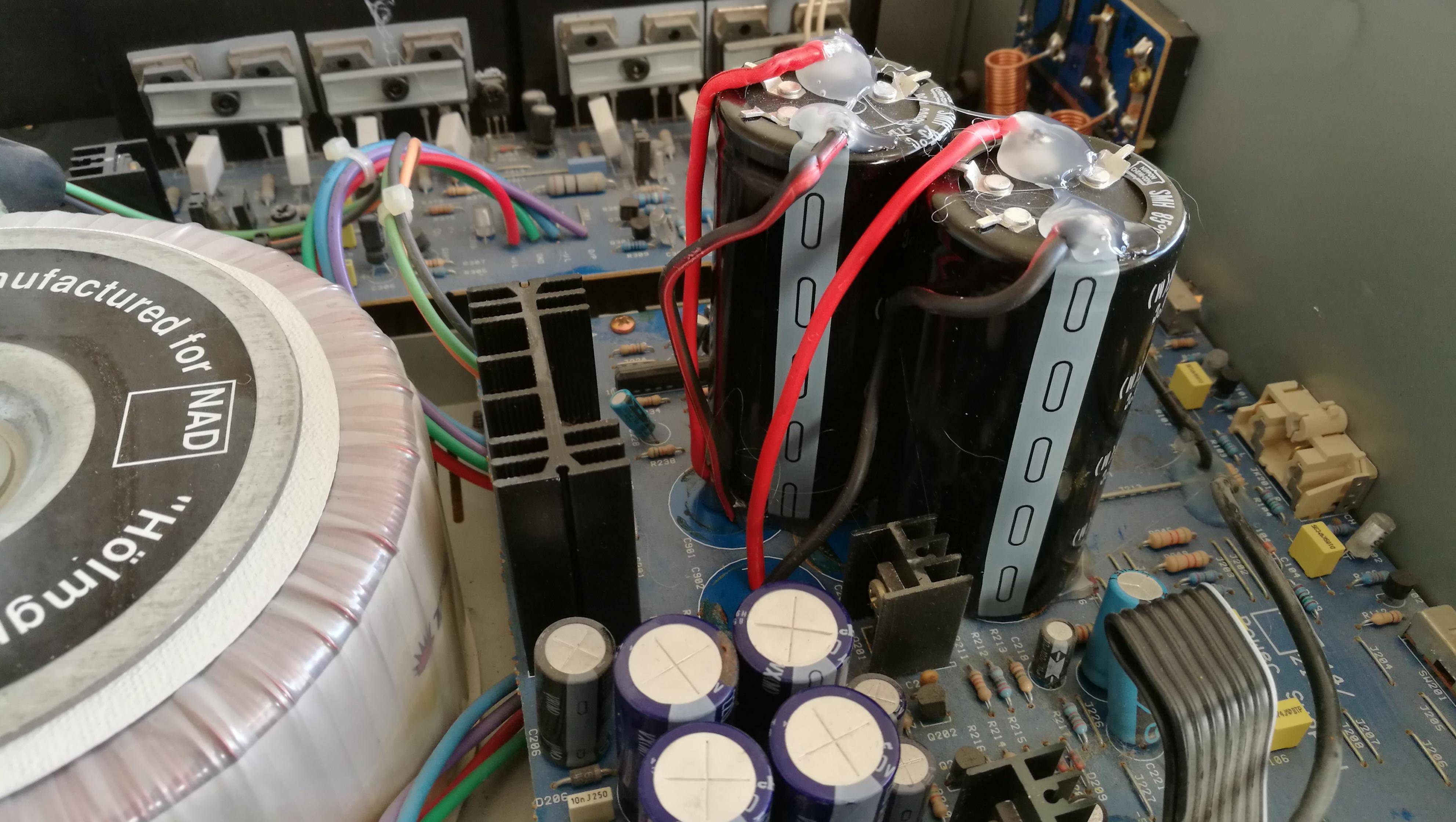

Well, I have been able to isolate the fault to the left channel, but I have not had time to start measure the components.
I attached an image of what it looks like now inside my 316 THX.
Hallå där!
Any reason why you decided to moint them upside down? Have myself a 216 that needs new caps
Well, it was because it will sound much better due to electrons traveling upside down. 🙂Hallå där!
just joking 🙂
The main reason is that the caps don't fit on any holes on the PCB. So I decided to glue them. Mechanically speaking the top surface was better to be used due to being flat.
The contacts are also glued for electrical isolation. just in case.

From page 86, Nippon Chemicon catalog E1001Q:
• Provide the following adequate clearance space over the
pressure relief vent of a capacitor to avoid blocking the
correct opening of the pressure relief vent.
Case diameter Clearance
φ8(6.3) toφ16mm: 2mm minimum
φ18 toφ35mm: 3mm minimum
φ40 mm and above: 5mm minimum
• Do not locate any wire or circuit pattern over the pressure
relief vent of a capacitor.
• If a capacitor is mounted with its pressure relief vent facing
down on the PC board, provide a ventilation hole in the
board beneath it to let gas escape when the vent opens.
The vent is usually on the top surface of the capacitor. Mounting the capacitor upside down blocks the top surface completely. If a fault causes the capacitor to vent, a violent explosion would be expected if the vent is blocked.

It was something of my concern when I decided to make this changes. And I took the risk.
However I will follow the precautions you mentioned.
