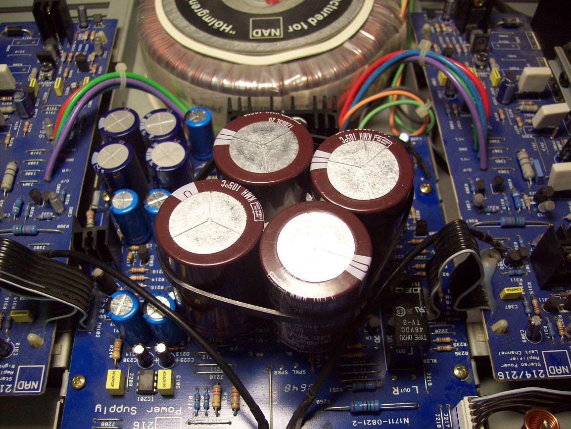

Im back....Your photograph shows brown glue used during manufacture it is not the capacitor leaking.
Can you check the plus and minus 55 Volt rails are present?
Plus 55 Volts should be present on one end of R212 and Minus 55 Volts should be present on one end of R217
If the voltages are present can you disconnect the left and right Amplifier modules, then power on the Amplifier and check if the LED turns green and the speaker protection relay turn on after approximately 5 seconds.
If the LED goes green and the relay operates switch off the Amplifier and connect the right channel module and repeat the test.
If the LED goes red, again turn off the Amplifier disconnect the right channel module and then connect the left channel then repeat.
You should be able to quickly verify if you have an issue with either module causing the Amplifier to switch to protection.
