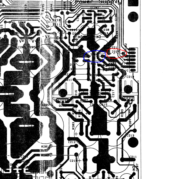

There are two jumpers on the board just below the connector in your picture. One is labeled J227, and I think the other is J228. Please measure the voltage on these jumpers to ground.

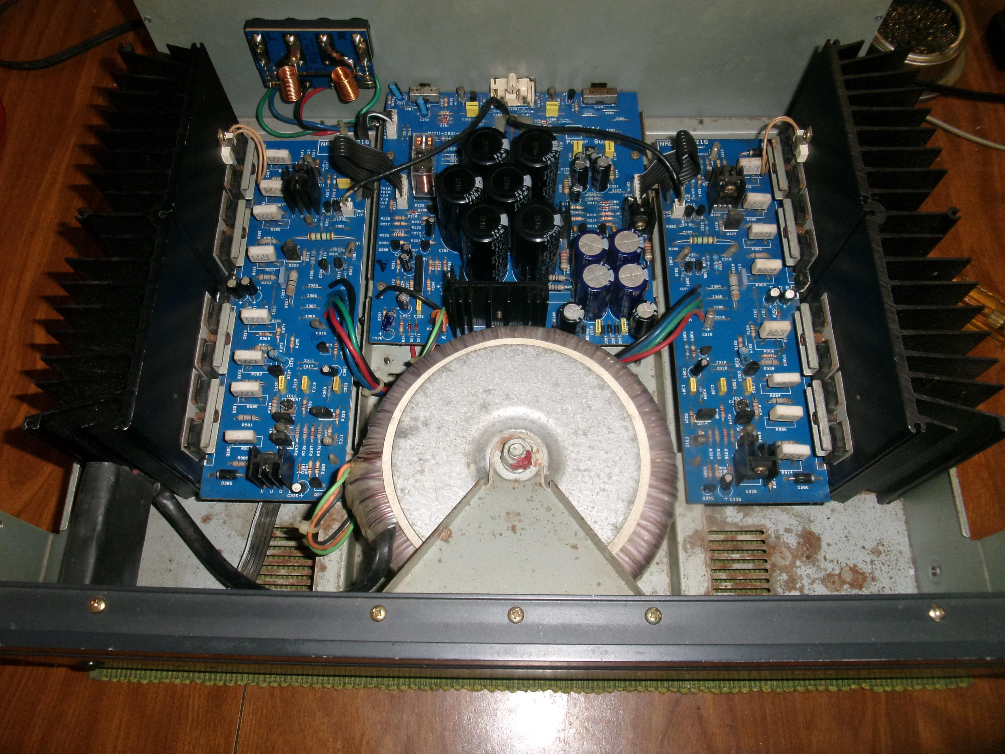

Thanks Sqeek. I don't know why I didn't download the whole manual earlier, I've been working off the earlier posted schematic. Got the full SM now.I thought i would share a high resolution photo of the inside of my NAD 216 if needed
Found a more complete service manual. The resistor I have been calling R206 might actually be R208. Looks like 206 on the schematic, but is definitely R208 on the layout drawing.
With the exception of R206 (and I have probably been asking for the wrong resistor there), those number look OK. Let's look again at the +/- 67 volts busses.
J226 = 153,8v
J227 = 41,3v
So the voltage at the blue circled point (J226) is 158.3 volt and on the red circled point (J227) you measure -41.3 volts.
Earlier you measured the voltage at the collector of Q201 as 105 volts. I'm at a loss to understand how you can have 105 volts at the collector of Q201 and 158.3 volts on the emitter.
