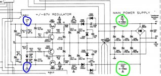

You can start buy checking the voltages at the 4 red circles i marked on the schematic

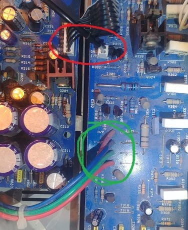

got 60v at green circle on both left and right channel but nothing at red spot. Between what do i measure that +67v ? and one more thing, i cant set the idle current, got nothing there on either side.
dc offset, measure between RL201 point and on o/p at the ribbon cable or?

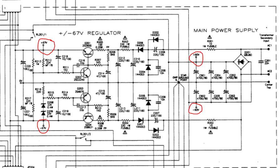

The +60v and -60 volt is supplying the amp boards with the correct rail voltage
Now you need to check the other two voltages that is the regulator circuit the +67vdc and -67vdc volts you need to check them at the points i circled blue on the schematic on one leg or R212 and the anode side of D209 work off of the schematic i have marked there places in blue
If you don't have the correct voltages or only a good voltage on one side you have to start checking componits on that side of the regulator circuit. on my regulator circuit i had some bad/shorted capacitors.
You can start by checking R201 and R202 they are 1 watt 10 ohm fusible resistors i have marked them on the schematic in lime and are the start of the voltage regulator circuit. ''make sure to have the unit unplugged when checking the values of these as they are fed with AC voltage''

ive measured +-67 voltage and i did get 85volts (on pin on R312 side and the other on D209) before doing this i checked the diod and it showed almost 700 on one side and over 1600 on the other side, wich should mean its broken ?

The voltage +-85vdc is to high in my opinion. the two diodes D208 and D209 are zener diodes.

With the black lead of the voltmeter on a good clean chassis ground use the red lead and measure the DC voltage at +VL and -VL wires on either of the power amp boards. You should read about +60 volts and - 60 volts on the +VL and -VL respectively.
With the black meter lead still on a good chassis ground, use the red lead to measure the DC voltages at pin 3 and pin 6 of JP203 or JP204. Pin 3 should be -67 volts and pin 6 should be +67 volts.

Check voltage on the links right infront of the Red, Green, Blue and I think Purple from the PSU board. That is straight from the PSU before any other protections. A 216 should yield +\- 67Vdc. Anything lower and we need to find where that voltage drop is

The schematic for the NAD 216 shows a +/- 67 volt supply. I'll assume this is indeed a 216.
Please measure and post the voltage at:
Cathode (banded end) of D206
Anode (unbanded end) of D207
Collector of Q201
Emitter of Q201
Collector of Q204
Emitter of Q204
Make these measurements with the meter negative lead on chassis ground.
