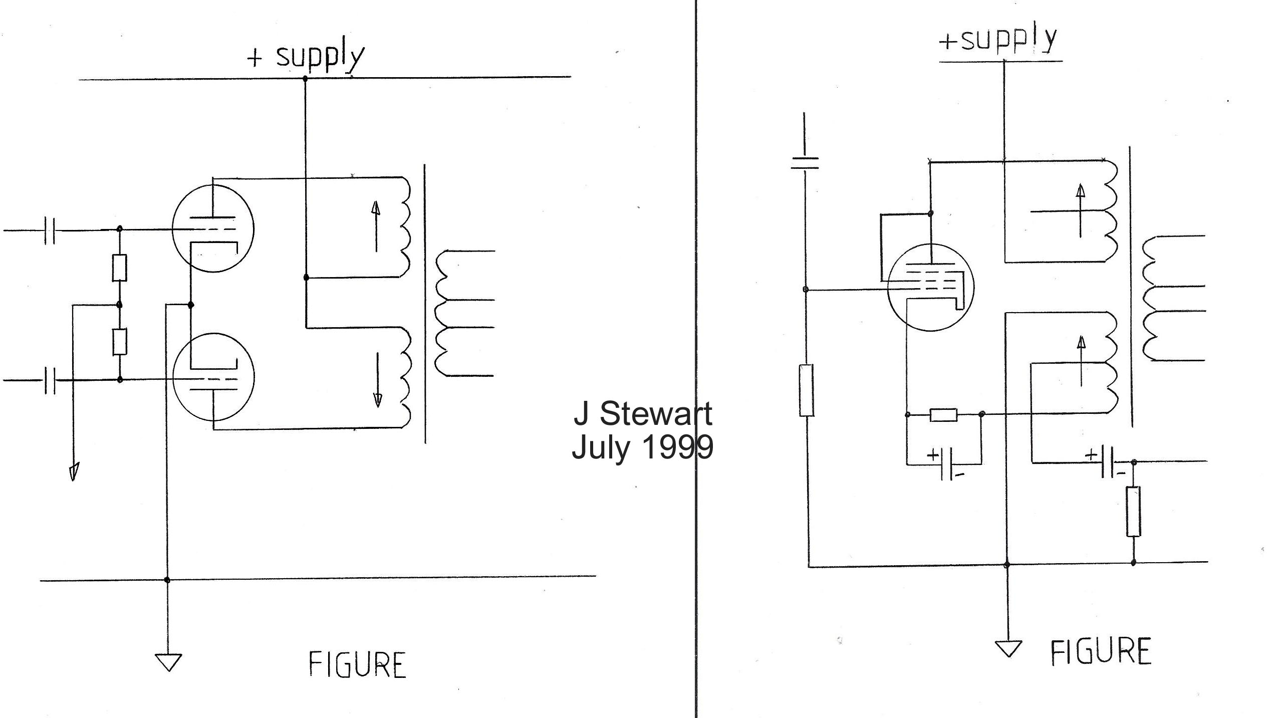

Current Path Normal PushPull vs Split Load
This should help those with trouble comparing the competing OPT hookups to a double wound primary OPT. My very olde hand drawn thing before I got Electronics Workbench.🙂

The McIntosh (published 1949) predated the Crowhurst. I'm not sure about the Circlotron. But these are all deeply related. All can also be arranged for 50% "ultralinear" a la jhstewart, a big advantage with sweep valves' G2 ratings.

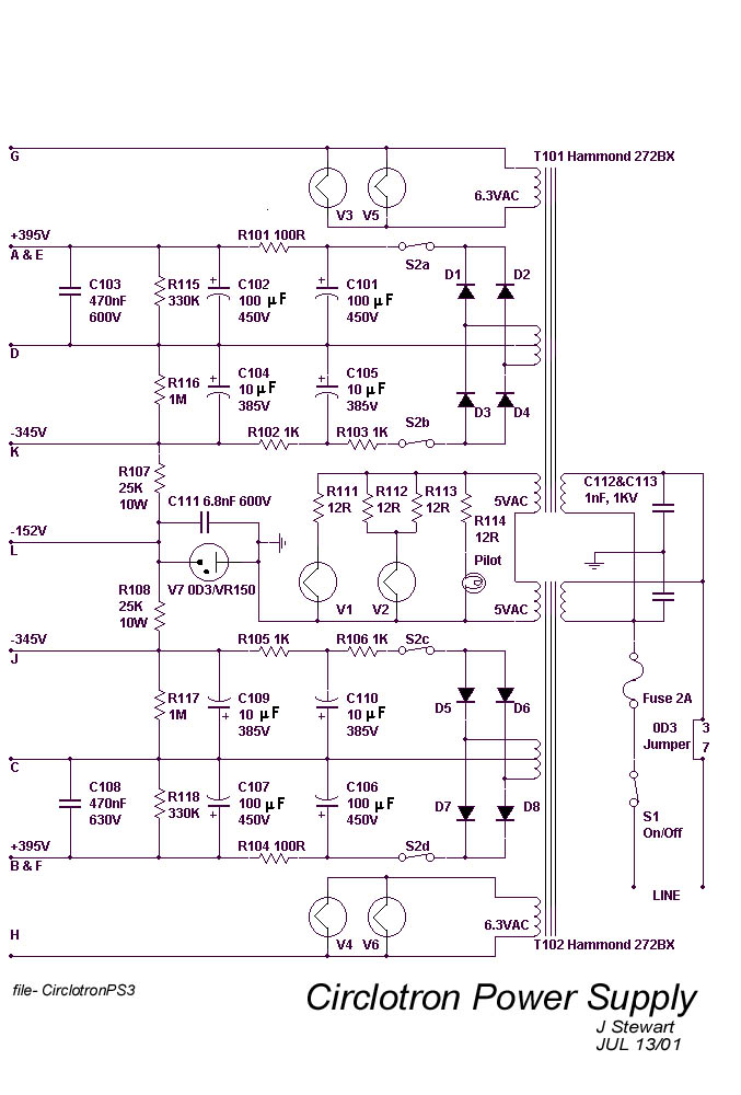

For the 50-watter class, not a lot of extra effort is required to use equal B+ and B- supplies, keeping them each to less than 625 VDC. Still a lot, but there it is. Full wave bridge rectifiers from a center-tapped secondary do this naturally.

For my take on the Circlotron/Electrovoice cct I did use two OPTs as one of three alternate OPT arrangements. I reasoned since two Rs or two Cs could be paralleled for lower impedance & higher power handling, why not parallel two OPTs. So I used a pair of Hammond 125Es on the 6L6GC vers of the amp. That worked OK, no laws of gravity where broken or otherwise.🙂
That one done around the same time as the two Norman Crowhurst Twin Coupled projects.

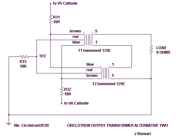

For the amateur builder of the Circlotron, the OPT is a problem. The OPT impedance match is one forth of what the normal PP connexion is. For example, a common mode of operation for 6L6GC’s is 6600Z, plate to plate. That means the Circlotron needs an OPT of 1650Z. There are OPTs of that impedance match but they are very large & expensive. An easy way out for a ‘one of’ build is a pair of low cost ordinary OPTs. I already had a Hammond 125E in my stash so I bought another for the project. But for experimental use I also bought from Hammond a made to order OPT (H300767). That way, considerable measurement data could be had.
Referring to the hookup for the pair of H125Es, each OPT sees a load of four ohms. So four ohms connected across taps 1-5 reflects 2800Z to the primary. The pair of H125Es present a load of 1400 ohms when connected in parallel. I’ve also reversed the respective primary & secondary lead connexions in order to cancel winding capacity to core imbalance. Refer to the note covering that issue.

It was unlikely I’d find on the market a single power transformer with all the windings required for this kind of project. An identical pair of Hammond PTs was the way forward. That arrangement allows all the tubes to be connected so that none are stressed by H-K insulation problems. Refer to the schematic.
Notice many 10R & other like resisters in seemingly odd places in my schematics. That is a holdover from my time in the R&D lab, a convenient way of measuring conditions in a working cct. Very handy & saves considerable time. And might detect a problem before smoke appears.
I’m a strong believer in lots of measurement data, what works & what doesn’t. Some results are in the attachments.🙂

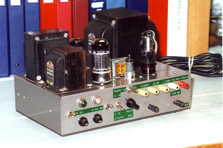

OK Chris, for sure I'm a Geezer at 87. Still driving but gave u the bike two years ago. But I meant I did the Circlotron project around the same time as I'd done the Twin Coupled Amps, about 20 yrs ago.
In 1948 my recollection was an 815 hookup up for whatever, IT driven by a triode connected 6F6, just like in the olde toob manuals. The PT was for the 25 Hz power system running in Southern Ontario at the time. The massive changover to 60 Hz came spread over the next couple of years.
That PT has been working in my regulated PS beginning around 1960. Makes it kinda heavy tho.🙂

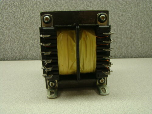

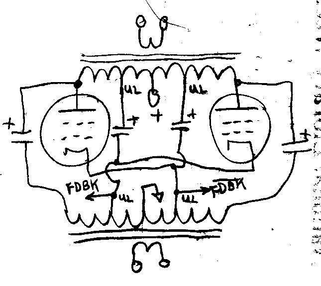

Another solution is to reconfigure the Twin Coupled as the Elliptical Twin (pic below) Then the primary Z stays the same as the xfmr rating (with 16 Ohm secondaries paralleled to form 8 Ohm).
An industrial split bobbin xfmr 230/115 - 230/115 can make a nice cheap floating B+ supply xfmr for Circlotron. (175 Watt model in 2nd Pic)
I measure only 80 pF between the split bobbin windings from side to side in a Stancor TGC175-230 xfmr (175 Watt). And a smaller (43 Watt) Stancor TGC43-230 measures only 53 pF from side to side (good for a floating scrn V supply)
