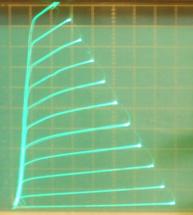

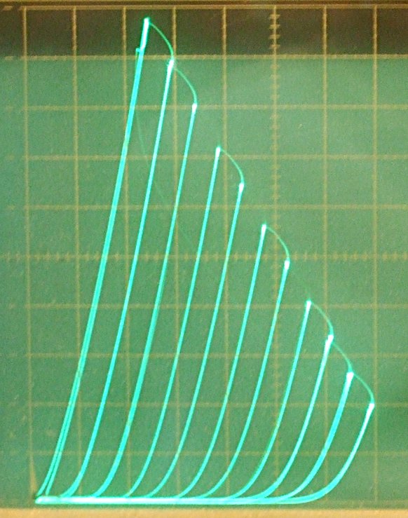

Could use Crazy/Twin drive for a linear V to I driver, but then you are still stuck with driving a grid 2 input for that. Not a whole lot of improvement I guess. (pic 1, 12HL7 going Crazy)
A differential tailed driver (even though for SE) could help linearize the pentode V to I driver.

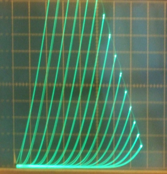

And since some 12HL7 (selected) have a remarkable g2/g1 triode in them (pic 2) you could just move the "shunt Schade" N Fdbk back to one 12HL7 grid 2. Then you don't have any low Z drive problem or V to I linearity problem. Probably make the output stage sound like a 211.
And then... Using Alibaba and the 40 6197 tubes in parallel triode mode (pic 3) (actually more like 16x for a 25 Watt SE, 16 Candles?) one would get curves like a 300B without the shunt Schade" activated, and like the 211 with it activated.

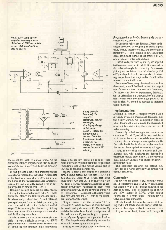

I had thought of using a differential stage with a current mirror load as a V to I converter, like the input stage of a solid-state amp. I think that is one of the better solutions, but I think I may have come up with something better today as I was thinking about this.

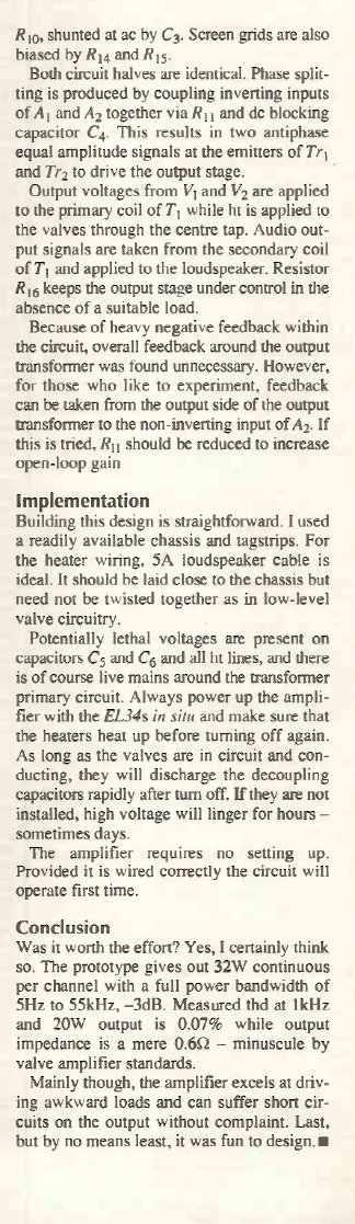

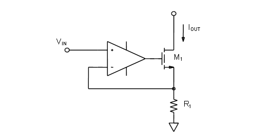

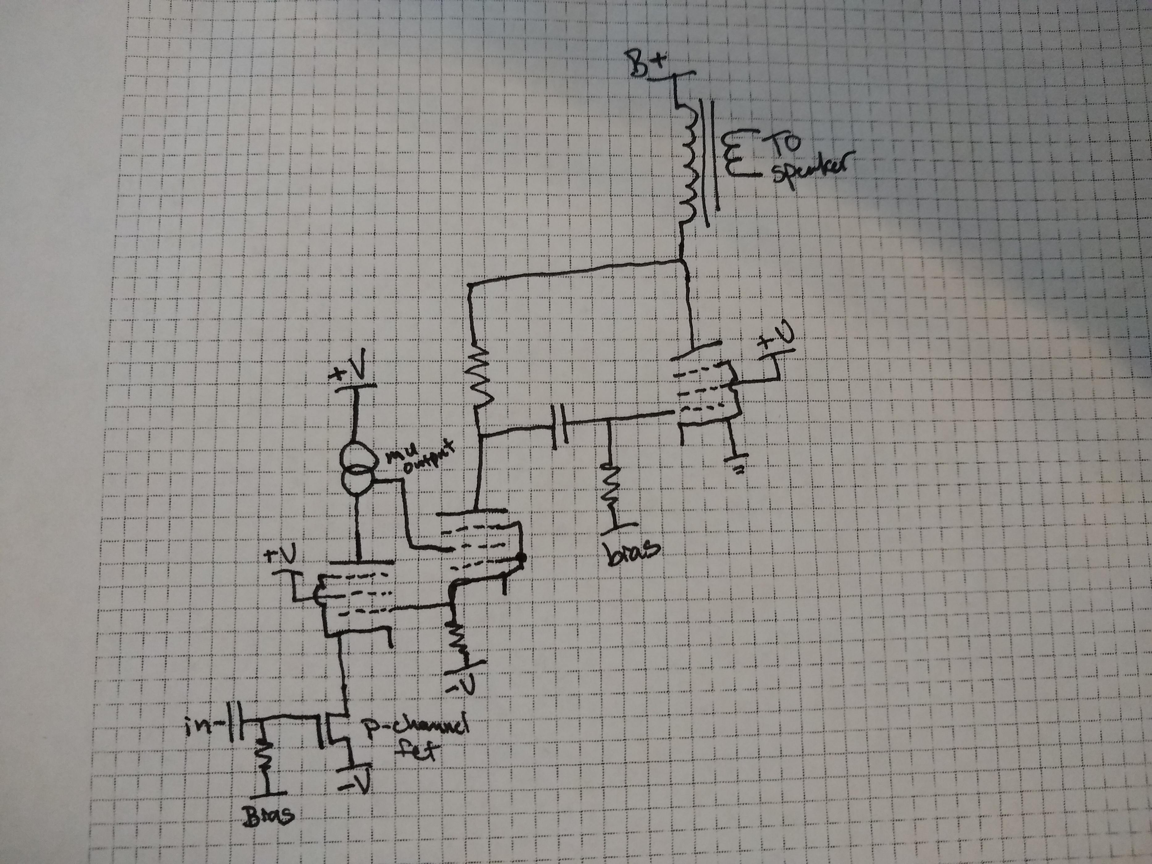

I was considering just using an op amp like the attached image with a tube substituted for the fet but then I decided to try to make a CCS-loaded pentode substitute for the op-amp and see if I could satisfy the DC conditions. I think I found a way to make it work but had to use a p-channel fet. Let me know if you see anything I missed. I think it would be an extremely linear V-to-I converter. I almost thought I was sunk but then came up with the idea of driving the screen of the second tube from the mu output of the CCS, probably best to make that a solid-state CCS for lowest distortion but you could make it from a tube if you just like doing things the hard way...
Wouldn't the screen drive generate more distortion?
Have you tried to simulate that in LTSpice?

Aw man, the screen current from the screen drive on the second pentode is going to mess up the current in the current reference resistor. That won't work.
I'll probably have to replace the second pentode with a silicon device.

The high gain/feedback would linearize but I forgot that the screen current would go out the cathode and add to the current that I really want to sense for the feedback to work properly.
I haven't tried to simulate anything. This is just a half-baked idea from a couple of hours ago. I don't even have LTSpice installed.
If anything, I think I could replace the screen-drive pentode with an n-channel mosfet with lots of source degeneration so that I could get the dc levels right?
jhstewart9, reading that article is what got me thinking about it and wondering how to do it with more tubes. Honestly, though, I would probably do the op-amp and single transistor if I were to build this. It is so simple and I don't really have a problem with op amps.
Having a tube replace the current-drive transistor creates some challenges since that tube has to operate well in a lower voltage region when the output tube pulls toward saturation. If you have a good output tube, that will pull the plate to a low voltage and that's one of the areas where a transistor has a big advantage over a tube. I think you could pick a pentode that could pull it off, but the transistor is going to be much more comfortable in that region of operation.
Replacing the op amp with a pentode also seems like it could work but it creates other problems due to DC idle condition requirements that don't exist in the op amp. Unfortunately, I think it makes it so that the current-drive device needs a positive turn-on and can't draw current, or maybe it could be solved with a more complex way of biasing that device. It's getting pretty complex to replace a very simple solid-state equivalent.

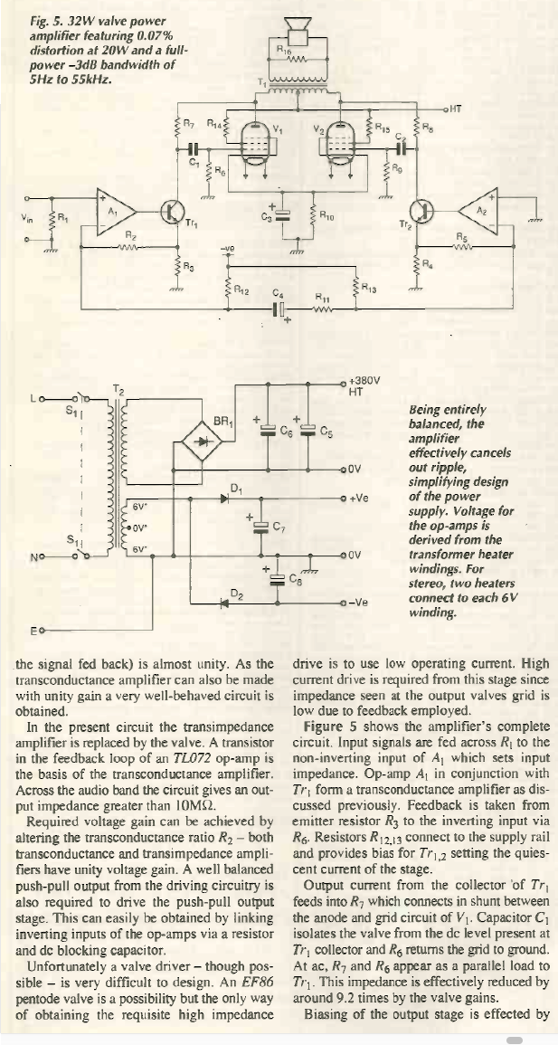

Rest of the Article
A good explanation on these pages. Looks like a way around the driver problem while using triodes or pentodes. There are other ways but this one is very simple & clean.🙂
