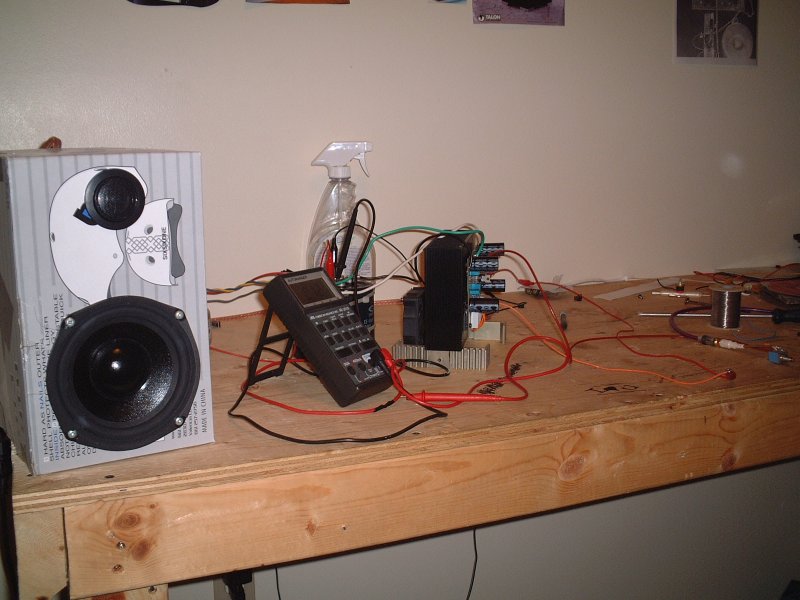

I have 2 problems so far.
One my amd gets hot with no load or any signal input why. i have a new heat sink on it with 1/4 base with 40 finns on it and 3" on all directions.
2 when my amp is on no input but a speaker atached there is a buzz. when i hook up my preamp i get a faint hiss and a litle bit of humm
my transformer is a toroidal 300va 2 x 50v
and 2 x 15,000mf caps @125v
ANy sujestions.

Recheck your bias setting...
Also you have not mentioned if the buzzing is happening in the same amplifier module. If it is then increase the supply filtering.
Cheers
Anthony
