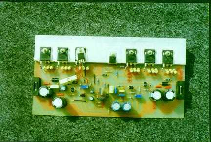

I herein attach a rather crude image of the PCB that I have made for the N-channel amp. The PCB is hand-painted, etched and hand-drilled. Those of you interested can make your own tracks with the aid of some software and use this image as a guide. In order to give an idea of the component overlay, I re-post a photo of a populated PCB. I have emailed these images to Anthony. So soon he should be selling updated PCBs for the benefit of those who can't/won't fabricate their own.

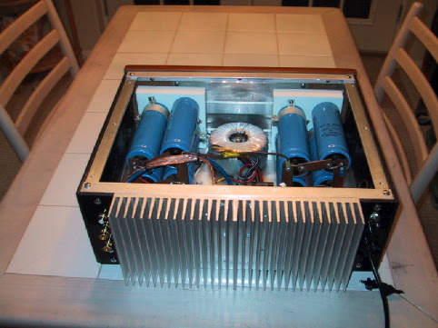

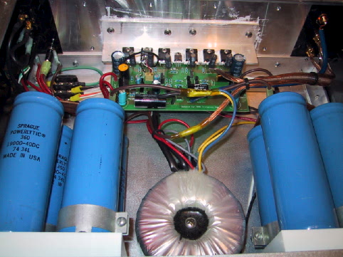

Mono or stereo?
All those big caps in there for just one module 😎 or is there a second one as well that we can't see?:
GP.
GP.
It is mono I use it to drive a subwoofer. I bought the caps surplus for $5 each so I figured what the hell.
