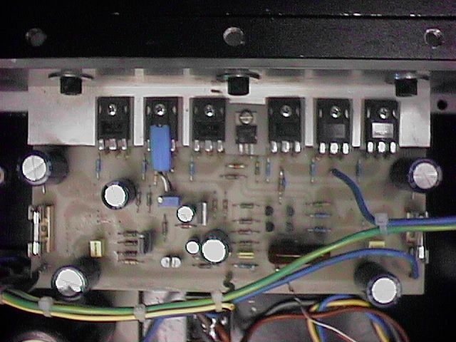

Sorry about that. My impression is that for some reason the gates became driven with too much voltage and failed. Someone who built amp or anyone, for that matter, may have further or better ideas of what happened.

You have mounted the IRF610 Thermal sencing device incorrectly to the o/p stage. Mounting it on top of the PCB like you have done is very bad and you can see the result.
It must be in direct contact with the top of the o/p device and I see you haven't added the Source resistors or the rest of the manatory upgrades, that this amplifier requires for thermal stability.
Please read the manual again, its all in the construction manual.

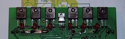

anthony my amp is looking difrent now the reisters that you told me to put on are on now that pic that i posted was just a pic just because ihad a pic of what i had done so far a whyle back. also humm if these transisters have to be mounted ontop of the fet then why did you design it this way..?
cant i mount the fet to the heat sink. the irf610 the bias one. ? the one that controles the bias from heat.

Jason That photo of my amp is an old one as well. However it does have the thermal sencing device mounted on top of one of the fets.
Mounting on the heat sink will work OK, but don't increase the rail voltage. The Gate theshold voltage at higher supply voltages just gets to much out of control, without further modification of the thermal tracking senser.

How do we adjust bias without resistors (ref. the assembly-instructions).
Anyway, I must have misunderstood an earlier post where +/- 95V DC were mentioned, with some other mosfets, - (so I thought that it would be them living dangerous).
Glad I have spare PCB's, finished, all resistors matched to ~0,2%...
I'll just have to redesign PSU, and make better thermal coupling before I try again.

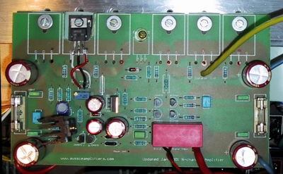

Working!
N-channel, the sequel...
The previous experiment also killed all(!) the 0,33 Ohm (3 x 1 ohm-2W) resistors as well.
So some adjustments had to be done:
2 x New trafos, 2 x 38V gives me +/-55V DC,...updated "modified" PCB, (hacked out for thermal coupling of Q12).
Now everything seems stable.
