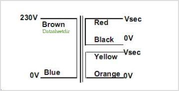

I've connected Nuvotem transformer with dual secondaries directly to the board: Red-White to one channel and Yellow-Orange to another without central tapping, and didn't ground the case. Could it be the reason for relay non-clicking?

It appears you do not have the transformer connected correctly. Is there a web site to look up Nuvotem? Maybe a diagram of how you connected the transformer and some photos of your wiring would help to tell what is wrong.

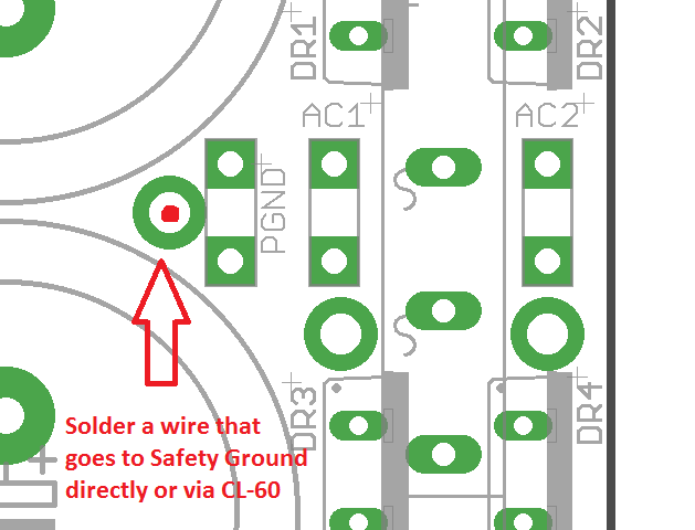

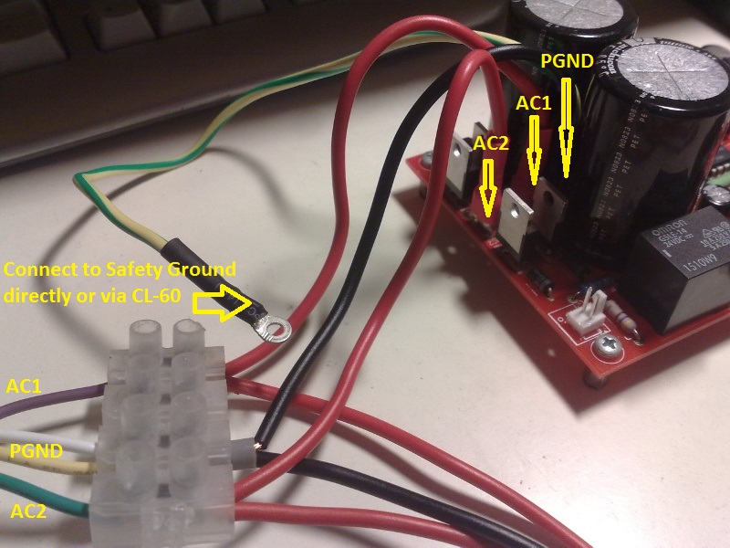

Connect black and yellow together and then to power ground on both boards. Connect the red wire to AC1 on both boards. Connect the orange wire to AC2 on both boards. Power on the amplifier and see if it works as it should.

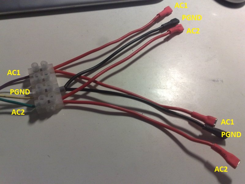

Wire cables as Bill told you then connect PGND of each board to safety ground and make a Y like this one:

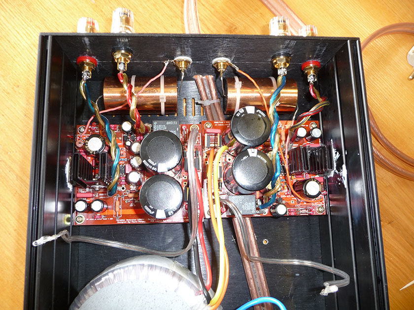

I hope you are not using that speaker wire for 240VAC mains cable.. I doubt that cable insulation was rated for that voltage. Also the hole in the chassis will chafe that insulation in no time. Better off using one of the Neutrik power-conn connectors in that tight spot. 😉
Also the transformer is definitely wired incorrectly as they stated.
