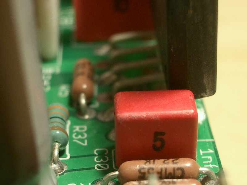

I did't insulate LM3886T from heatsink/box' side. Shoud I do that ? (my box is not specially grounded)

You must insulate the 3886 from ground.
That is why Uriah included the insulating patches. Use them.
Yes...
try to insulate them and try again but probably you fried the LM3886 and possibly the LM318...it could be R11.
If so buy again those parts (buy the already insulated LM3886TF to avoid further problems)
some details: I've soldered LM318 directly to the board, and settle LM3886 as down close to the board as possible (maybe it's not good idea?)
I wouldn't settle the LM3886 too close to the board, leave at least 1-2 mm from the bending of pins.

The LM3886 must, without fail, be insulated by both the insulation pad as well as the shoulder washers. If not you will kill it.
