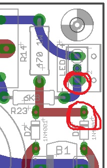

I have just completed building my first pair of rev c kits this evening.( I ordered 4 kits in total.) The Relay is not switching on both boards. The led is very weak. I am using transformers with 22 Vac secondarys.
When I bypass the relay and Jump the negative speaker output to ground the sound comes through, quite beautifully in fact; even on my crappy test speakers!!
I think I will wait to see what solutions some of the other builders report, as I do not fully understand the speaker protection circuit yet. I guess I could just bypass the protection circuit but I would prefer to get this issue ironed out.
Thanks everyone, Ben.
Hello Ben,
try to measure voltage between these two points:
Mine (2x24V sec.) measure 27V
It would be nice if someone with a working MyRef with 2x22V transformer measure also that voltage.
I suspect that your transformer, under load, regulate not so well to a voltage unsuitable for the protection circuit.
Original specs were 2x24-25V but later people found that 2x22V was better suited for a 4 Ohm load but such voltage is borderline for the protection circuit.

My amps from the last group buy use 22v transformers and they run just fine. The protection circuit operates AS DESIGNED. Andrew, if you don't believe that and you want to modify yours, that's fine and we'll be happy to learn the results. In the meantime, however, perhaps you shouldn't go on so much about how the circuit is improperly designed. You might be misleading other builders into thinking that's the problem when it might not be.
If your relay doesn't click, there is probably something wrong with your amp. It happened once to me (out of four total builds) and I never could find the cause. I tried replacing active parts until I wrecked the board from desoldering/soldering. I finally just bought a new board and started over with all new active parts. Worked fine on the first try. It cost a few bucks for the new board, new chips, and new transistors, but it was well worth it. I suspect the 318 and transistors are sensitive to soldering heat, static electricity, and lots of other things, and sometimes they are defective from the start. I can't imagine a passive part failing unless it's overpowered or otherwise abused, or far out of tolerance to begin with. I wouldn't expect that of parts of this level of quality.
Or perhaps it IS a balky relay. I just thought of a simple test for those with non-clicking relays. Since R14 determines the power going to the relay and it's near the edge of the board, it would be very easy to turn on the amp and hold another resistor in a pair of insulated pliers and touch it across the leads of R14. You can do this from the top of the board, without having to solder anything. With a second resistor (what size?) in parallel, it will allow more current to flow to the relay. If that's the cause, the relay should click, the amp should play, and you will know what to fix. I don't think this will endanger any other parts of the amp. Don't endanger yourself, either!

The protection circuit operates as designed most of the time. The capacitors and transistors do have significant parametric variations and the wrong combination of values could cause malfunction in a few cases. This kind of issue might only show up in a few cases of a fairly large quantity build. It's all a matter of statistics.
Parallelling a resistor across R14 is a good idea for test purposes. Try another 470 Ohm resistor across the existing 470 Ohm resistor on the board and see if the relay closes. I don't think the relay itself is much involved in the problems a few builders have reported.

sure it is, a lot of people use with success those 2x22V transformers but some have better regulation than others and this could be a problem...
It's for such reason that I asked to measure that voltage so that we can compare a working one with a faulty one and understand if regulation is a concern.
