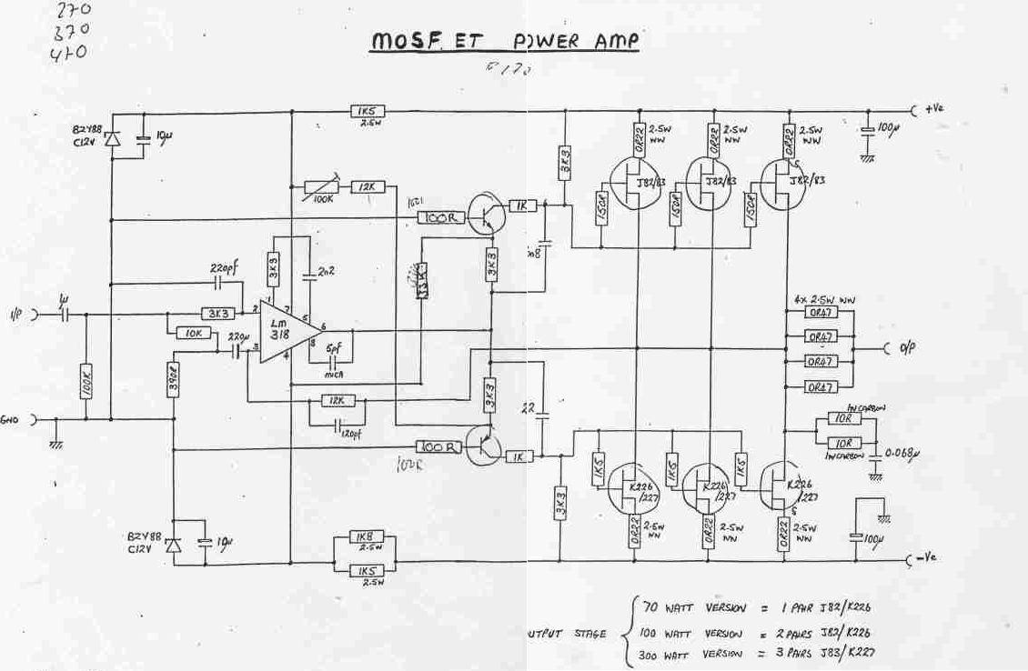

For the simplicity of the design, this amp sounds amazingly good. You can modify or complicate it with additional circuitry, as Mauro himself has done, and perhaps get even better sound.

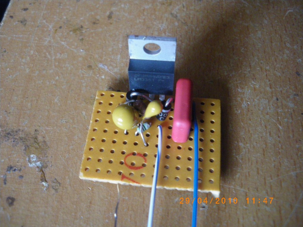

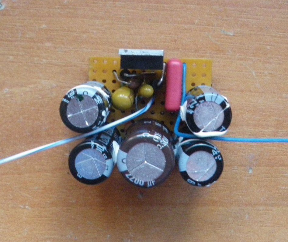

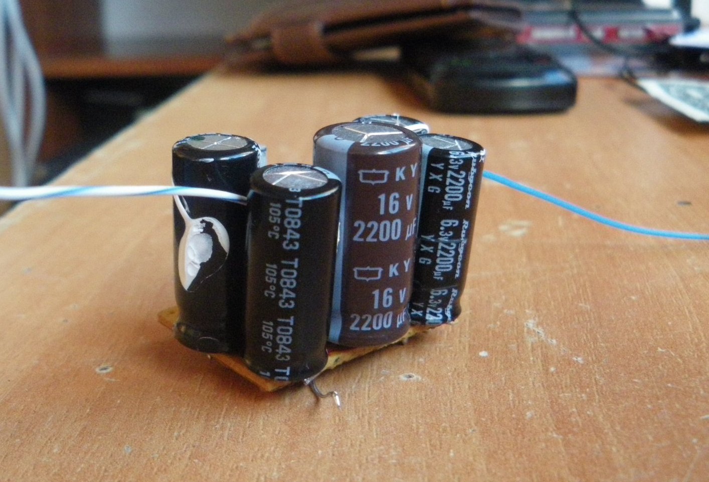

Well, I have just filled with capacitors the remaining little free space of my Lightspeed regulator for MyRef_C. It has mixture of 4 2200uF 6.3v Nichicon and Rubycon, and a 2200uF 16v Chemi-con. They were scavenged from a computer PSU. Adding a total of 11.000uF capacitance at the regulator output.
We'll see if that's enough. I have attached a picture before the caps.
