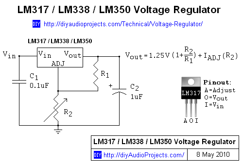

I just stumbled onto something double checking the PSU for the Lightspeed Attenuator
LM317 / LM338 / LM350 Voltage and Current Regulator Calculators
On this page is a calculator for the LM317 / LM338 / LM350 family of three terminal adjustable regulators
The Lightspeed Attenuator PSU we need to build (unless I am mistaken) ,
is a voltage regulator and the diagram states C1 0.1uF but the Ver1.1 diagram has C1 as 1uF. is this a typo?

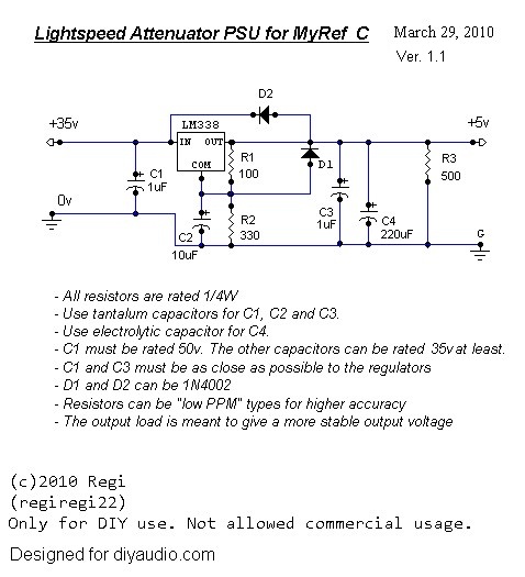

Regi schematic shows Tantalum for all 3 capacitors. 1uF tant should work in the locations shown.
But there has been discussion in this thread and in many others of the failure reputation of tantalum.
In general the advise seems to be don't use them. At worst the advice I've seen is back through all your old builds and remove all Tantalum.
If you choose to not use Tantalum then follow the Manufacturer's advice for the decoupling caps.
BTW.
For 5V from a 317:
a pair of LEDS totaling 3.7V to 3.8V substituted for R2 will give near enough the right voltage and will allow the 317 to perform better.

That's the same website calculator I used for designing it.I just stumbled onto something double checking the PSU for the Lightspeed Attenuator

Input and output bypass cap value doesn't matter at all, assuming you use something around 0,1uF, 1uF... I used what the manufacturer datasheet sais. Doesn't really matter exact value. The manufacturer recommends Tantalums despite their fail-close failure fact. Knowing that, I would go with film caps, polyester ones.
Andrew, if you have a look at the documentation compilation, inside the LDR regulator folder, there is an alternative regulator schematic designed by Salas which uses LEDs for the voltage reference.

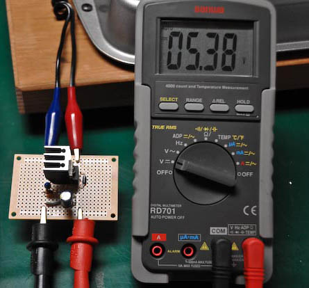

Here's my first version of the regulator built as per Regiregi's 1.1 schematic.
Seems to do the job pretty well... my benchtop DC voltage source only goes up to 32V but the regulator gives a steady 5.38~5.39 volts output between about 10 and 32 volts. I'll show the 'dark side of the board' once I have corected my silly mistakes and added suitable capacitance.
Don't hold your breath though, I am just a stupid flute maker with a soldering iron!
Many thanks to Regi for answering my daft questions without passing judgement!
Bill

If you look at the schematic, it already has all the BOM inside it.Is their a BOM for this alternate shunt regualator?
You only need 1x LM317, 1x 1N4007 diode, 6x standard LEDs and 1x22Ohm resistor (which I think is an standard 1/4W, but someone may correct me).
It is a shunt regulator set at 40mA, which means that it will ALWAYS consume constantly 40mA. It will supply a max. current of 40mA. That means that all the current from that that the lightspeed is not consuming, will be dropped by the regulator.
It is set to 40mA because that is the totally maximum consumption of a lightspeed.

Nice building, Bill. As long as you keep input voltage 2v over output voltage, you should be fine and stable. The higher the input voltage (while keeping the same output voltage), the more tolerant the PSU will be with input voltage variations.
I will explain myself: With an output of 5v, if you have an unstable input of 10v, which momentarily drops to 7v, the regulator will keep feeding 5v stable. If you were supplying it with 7v and hace a line drop of 3v, your regulator won't work for that time.
The bad side is that as you go up with voltage, you get more hot from the regulator.
Did you finally placed a 330Ohm load resistor? We will see how much big the heatsink needs to be when we have all mounted and connected...
