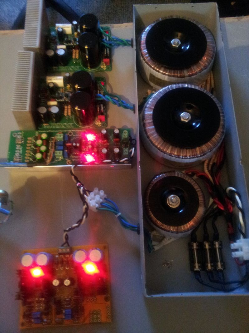

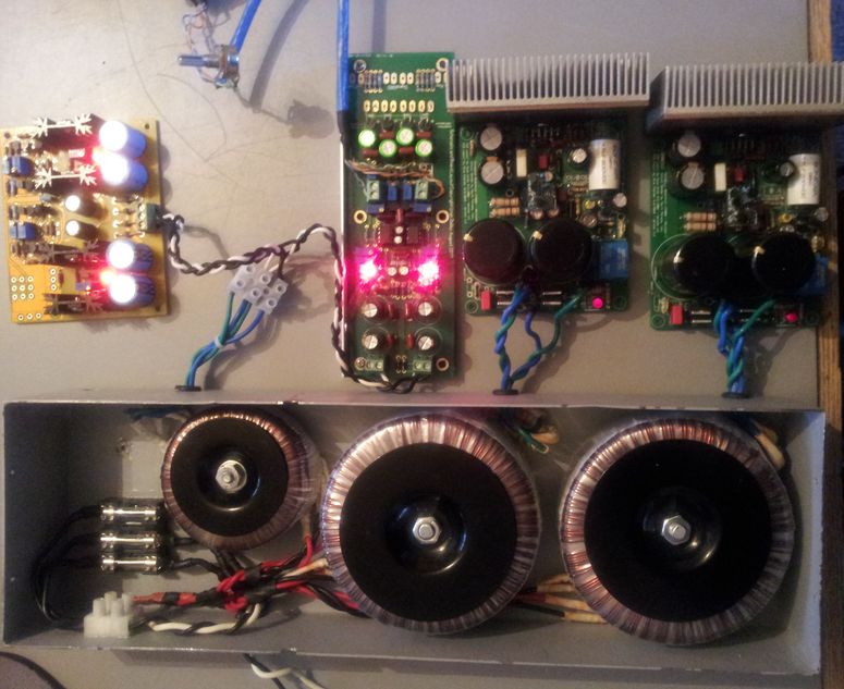

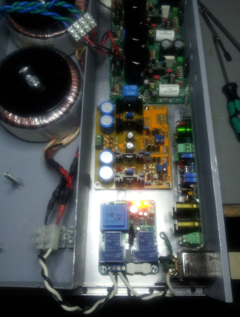

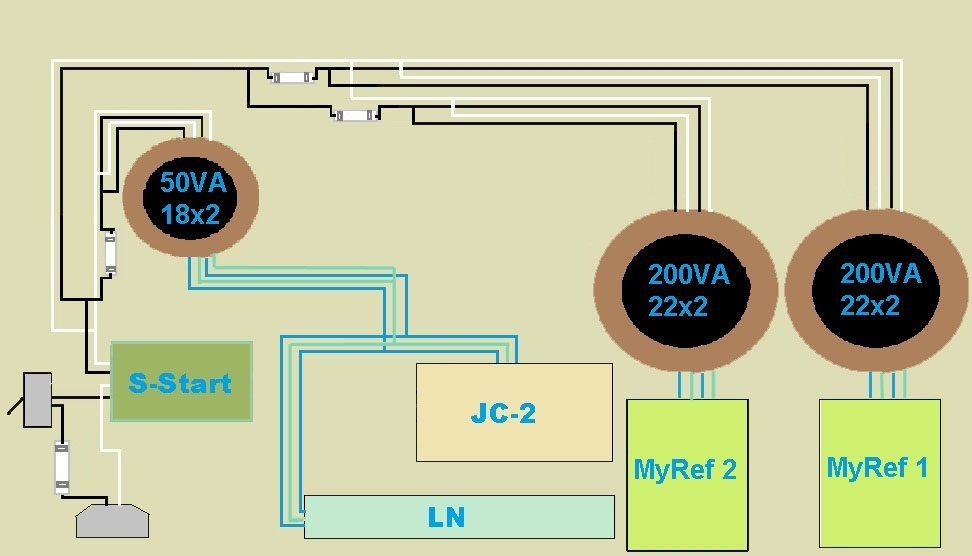

The soft-start is working beautifully. Power present and active leds as well as MyRef lights all on. Woopeee!
Next I will test powering both the Lighter Note and the JC-2 from the 18V toroid. Might even be able to eliminate a transformer rather than adding one. I'll still isolate all the toroids with fuses but may not need the additional relays. ?????
Hi Andrew,

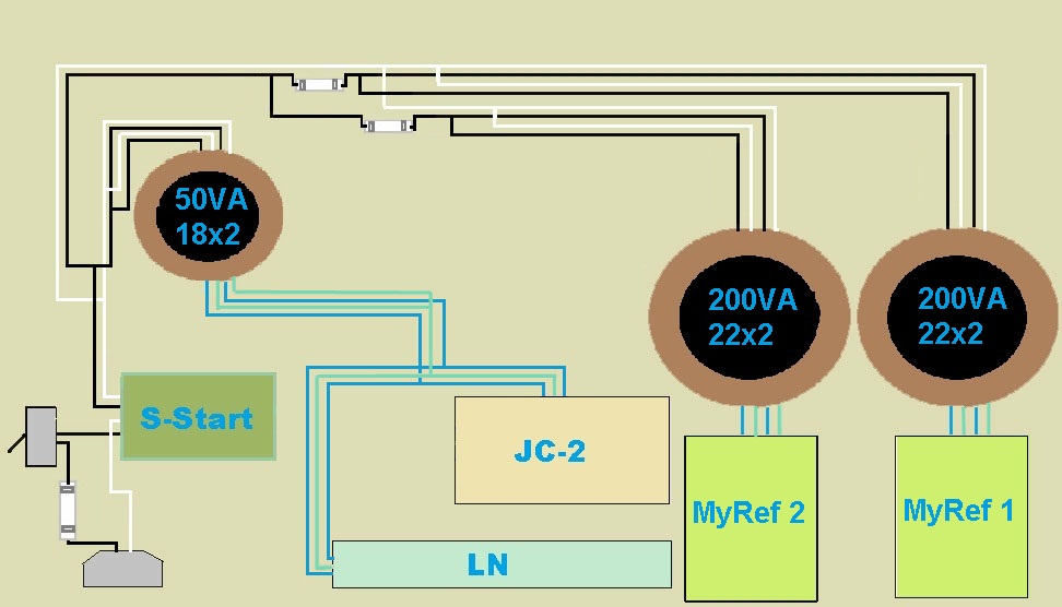

Fuse added. Do you agree no additional timing elements need to be added? I want to incorporate as few components as possible but don't want to omit anything essential.
Also, with the SS mounted outside the shield, its transformer is close to the JC-2. It can be located inside the can if that is recommended to avoid interference. Manufacturer (BingZi) docs just say fully encapsulated but no mention of shielding.
As long as the limiting resistors in your softstart can handle the initial surge of your two large toroids and the relay contacts in your softstart can handle the "steady on" current for those toroids, you're "good to go". .....Should not be any problems......
One possible failure mode (and I'll admit, I haven't had time to study your schematics.....): If the softstart fuse pops, and your softstart does not operate, will this place the limiting resistors in series with their toroids until you turn power off to the unit? If so, they may overheat...... This is probably a pretty remote failure mode--if it is, in fact, what your schematic shows.
Great, I think it's all here except a couple fuse holders to get from Radio Shack. I'll be putting it all together in the next couple days. The assistance and information has been nothing less than fantastic and I express my gratitude to all.
As Arnold would say - I'll be back

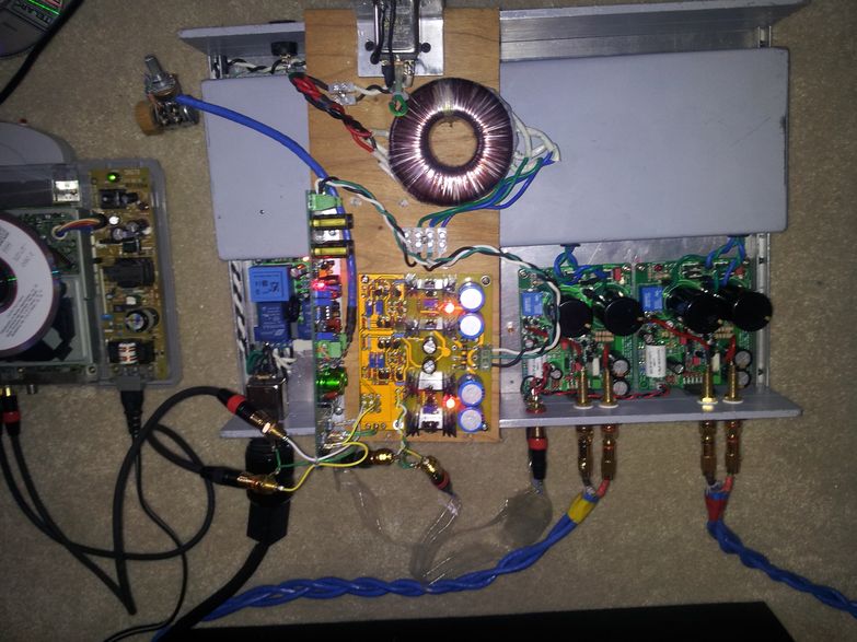

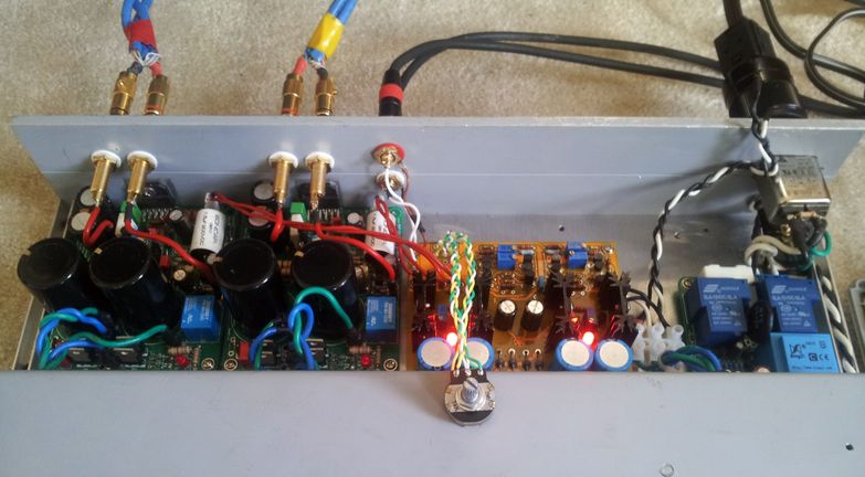

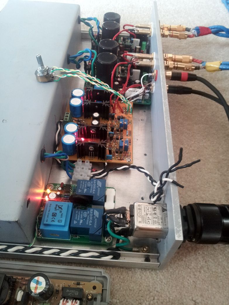

Had everything connected in the chassis but found the small toroid was overheating. The only thing found were a couple loose solder joints on the MyRef AC input tabs. Don't know if that was part of the problem.
Went back to modular approach (adding one component at a time) and everything is now stable at just above room temps.
I also had the power switch on the hot wire after the soft-start (with pin 1 & 2 on J2 jumpered) which kept the SS always on. I am revising to use the switch to activate the SS from J2 and that will leave it in standby with only the "power present" LED lit. My Denon receiver has two power switches - main and user - but I don't think that will be necessary here.
Up and sounding fine - kind -of.

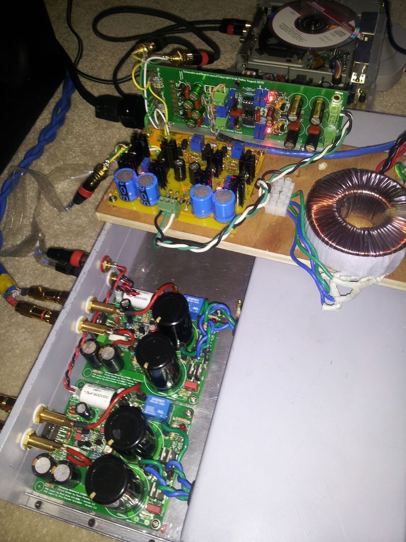

The AC wiring is functional and stable. The sound is clear, clean with not a trace of hum. Somewhere in my maneuvers I messed up the Lighter Note to where I cannot get one of the proper calibration readings. I suspect that will be solved easily by replacing one or a pair of the LDRs in the left channel. Uriah will let me know.

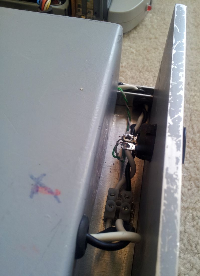

As I said earlier, the front panel switch now activates the soft-start through the J2 block via the small cat-6 white and green wires. That allows the mains power to be available just up to the in of the SS til J2 is shorted.
The power leads for the LN are still in place.

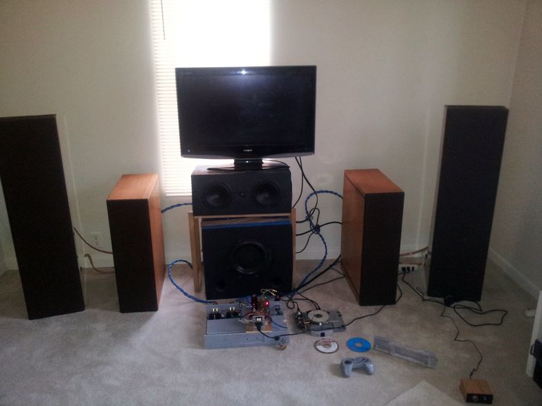

Hi All !

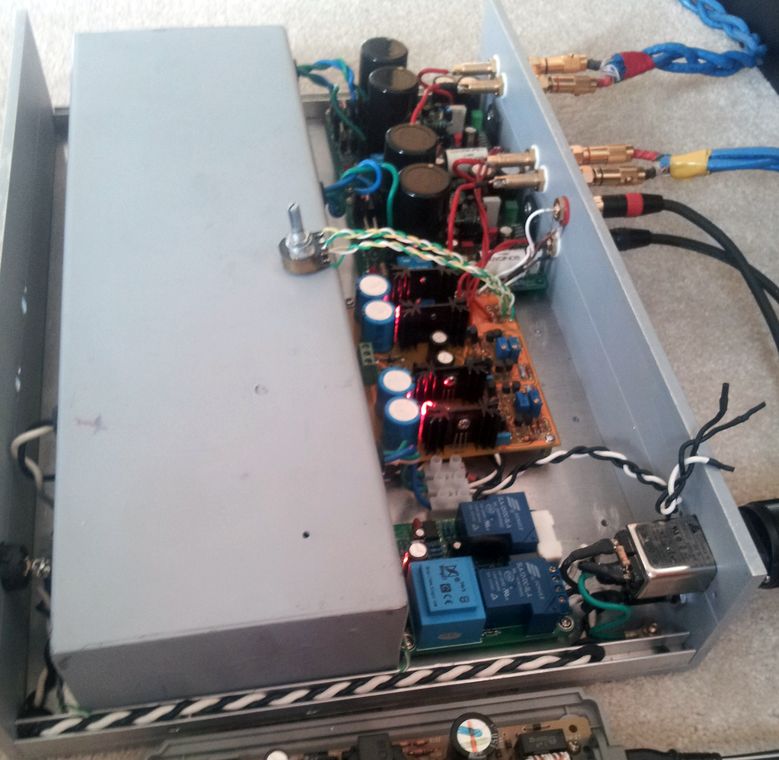

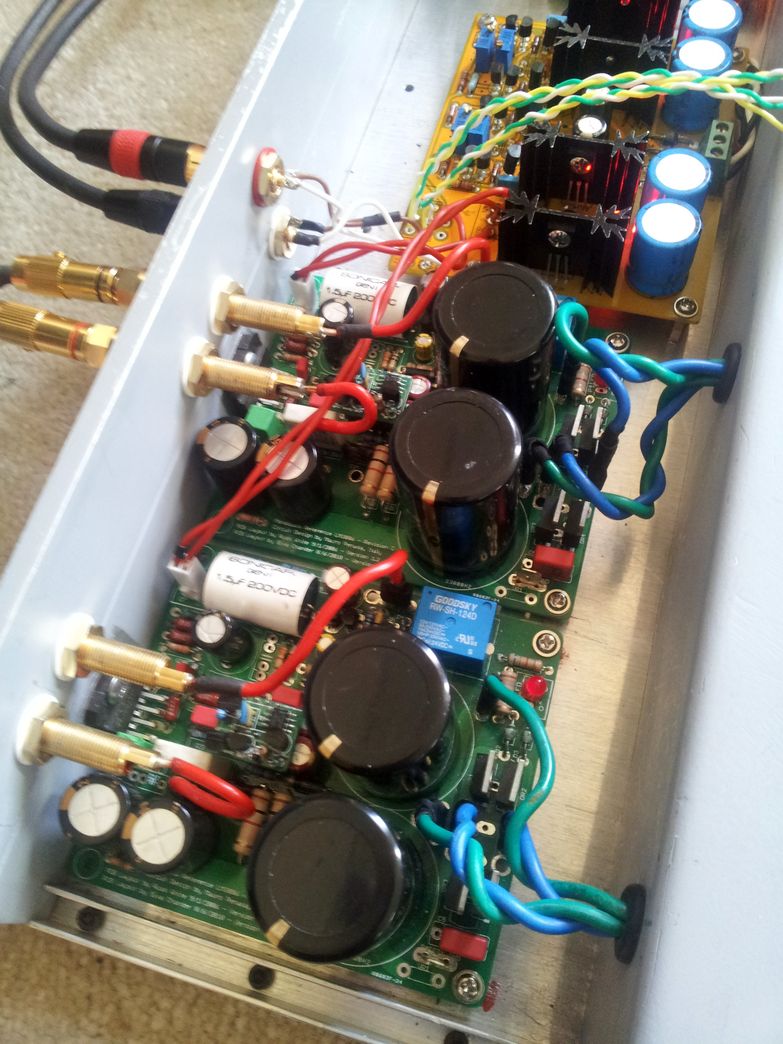

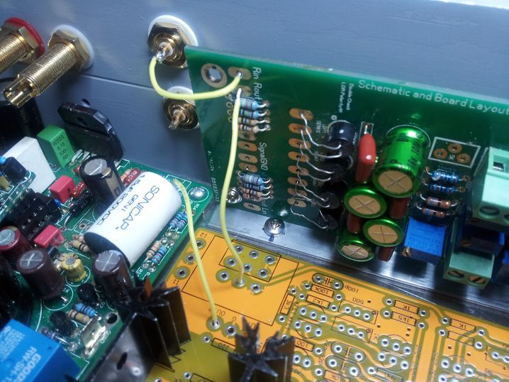

Well after a long delay, the pieces of this project have finally come together. Calibrating the LighterNote took longer than I had hoped due to the fact that I apparently fried two of the LDRs on the board. Problems continued till I took the time to re-heat a bunch of points and install gold posts on the LN in/out terminals. Everything finally fell in place.
The results? Nothing less than glorious. The absolute clarity of the LighterNote pushes the JC-2 pre to feed the MyRefs to a quality of sound I have never experienced in my home. Period.
In the photo you can see my fifteen year old DIY reference speakers (Vifa and Peerless drivers - Leap custom X-over) flanked by the newer Sunflowers. The room is twelve feet wide and the SFs sit a foot and a half from the side walls. When playing the system through the inner speakers, instruments appear clear and distinct outside the Sunflowers. The dept of stage is more than I had hoped to achieve.

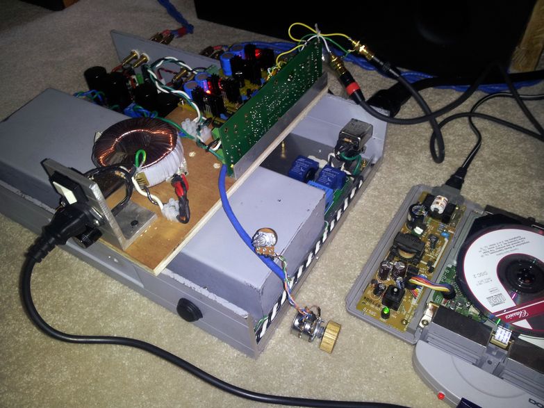

I intend to hard wire all internal leads eventually, but added a variety of posts and terminals and built a separate module to be able to do some "wire sound" testing. Currently there are about five flavors in the arsenal ranging from single strand solid 30ga silver through a couple boutique copper types.
This photo shows the volume and balance pots attached to the LN with cat-6 cable.
Here (bottom of pic) you can see the single strand silver wire in an interconnect experiment.

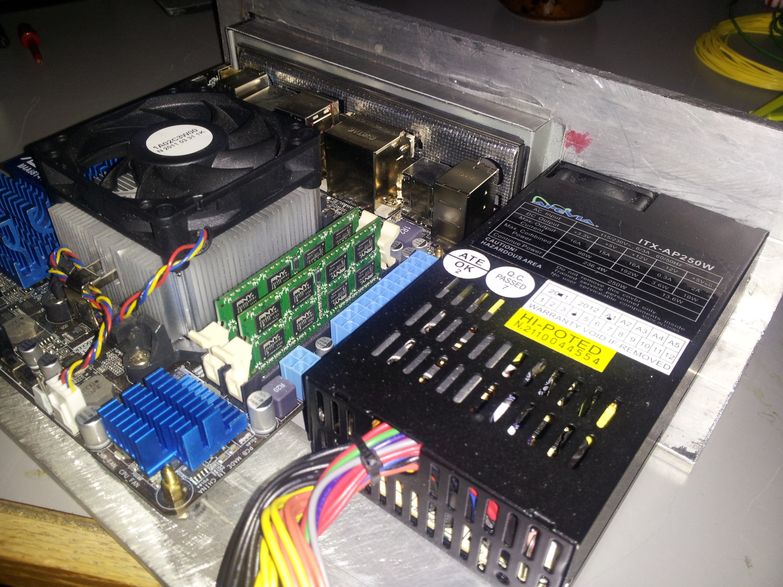

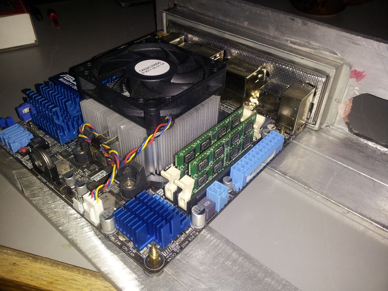

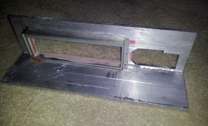

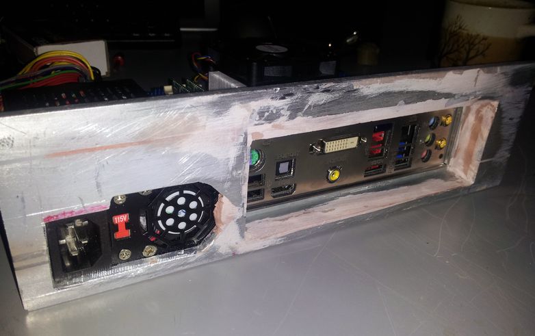

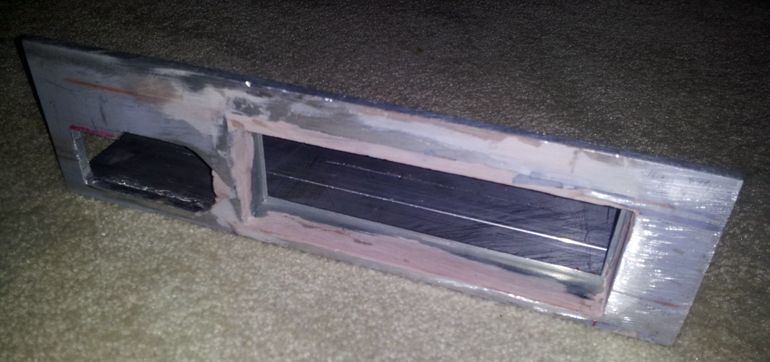

Fabrication of the matching chassis for the media center computer has started. (love those flac files) There will be at least two shielded modules - one for the MB/PS/Hard drive and a second for a DAC fed directly from the motherboard via S/PDIF. ....Water cooling -???
Yes, That is BONDO
The integrated amp should be completed by the end of next week.

Gee, it looks like the wire from the PCBs to the speaker terminals and RCAs is less than an inch long. Good design !to be able to do some "wire sound" testing
What kind of disk player is that ?
squalor,
Thanks, I'm trying to keep all signal wires at a minimum. That's on of the benifits of using the LighterNote as the signal does not go through the volume and balance pots. Those pots use a small current to adjust the resistance of the LDRs on the board and eliminate mechanical contact (the wiper) in the signal path. When completed 90% of the signal wires will be 2 inches or less.
