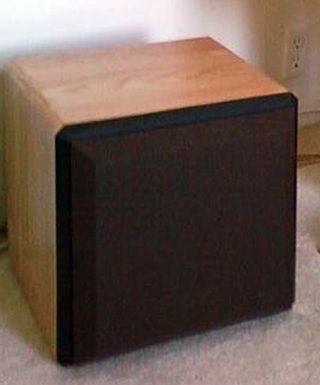

I know we might be talking in two different directions (Sub vs. Bi-Amp), but there is an alternative to the traditional big box sub. I used this massive magnet driver to build a Sunfire Clone. It is tight, powerful and goes deep combined with this Bash Amp. It's currently in a BR enclosure - again designed by Paul C - and is part of the Denon HT 7.1 system. I'd be very interested in adding the Sunfire type box to an FE based setup even if it required some kind of piggybacking with an additional FE.
It all gets somewhat complicated, and we are talking about a relatively small and infrequently needed enhancement to the FE presentation, but I'm wondering if a new separate thread for speaker integration - including XO work - with the FEs might be in order.
What say the masses???? :judge:

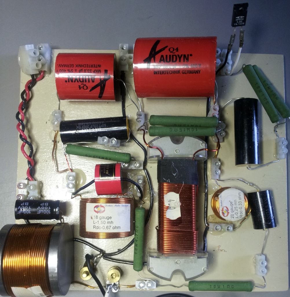

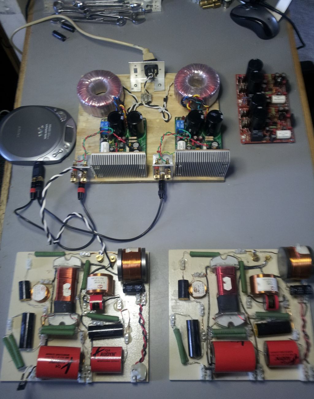

Not much interest in a FE/Speaker/XO thread so I'll just post a couple quick pics of the rig for my tweaking. I placed a ridiculous number of terminals so every component could be swapped for comparison. The parts shown are not the base XO where tests will start, but were used for spacing purposes needed for the largest items. The Obbligatos and "K"s Jac sent are enormous.😱 R=Bass, Cntr=Mids, L=Tweets
I'll report back on progress in a few weeks.😉
(Upper right - pair of Russ White V 1.2 amps to be included in tests)

Bob,
No lack of interest, but this is an old thread where few are watching and slightly side topic seems like fair game, as long as Dario doesn't mind.
By the way, I missed typed in my crossover discussion. I am using Caddock MP930, just like you, not the MK132 earlier stated. I went ahead and put a heatsink on mine because I had them laying around, but I suspect that I don't need the heatsink at all. As you put your MP930's in with your crossover, please report if they get warm enough to worry about.
By the way, isn't it the Audyn Plus at 22 uF that was the very largest cap?

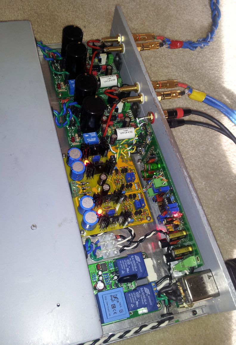

This is kind of an old story/debate I have with myself, but as someone who currently uses PC/digital as a source 95% of the time, I have a direct link between the DAC and the power amp. There is a very small compromise using the PC drivers for volume control but it's acceptable for non critical listening. (plus it allows complete system function control from my phone 😀). The volume is always up a little and signals when the rather long PC boot sequence is finished.
One of my major spring projects is to resurrect the vinyl playback system which will require putting a discrete device back in the chain. I suspect it will be the JC-2 Pre with the LN as it's volume controller. That worked out quite well in the integrated build from a couple years ago.
