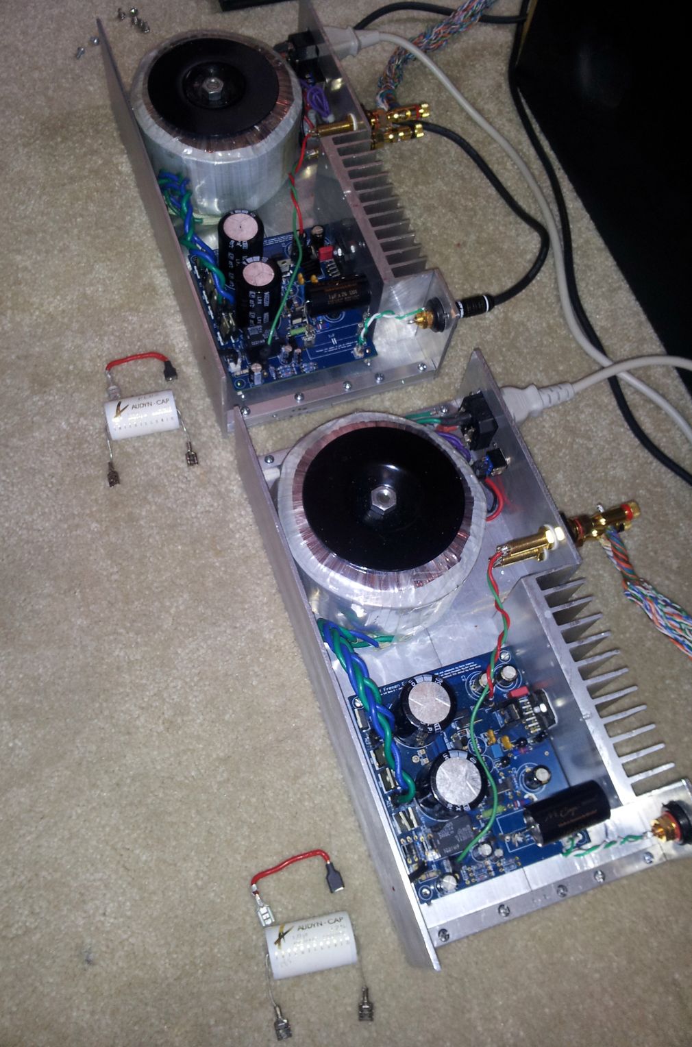

Got the Supreme caps yesterday so the auditions begin. 🙄
My first impressions:
DCC is the cleanest, most musical and robust.
Supreme is close but a little less depth and color.
Audyn Plus sounds the most "filtered" and a tad less color/body. Still sounds accurate and detailed, but somewhat flat compared to the other two.
This doesn't mean a heck of a lot as the Supremes have zero burn-in time and no Isotek passes. Should have a better impression by the weekend. But it's nice to get started.
The True Coppers should be back shortly.

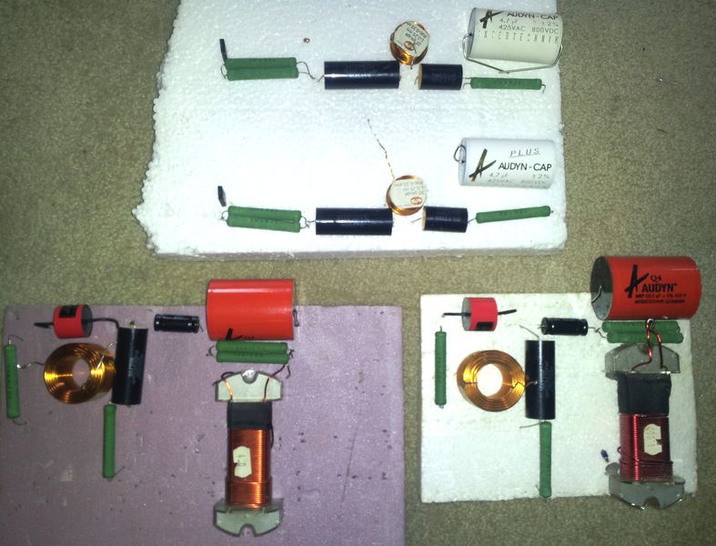

I'm waiting for the mailman to drop off a pair of 33 uF caps so I can finish the new Sunflower crossovers. I'm doing a modular approach with Euro screw terminals so I can switch components and review as I go. Top - tweeter sets, Bottom - Mids. The new 33 uFs replace the electos just to the left of the big red Audyns. The bass stays the same and will be mounted inside the cabinets prior to the testing. Started this almost a year ago but this should be the weekend.😎
Now for the Supremes - Don't have the TCs but after two passes of the burn-in tracks and about an hour of play, the sound spun me around and sat my behind down on the couch - with a great big grin.😀😀. The stage is absolutely enourmous, the bass sounds like a sub is running and the depth within instruments and seperation between them is remarkable. My speakers are ~ 7.5 feet apart and I'm consistently hearing things nearly a foot outside that space on either side.
Haven't had time to go back to direct coupling because I'm really enjoying the music - again. As I said, it's been a long time since I heard the TCs, but I can tell it will be a close competition. From memory I suspect the Supremes sound somewhat fuller/more colorful in the mids, and maybe a touch smoother on top. Don't know yet.

Looks like you are going to have fun.
I look forward to your feedback on the Mundorf resistors. One of the biggest changes in my crossover was moving from an unknown metal oxide resistor to Caddock MK132s in the signal path of the tweeter. The Caddocks are a lot cleaner, but I have lost some of the top end sparkle. Make sure to evaluate the resistors separately from the caps and coils.
Also, check for a PM.
Top - tweeter sets
Those Audyn Plus should be Mundorf Supreme... I've had Plus on my center channel tweeter, when I swapped with Supreme I've had a not small improvement...
BTW you could try to bypass them with 10nF FKP2 100V or even better NOS axial ERO KP1832 (circa 10nf-20nf), you can find them from umut1001 and other vendors on eBay.
Those EROs are great to bypass lesser caps, also the ones in parallel to speakers (must be tried case by case), had great results in parallel on my midrange.

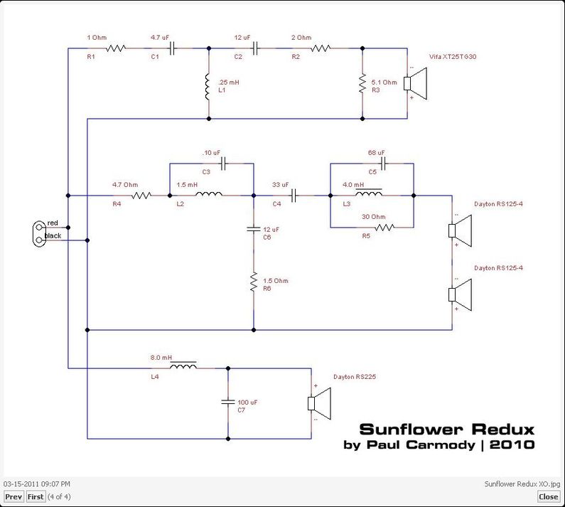

Just answered a PM from Jac saying the big red caps might be an overshoot on the mids also. He is sending some things to try, so once I get the test rig built I'll add some Supremes in the tweeter mix. Probably in a couple weeks. Thanks :up:
Way off topic - but this is what I'm working with. If anyone wants to comment a PM would probably be best.
Q4 caps are not bad, good in parallel to woofer, could be fine in parallel to midrange but they will probably benefit from a good film/foil bypass like the EROs.
I would not use them in series,though.
Fine, I am looking forward to your results. 🙂
I suspect that Dario is very correct here. Definitely try a bypass on the mid and woofer caps. In my limited experience, it can really help, but then sometimes it doesn't work too.
That is really an interesting notch filter that Paul put in series with the mids. A quick simulation shows that is 13.5 dB notch at 300 Hz. It is -6 dB from about 200 to 400 Hz. It looks like playing with the value of the 68 uF should be interesting. If I were you, I might try building the crossover without the 68 uF, 4 mH, 30 Ohm filter completely and see how you like it.
And, as always, have fun.
