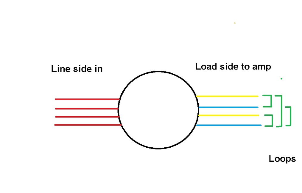

Dario is asking about the label on your transformer because it usually has a diagram of the loops on both the in and out sides of the toroid. They need to be positioned relative to "hot" and "return" on the FE.

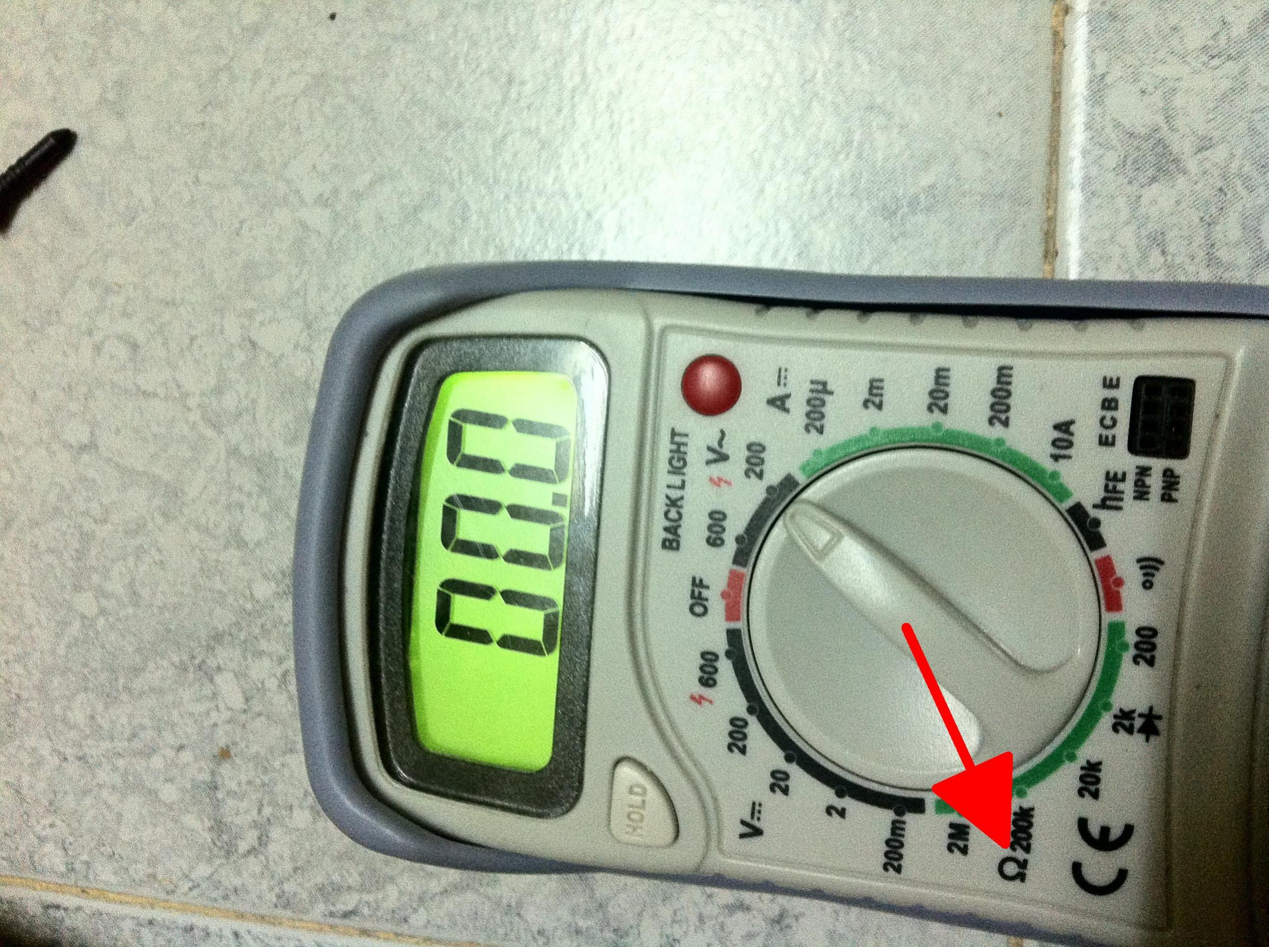

If you don't have a label you can use the continuity mode (see red arrow) of your VOM to sniff out which pair of wires form a loop inside the transformer. This is done with no power (AC) applied.
The attached PDF gives some examples of the loops/circuits you need to determine.
The drawing shows what I think is your trani. Green shows possible loops that need to be determined.
For safety, please remove the toroid from your build while doing these tests. After the information is gathered, power can be applied to determined the output of each toroid.
These are steps we all had to do/learn so please don't feel this is something you should already know. If there is anything you don't know please ask. We all learn together.

There is a continuity mode with audible beep on your your meter. Green arrow. Using that is a simpler/preferred method. Sorry, a little dense yesterday.
Thanks bcmbob. I did as you mentioned. New learning. The problem is connectivity issue. Now its solved.

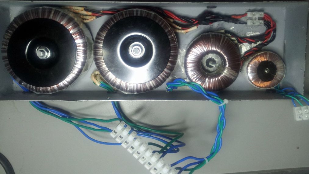

Your welcome. That sounds like there is still a voltage problem. Are you sure the wiring from both toroids is identical. It is easy to reverse something when all the leads are the same color. I sometimes use a small piece of heatshrink tube or a magic marker to designate "hot". I have made that mistake a couple times. Reversing the red wires on the input side of the non-working assembly toroid might also be an option.
The FE power system is a little tricky and sensitive to the relation of hot and ground on both sides of the transformer from my understanding. It was dealt with a bit on this post, but if you can, please post a simple diagram of the loops/circuits on your toroids. It will be easier to determine. Dario can decipher what's best for the FE if he can see what is there.
I meant reversing only the input side wires, not the leads from toroid to amp. I had a similar problem connecting multiple toroids in an integrated build. Take a look backwards to where both transformers branch from a common feed. Hope that makes sense to you.
Here is an example. These toroids have both red and black in wires. Easy to tell apart. Yours appear to be all red and can be in the wrong place. I don't know if that is your problem. but the function/polarity of the leads need to be consistent. In the photo all red is to red - all black is to black.
