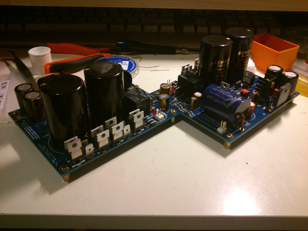

I'm in Milan, 1:51AM here... just finished both monoblocks, I'm actually listening them... 😉

You are out of control. They look fantastic.
Maybe... 😀
No sockets?
Not this time...
This build is a bit different... Blackgate STD in C1, C2 and, temporarily, FKP2 in C7 and Amtrans in C32.
Tomorrow I'll mount the usual polystirenes.
Now it's time to go to bed... goodnight 😉
Dario.
I'm really interested what you learn with this. The STD are rated at 16V, only a small margin above the circuit voltage. I think it should be fine, but I've never been brave enough to try such a small margin.
I considered Elna RJH in the 25V version for C1, C2 before the mini GB came together.
Jac

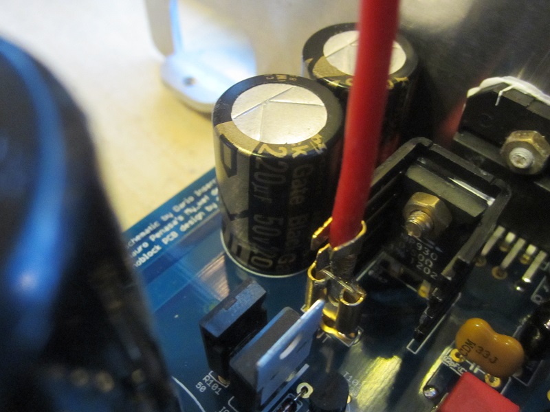

No, no, no... The BG STDs I've used are rated 220uF 50V!
You can't use 25V parts in C1, C2.
