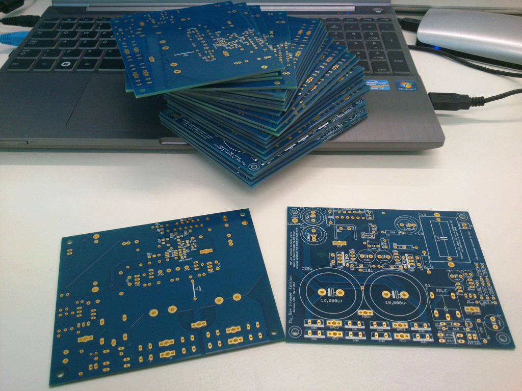

One nice pic:
Boards arrived sooner than expected... 🙂

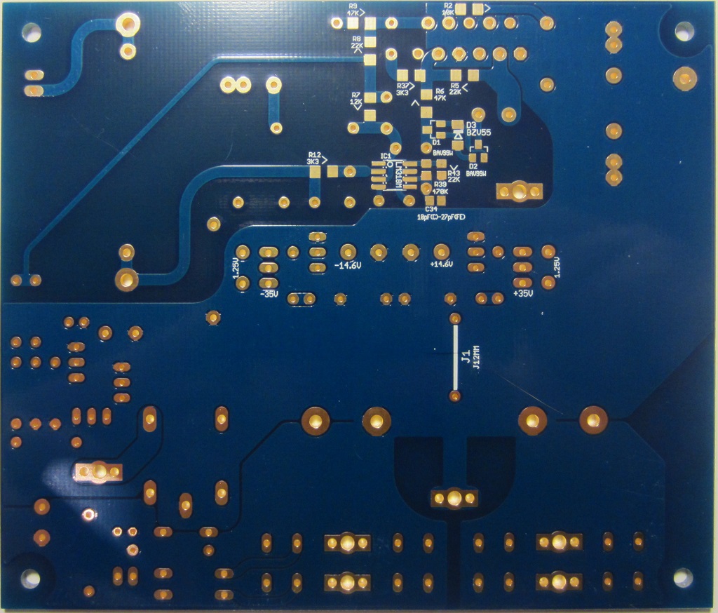

More pics
I've attached more pictures... boards are gorgeous. 🙂
Tomorrow I'll build two monoblocks as a quality check, after that I'll order parts for those that asked it.
