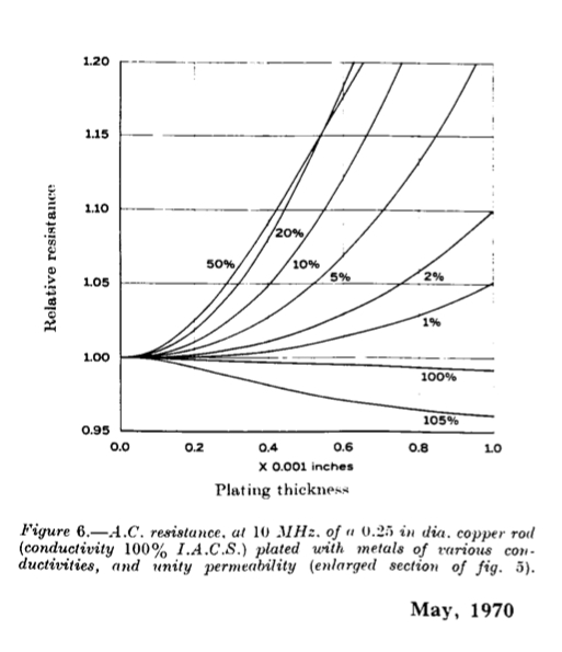

Very interesting. I have always been curious about phosphor bronze. I know that it is used for some very high quality connectors but its conductivity doesn't seem ideal.
I found this conductivity chart on a website.
http://www.diyaudio.com/forums/attachment.php?attachmentid=336921&stc=1&d=1363646764
And this graph in an old paper on plating for RF frequency conductivity.
http://www.diyaudio.com/forums/attachment.php?attachmentid=336922&stc=1&d=1363646764
It seems like the best conductivity over the AC frequency range would be a high conductivity core (like copper or silver) with a thin, low conductivity plating so that it wouldn't corrode. I am certainly missing something because phosphor bronze is definitely used in high end connectors.
Bronze is considered better sounding than brass, soundwise, fuller and sweeter.
The only direct comparison between brass and bronze I've made is with the AC IEC inlet, the bronze one sounded fuller, sweeter, more natural.
But I don't have any scientific evidence for it.

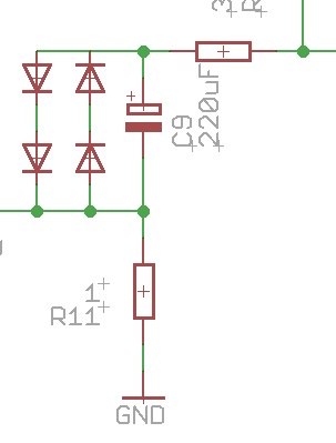

............ I wish I understood exactly what C9 does. If it only blocks DC, then how can the value ever get too big? Does using 470uF instead of 220uF make any sonic impact? If not, then why would 1000? .............
I think you will find that a very large cap will take longer to charge. It's only to a fews tens of mVdc but it is possible the cap will cause a very low frequency ripple on the output.
The speaker isolation will hide this if the FE can settle before the relay clicks over.
But that same VLF ripple could also occur if there was a quick change in input voltage.
Could someone try a 1mF in that position and report back?
Jac, what you described apply on normal working conditions but C9, in theory, can be exposed to full rail voltage (35V) in case of failure.
Inverse parallel diodes solve this over-voltage during fault conditions.
Just recently (last week) I altered an old amp to a pair of series diodes in inverse parallel for a little extra voltage before the diodes conduct and a little less leakage across the diodes.
4off 1n4148 work and they don't take up much space across the pins of the DC blocking cap.
