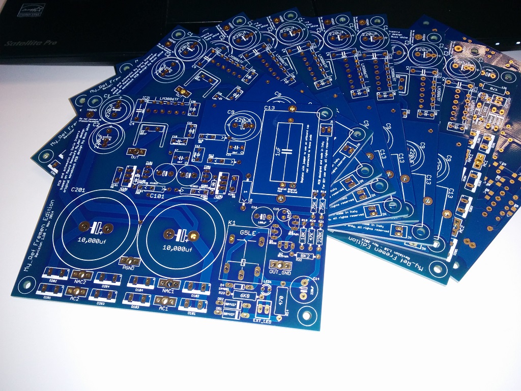

My_Ref Fremen Edition GB (fifth run)
Boards arrived
They should be packed and shipped by the end of next week.
