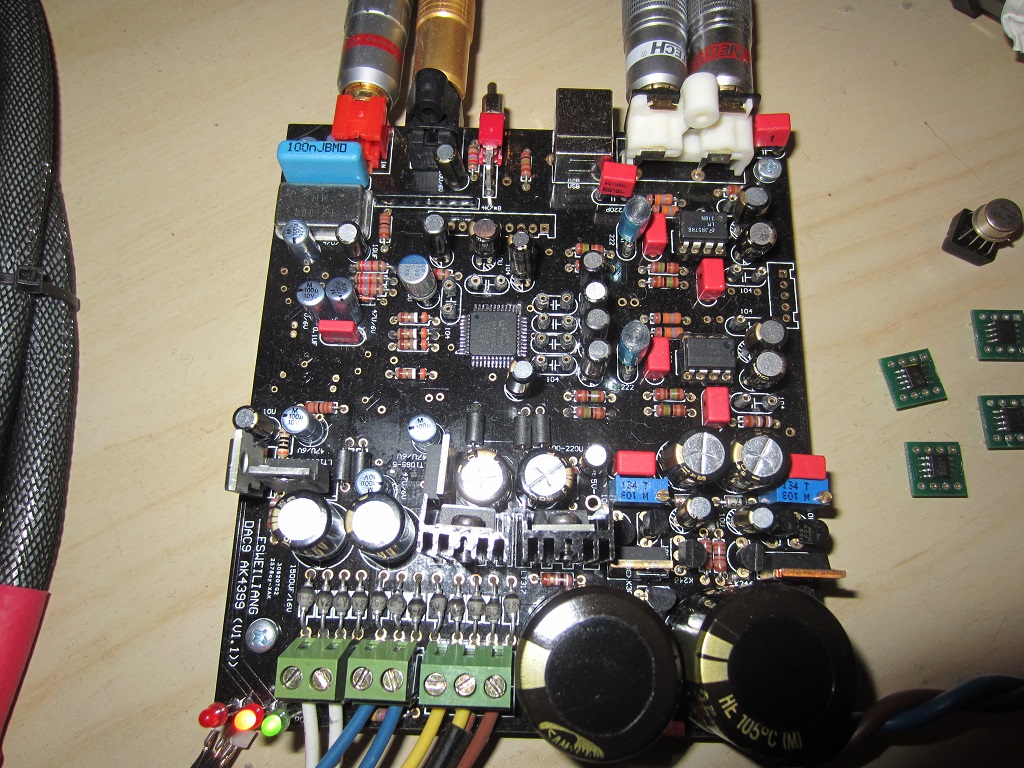

Dario what is your next project ??? :)
At the moment I'm kidding modding DAC9 by Weilang:
attachment.php
It's really good as it comes from eBay but some careful mods are needed.
The thing I love about it is the really well regulated PS (analog one is also a discrete series reg!)
