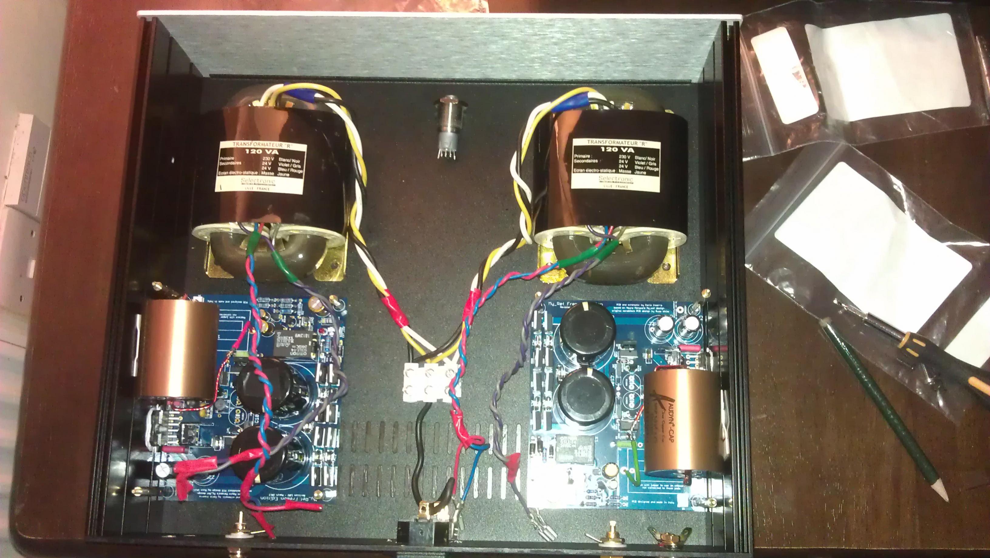

Ok, so my second channel is working fine.
Dc offset is ok and all is good.
I can say one thing for sure- it is very musical amplifier. Joy to listen.
Only one thing remain- put em all together 😀
I'm jealous

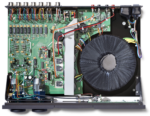

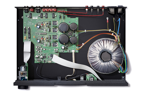

Those R-Cores look sooo appealing. From here it looks like you could turn the TCs 90 degrees and shorten the leads. No?

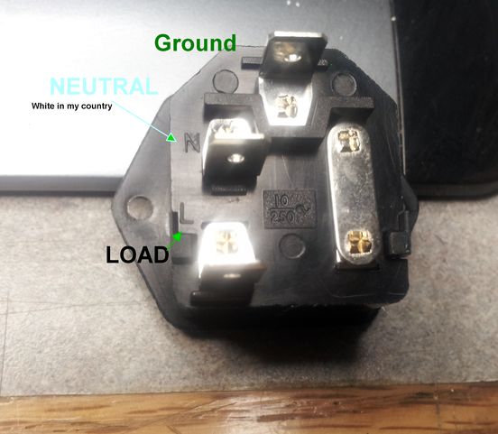

To settle my mind, I went to my electric service box to see which color wire did what. I try keep those same assignments color throughout the entire amp. If there are different colors in some components, I put a small piece of the correct color heat shrink tubing near the ends of each wire.
If using post 455 as example on iec inlet which of the poles represents which wire ?
Its usually marked on the inlet.
I ll think about turning them.
Thx Marra , found markings
Should I run long wire from switch towards inlet or I can make it shorter and connect it closer to transformers ?
Are you just switching the live?I take it the yellow wire is a screen connector and will connect to chassis ground.
