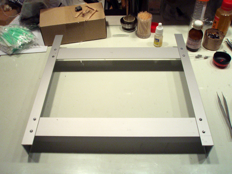

The amplifier is not assembled yet, so its early to make objective judgements. But, ofcourse I listened to it a lot in its scattered state and with cheap pots and with preliminary wiring. Computer with O-DAC was mainly used as a source. May be the O-DAC is not top of the class, but it certainly is far better than FM tuner. Music was Mozart violin and piano concertos, Terauchi electric guitar, Weber rock opera JC Superstar. First of all bass on the speakers had to be lowered (they feature regulated crossover). Because the bass is very strongly expressed. After that the sound became pleasant and detailed. It has the property of being not fatiguing on a long term. I heard these AR10pi speakers driven by a couple of my fathers Marantz amps (the 80s models, don't remember which) and lately by a LM1875 chipamp (not bad). Compared to those My_Ref FE is distinctly better. Music appears well balanced and articulated. That is, instruments are not obscured one by the other. Merely by refocusing attention one can distinguish the particular line. The challenging string instruments are very authentic. I look forward to examine the sound of egyptian horns in the Aida with this amplifier. Never heard them properly reproduced. These are my impressions for the moment. A lot more listening is planned and I will continue to share my impressions.

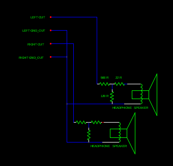

Is it permitted/acceptable to add a headphone output to My_Ref FE? Something like the one on the attached sheme. Note that the Out_Gnd lines of right and left blocks have to be joined for this. Comments highly appreciated!

Dario, thanks for valuable advice! Plans are to mount the scattered parts to an open chassis, and after that to start tuning. Regarding the bass issue, old AR speakers may be responsible for that. Large drivers had torn rubber replaced few years ago. And, the drivers being not one of the standard sizes, the repair went not without compromises. They may reproduce deep bass not very well (for instance, contrabass in Mozart's 3rd violin concerto). At the lower bass settings of crossover they work nicely with My_Ref now. Also the source may not have been perfect. I will listen for some time and try variants of C13.

I'm sorry to say that, just like Dario, I don't know the answer. I suspect that you might give up some sound quality or hum on the headphone side because you may be introducing a potential ground loop by combining the grounds. If you keep the switches and headphone components close to the audio ground from your source, it might be OK.
I don't think you would hurt the amps by trying it. Why not just try it as an experiment before building the enclosure? We would love to hear about it.

Yes, I'll do it in the coming week and report. Thank you.

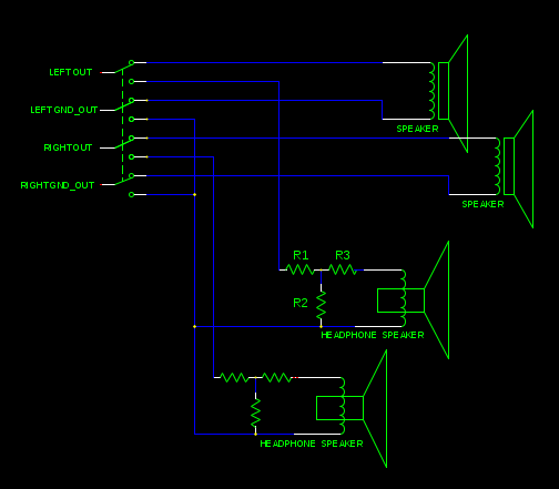

Headphones and My_Ref FE
In fact some resources can be found on use of headphones with integrated amplifiers. For instance Headphone Adaptor for Power Amplifiers . Today I made a temporary PTP adapter shown on the scheme below and connected it to replace the speakers. Sennheiser HD600 phones were plugged into the adapter. The resulting sound is great. And to my satisfaction it is very similar to the sound produced by the speakers. Also no hum or other disturbances. Still, I have to focus attention on the fact that the two blocks of the amplifier are connected only at one point, that is at the ground of the headphone jack. Hence, there are no ground loops. I am happy with successfull test and will now incorporate headphone jack into the chassis (using a 10A 4 ON-ON switch or relays).
