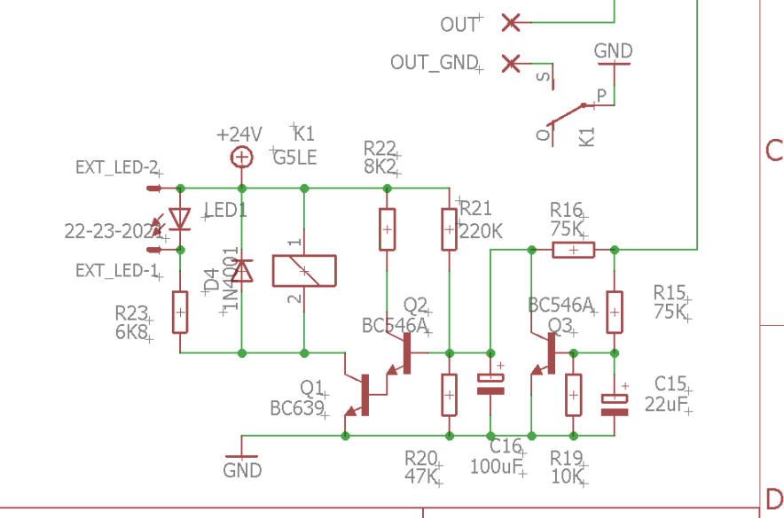

Hello Clave,
I have a couple of questions about FE, if its not a problem..
I am looking at July 2020 schematic, i assume that one is latest.
It is frankly impressive how much evaluation you did on the board for each component, and how much incremental improvements, so it is not obvious to me what can be "safely" altered..
Q1: Red LED1 can be replaced by 2.5V zener? (i dont like light sources in my room)
Q2: Pinout for coil on G5LE is 2 and 5, not 1 and 2? Wrong pinout (presumably) on schematic doesnt matter i guess since its correct in function.
Q3: BC546A safely substituted by BC550B?

A1: you can simply omit it without problems.
A2: The Eagle component has different pin numbering, don't mind about that.
A3: BC546 supports higher voltages than BC550, I would not swap them. BC546 is available from Mouser for pennies.

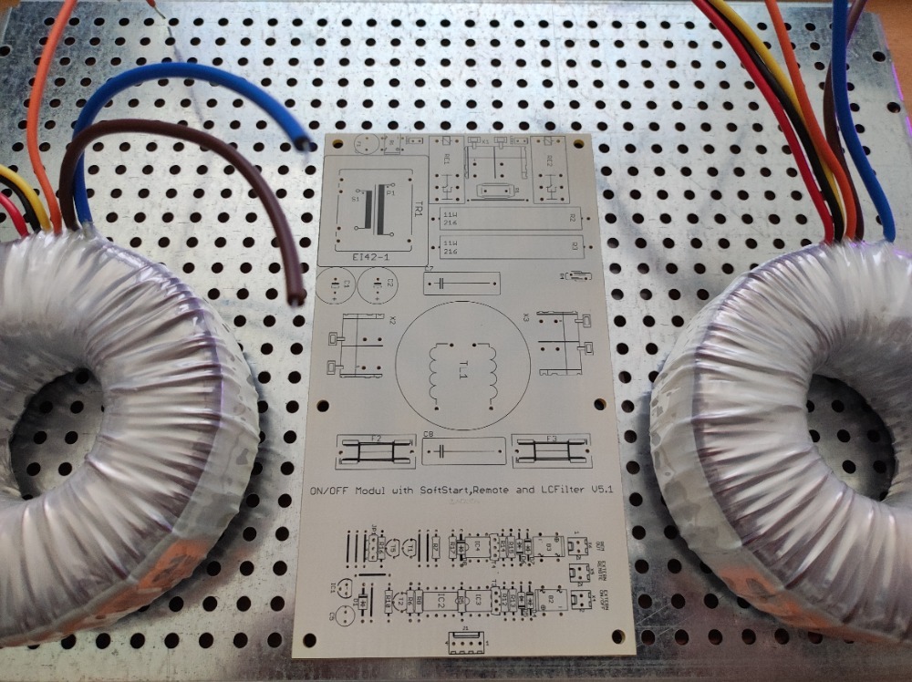

Oh, I didn't think about a LCF filter - I just have a momentary switch+softstart . Any improvement over sound or safety?The heart of my amplifier will be intelligent softstart + remote On/Off
Until the pcb on my_ref arrives, I'll start slowly building.
I plan to fit MY_REF with 15.000 or 22.000 uF main filters. What voltage should I buy these filter caps for? 40V or better for 63V? My toroidal is 2x25V.

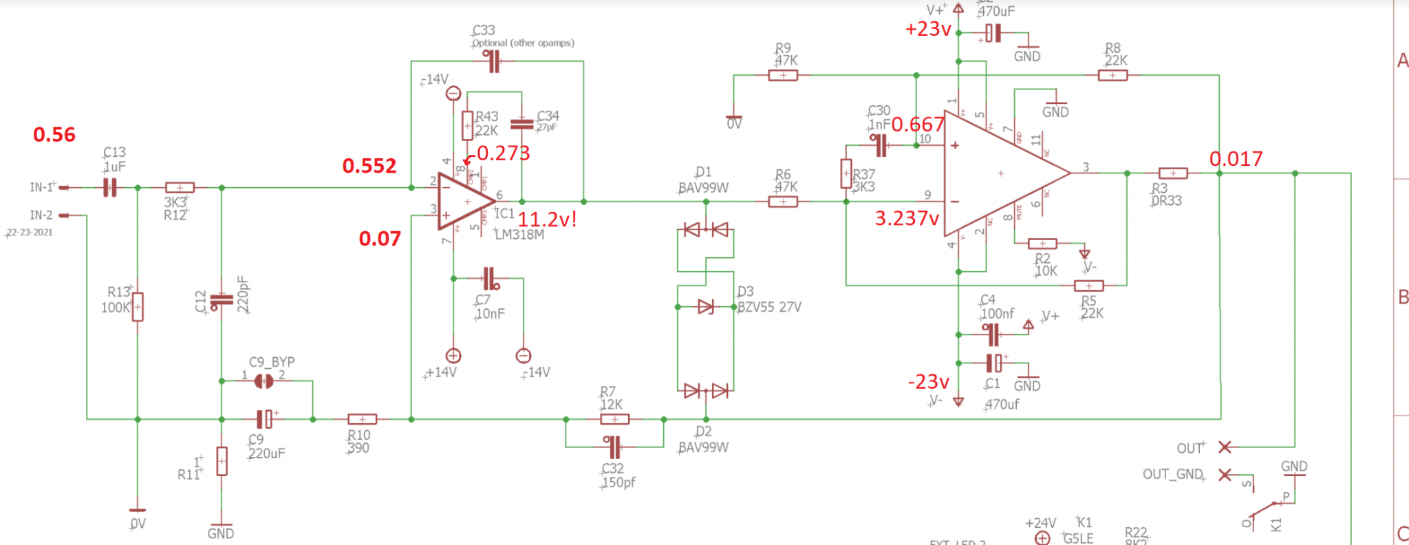

Hello gentlemen, trouble
After assembling everything, i turn it on, after 2 seconds or so solenoid activates, i see very low DC offset and think im good to go.
Voltage on opamp rails is +-15v exactly as it should be. Main power is +-23v, a bit on the low side but should technically at least function right?
So for testing i plug in a sine wave of 0.560v AC. On output i read 0.017v AC. No matter the volume of input, output always shows 0.017v.
I thought maybe because of special configuration of feedback, a load is required to show voltage on output, so i connected a 100w 4 ohm resistor simulating a speaker and nada, still the same. The LM3886 is not heating at all, about skin temperature, maybe slightly more.
So i went around the board to troubleshoot, and here are the values i recorded, all in AC
What do you think it could be? i assume 11.2v AC on output of LM318 is not normal.
It's also interesting as i vary the input voltage the output of the opamp (pin 6) is like, nothing 0v, nothing 0v, a little bit 0.5v, a little bit 1v, and then in just a few more clicks its 11.2v, so what im trying to say very non linear. Is it a sign of oscillation? Feedback network shows 0.273v on pin 8.
But also, even when i keep the input very low, and on pin 6 of opamp is like 1v or so, the output of lm3886 is still, always, 0.017v AC.
Do you have any hints perhaps what to do, or what nodes to check?

The relay subsystem seems to be working fine, all PS voltages are nominal, so it must be something in the main circuit
I think it really must be the LM318 just because of the massive and non linear output for a given input voltage (goes up very fast with small input increments, and then caps out at some value and doesnt budge). im not sure how its supposed to behave though.
When i touch it, it doesnt react at all.
i noticed with no input at all there's 0.15v ac on input terminals if the mains cord is plugged in, and 0v if i connect ground to case...
Now when nothing is plugged in, output (pin6) of lm318 is perfectly at 0.00mv. But connecting the ground to case didnt fix the problem.
I also fully replaced the LM318 for a new one, but same thing.

One interesting thing i found out!
Measuring AC of power rails, shows they're dead quiet. But then measuring after the BD140 and BD139 (opamp power rails), there's is apparently 223mV RMS of AC on the positive, according to the multimeter (but it only shows it in V mode, not in mV mode which i never understood). Negative -15v is clean.
So i put a large cap on the positive rail of the opamp, but same thing, didnt even budge a microvolt. I wonder what's causing it, oscillation of opamp?
So my theory for now is, the LM318 oscillate for unknown reasons, and then LM3886 self protects by shutting off or something? I cant explain why there's nothing on the ouput no matter what i do.

Zbunjen.. what value is the resistance R2 (the mute pin of LM3886)
your testing for me shows that the LM3886 is off, muted?
can You confirm that it's truely 10kohm? soldered good, contacts confirmed?
And of course Joseph you were right!Zbunjen.. what value is the resistance R2 (the mute pin of LM3886)
I was thinking the same thing last night, after i wrote "I cant explain why there's nothing on the ouput no matter what i do."
It was an obvious hint to myself that it must either be broken or muted, assuming the former is less likely.
What a stupid mistake, so much messing around, but it was the 10K. Plays perfect now 🙂
